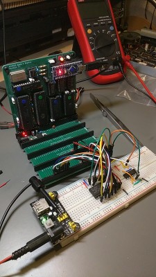

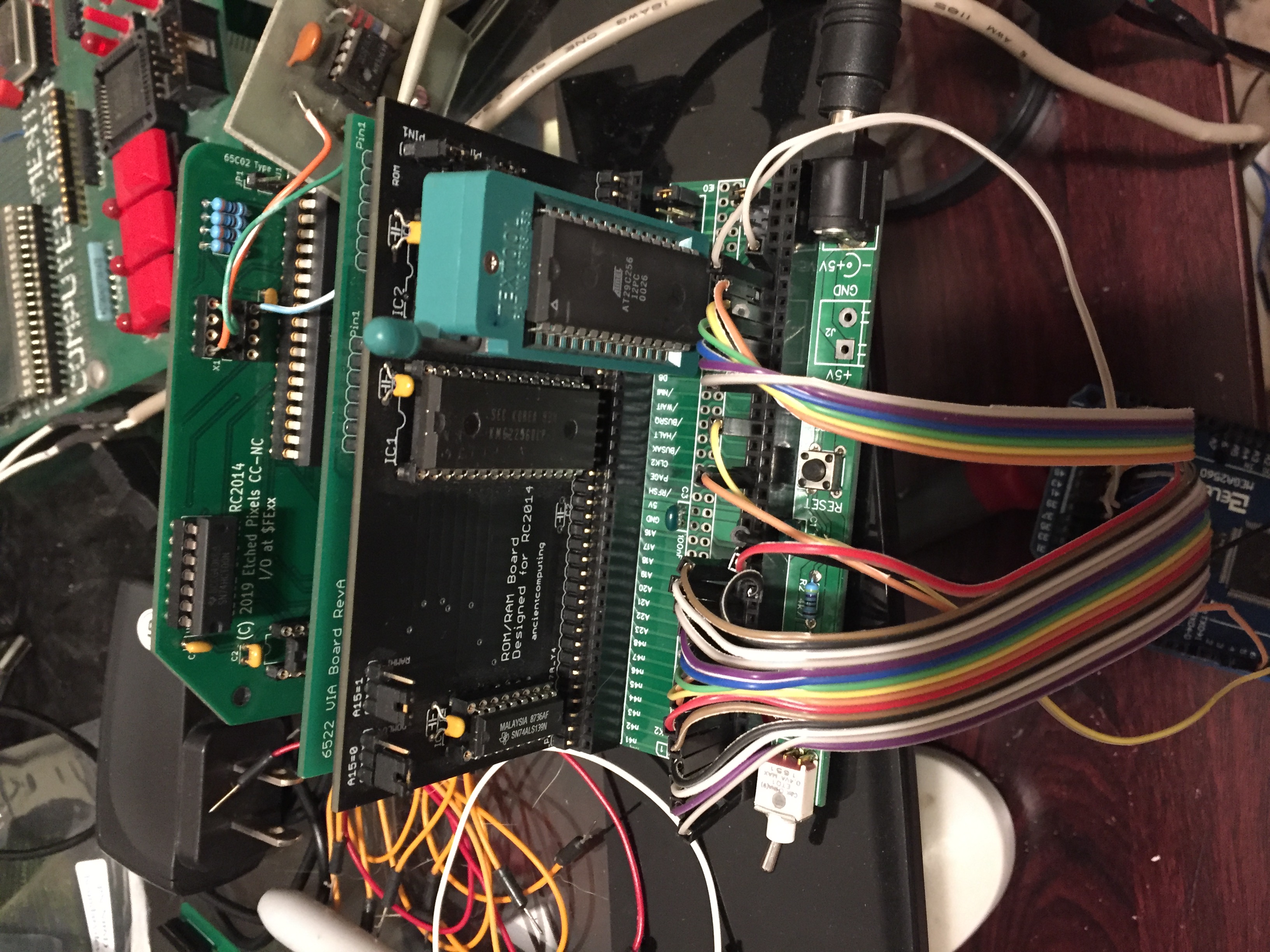

On Tindie there are a few boards made by Ancient Computing that are designed around the RC2014 bus. AC Offered a 6502, 6522, ROM/RAM and 165xx boards. The Tindie seller has not stocked boards for a long time but the order info is still there.
The 6502 board maps the R/W signal to the /RD and /WR bus pins. The IO cycles gets translated to $C0xx base so IO ports 0 to $FF is $C000 to $C0FF. So the 6502 is mapped to the Z80/Intel bus. (Possible timing issues aside)
I have a setup with the SC112 RC2014 backplane. With a WDC65C02 CPU card, AC 65C22 card and the AC 32KB RAM / 32KB ROM card setup. The CPU card is a variation of the AC 6502 CPU card created by Alan Cox (Etched Pixels). The big change is the IO base is moved to $FE00.
In the picture below is the Ben Eater Mega 2560 Arduino 6502 analyzer connected to the bus. A 60Hz clock is feeding the CPU from a color burst crystal board.

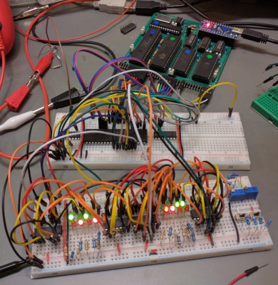

Also keep in mind that you need not use the backplane and board system for everything just because you're using it for part of the system. I needed to examine a ROM the other day, and the fastest and easiest way was to drop it into my RC6502 system with a smidgen of decoding:

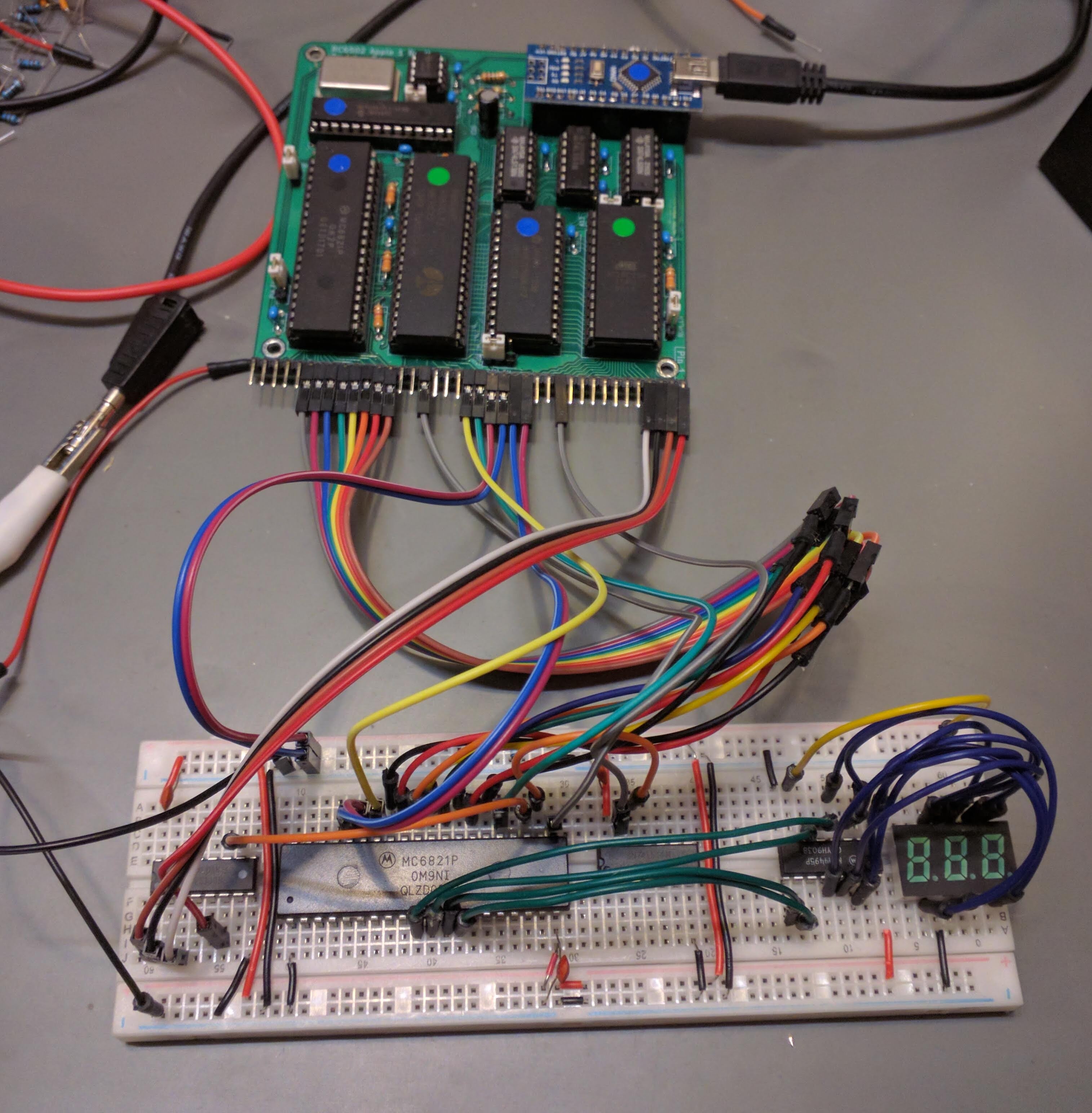

For simple expansion there's not even any need for a backplane board; you can just attach directly to the bus pins on your SBC. Here's a second 6821 PIA attached to my RC6502 SBC, along with a hex display on a few pins of one of its output ports:
I actually used that configuration to develop and test my octal logic probe, seen here on another breadboard below it:

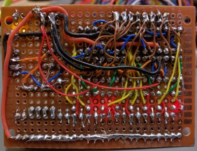

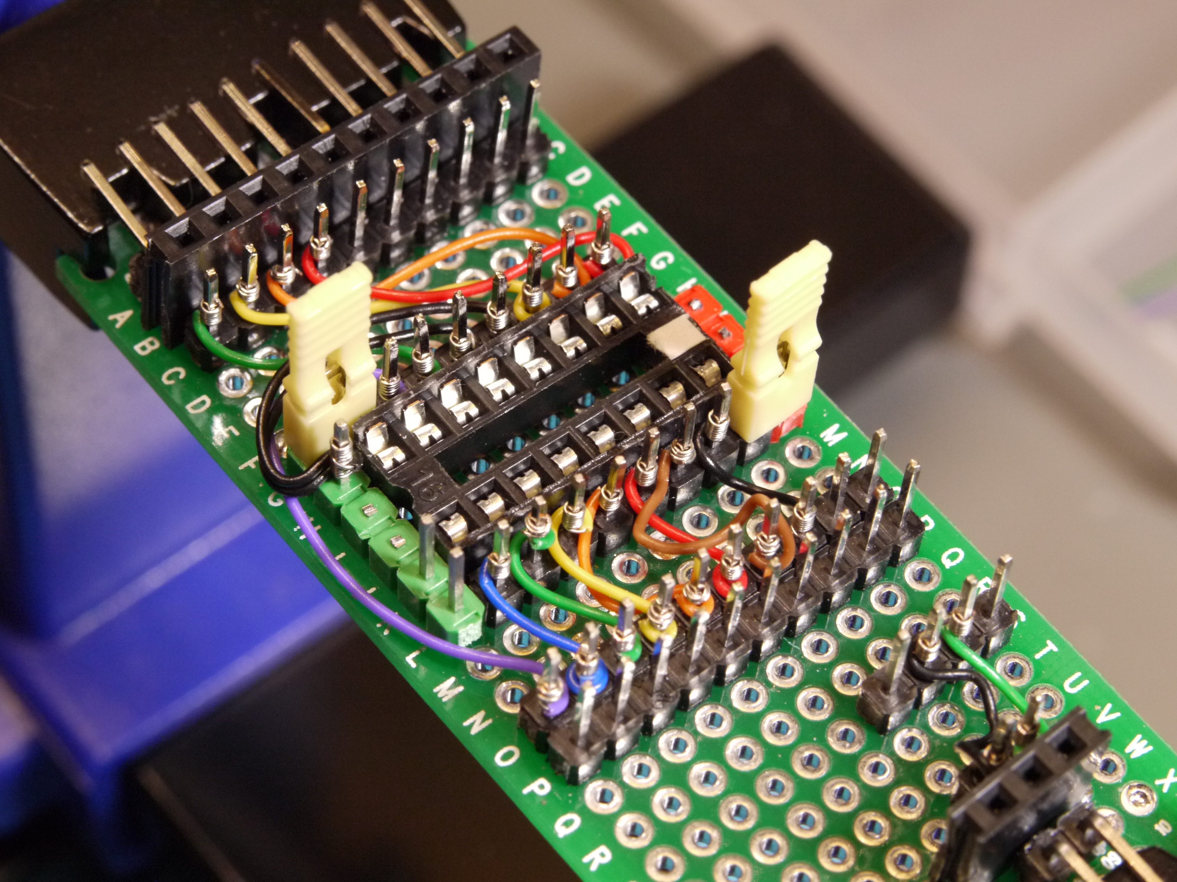

When you do get to doing boards, if you're impatient or just find hours in a CAD program to be tedious, you also have a couple of other options for techniques. Traditional hand-wired protoboard has worked well enough for me, though I discovered the hard way that making it very compact can drastically increase the difficulty of soldering it. (The example below is the bottom side of the octal logic probe prototyped on breadboard above.) One hint to make things easier: use 30 AWG wire-wrap wire, not the more common 24 AWG wire used in breadboards.
Wire wrap is a great technique, and very easy to learn: I was pretty easily getting decent WW connections within a couple of hours of starting out, with no help from anyone; soldering took much longer and I had lots of help. While the tool and wire are dirt cheap, the expensive sockets did put me off, though, but I discovered a trick from JuanGg in this forum of combining protoboard and wire wrap. Basically, you solder standard pin headers adjacent to standard sockets (done pretty easily by dropping a little cutting of component lead between the socket and header pin on the solder side of the board), solder power and ground leads too if you like, and then flip the board over and wire-wrap between the header pins. This not only gives pretty much instant gratification, but also makes it easy to make changes. (So, e.g., rewiring a socket to replace a 27128 EPROM with a 28128 EEPROM should be a few minutes work.)
You can see some examples of this used for a pretty large project in the thread I've linked above, but here's a close-up of a small test example I made, both powering a small chip and bringing its pins out to nearby straight and right-angle headers. Here I was experimenting with bringing power up on headers on the side and using jumpers to bring power and ground to the standard pins for a 74xxx part. If the power/ground pins were not right at the end, I could substitute short wires with crimped female dupont header at each end for the side-by-side jumpers you see there.
