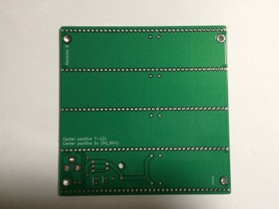

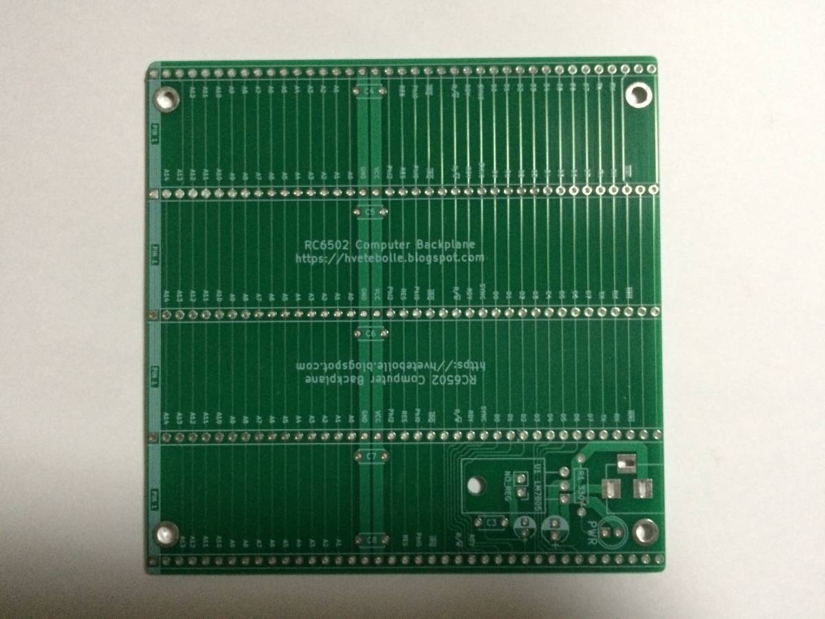

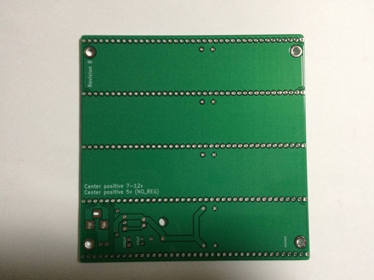

The RC6502 bus is essentially just the (non-expanded, i.e., first 40 pins) RC2014 bus with
a few signal assignments changed to account for the differences between Intel and Motorola signalling. (E.g., the /RD line becomes R/W, and the now unnecessary /WR and /IORQ lines are repurposed for READY and SYNC.) Pins 37-40 are all essentially user-assigned anyway (though there are some conventions that can be useful to follow), and if there were ever to be an "expanded" RC6502 bus it would obviously just follow along in a similar way from RC2014's expansion to a second row.
So since the physical layout, a series of .1" female headers at least 36 pins wide, wired straight through, is exactly the same, you can just buy any RC2014 backplane and use that. In fact, that's exactly what the designer of RC2014 first did.
studio_lowfi wrote:
Is there anyone selling PCBs (I'm in the UK) or do most people get them manufactured themselves?
There are at least three different people selling RC2014 backplanes, both bare board and assembled, on Tindie, and happily for you all three are in the U.K. (Sadly, you have to pick through a longish set of search results to find them all.)
I've never bought from any of them myself, but I'm rather partial to Stephen Cousins' modular backplanes because his SC112/SC113 design offers some extra flexability in the use of lines 36-40, and it's very well documented. (He sells boards and kits on Tindie.)
I notice that there's also a guy selling prototyping cards which might save a little bit of soldering when building boards for the system.
I myself went for the "official" RC6502 design, which is not quite so nice, but was easily available here in Japan from seller, fumi_i2 here on Yahoo Auctions Japan. He sells both backplane PCBs and SBC kits that include the SBC board and all parts. I've bought both and I'm very happy with them. I suppose others are too; I see he's sold 5 SBC kits and two backplace PCBs in the last half year, and that seems to be about the same rate I saw when I looked a year ago, too. I've attached images of the backplane PCB he's selling.

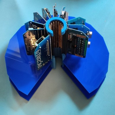

But of course the wiring is so simple that you don't even need to bother with a PCB; just stick some headers in a protoboard and solder them up and bingo, you have a backplane.
Or you can get even more creative:
File comment: RC2014 CrayZee system
File comment: RC6502 backplane top manufactured by fumi_s
File comment: RC6502 backplane bottom manufactured by fumi_s

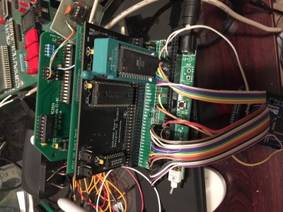

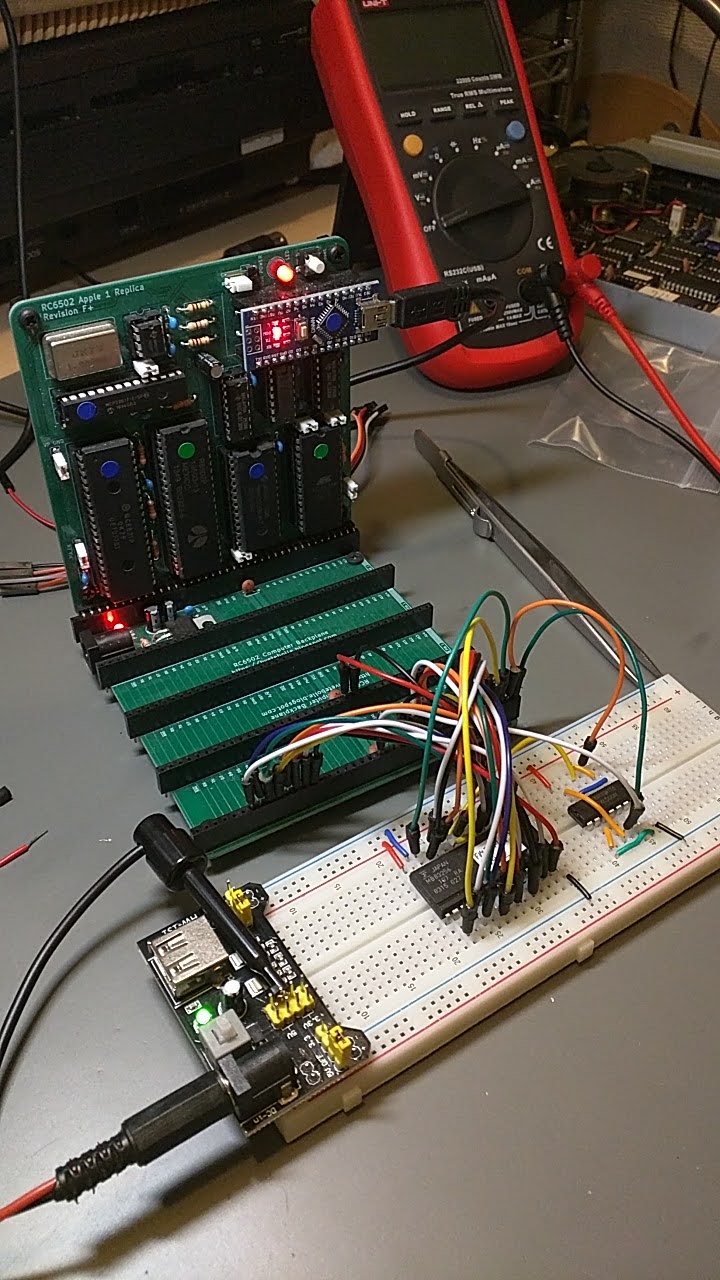

On Tindie there are a few boards made by Ancient Computing that are designed around the RC2014 bus. AC Offered a 6502, 6522, ROM/RAM and 165xx boards. The Tindie seller has not stocked boards for a long time but the order info is still there.
The 6502 board maps the R/W signal to the /RD and /WR bus pins. The IO cycles gets translated to $C0xx base so IO ports 0 to $FF is $C000 to $C0FF. So the 6502 is mapped to the Z80/Intel bus. (Possible timing issues aside)
I have a setup with the SC112 RC2014 backplane. With a WDC65C02 CPU card, AC 65C22 card and the AC 32KB RAM / 32KB ROM card setup. The CPU card is a variation of the AC 6502 CPU card created by Alan Cox (Etched Pixels). The big change is the IO base is moved to $FE00.
In the picture below is the Ben Eater Mega 2560 Arduino 6502 analyzer connected to the bus. A 60Hz clock is feeding the CPU from a color burst crystal board.
Greg

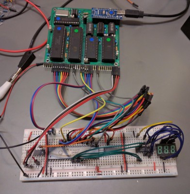

For simple expansion there's not even any need for a backplane board; you can just attach directly to the bus pins on your SBC. Here's a second 6821 PIA attached to my RC6502 SBC, along with a hex display on a few pins of one of its output ports:
I actually used that configuration to develop and test my octal logic probe, seen here on another breadboard below it:
