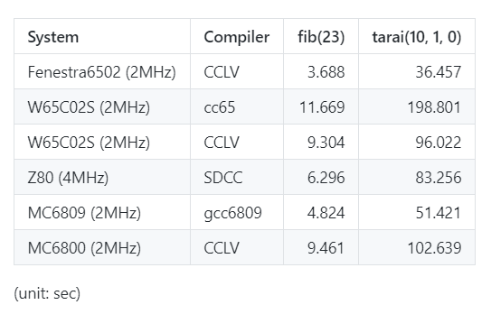

I wrote a code generator of CCLV for 6502 (W65C02S) and measured the execution time of fib and tarai.

Thanks hatsugai! This feels like valuable information, even though I can't make use of it myself.
