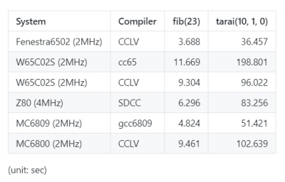

I wrote a code generator of CCLV for 6502 (W65C02S) and measured the execution time of fib and tarai.

I seem the tarai function is suitable for this kind of benchmarks, especially for measuring the performance of procedure/function calls.
Dr. Ikuo Takeuchi, the inventor of the tarai function, is famous as a Lisp hacker (one of the developper of TAO and NUE). It is said that tak version is McCarthy's mistake.
By the way, I made a MC6800 SBC (MC68B00, 2MHz) to compare the performance with Fenestra 6502 and others. Does anybody know if there is a C compiler for MC6800? If not, I will write a code generator of CCLV for MC6800.
