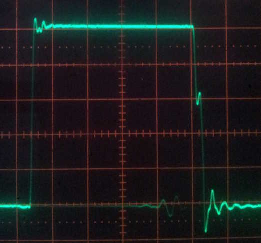

Marta wrote:
The scope indicated there are large undershoots of 400mV and ringings. They might be false, it's very short wiring here, the chips are placed close together.
The setup only has fragmentary schematics of the address decoding. [...] I will try to find some vector drawing for Linux
I have no idea of where the JSR goes, will try to find out.
Edit: the resistors should be fairly low value -- 1K, say. That's because on an '816 there's limited time for them to do their job. During every Phi2-low period the CPU drives the Bank Address onto the data bus.

Re: AIM-65 homebuilt semi-replica
This is a scope photo of BA4. 5VV, 100ns per square. Last calibrated 30 years ago...
Ground tail of course securely connected to the cards ground plane...
There are substantial ringing and overshots, Much more than expected.The 245 and 373 sits alongside the CPU just 7.5mm apart from it. Nothing else are connected to those lines. Top of the leading edge looks strange. Maybe there is some contention?
