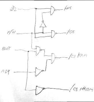

As seen on the earlier picture, the card is completely covered with copper on each side. Bottom layer is GND and top layer +5V. It has a 100n ceramic at every IC. Power looks nice on the scope.
It has a hc245 and hc373 closest to the MCU, just as in WDC's data sheet. This first 245 is connected to PROM, RAM and another 245 that is off exept when addressing I/O or video RAM. The four lowest address lines and R/W are buffered by a 245. That also drives ph2 that has everything connected in parallel, the VIA, CRTC and quite a few gate inputs.
All I/O, CRTC and video-RAM are at high addresses. 0..512K is all RAM. The address decoder involved with code execution is built as per my ugly drawing. At startup the line labelled boot is driven high and reset released for a short moment while the primary boot loader is copied from PROM into RAM, Then reset is asserted, boot released and then reset. At this point it is ready to accept loading over the VIA.
Can You spot any potential timing problems in this setup?

I have no logic analyser, but a Philips PM3217 50MHz analog scope with delayed timebase. With special test software most things can be made repetitive and observable on that. As I'm disabled there are some difficulties clear out space for it where the PC and 816 are placed. I also have a locic pen, but that is only good for finding missing or erraneous connections.

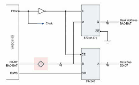

Maybe the '373 bank address latch isn't closing soon enough to meet it's hold time requirements.
Try advancing it's clock. Maybe connect it's inverter to the input of the '245 clock buffers.

The 74AC373's hold time is only 1ns. The 816's bank hold time is specified to be 10ns min; so it should be very easy to meet. We have a good topic about this at viewtopic.php?f=4&t=2438 .

Now I has tried to connect the inverter for address latch before the hc245 clock buffer. That restored function to the state before I begun making changes. The data buffer has it's own inverter, still connected to the system wide clock buffer.
The JSR (ABS,X) still misbehaves. I will try to use the scope today. If I place it upright on the floor then I may be able to do it without help.
If the buffer turn off is slow, there might be a short contention when bank addresses comes on. Maybe I can see what actually happens and stop guessing.
I used the exact design from the data sheet assuming that was an approved way to solve the critical timing. The diagram has a magic symbol, red marked in the picture, that I wonder what it is. Maybe resistors? Even fairly low values will cushion a hard contention conciderably.
My chips are old Sanyo, are there any known differences with the TSMC chips?
