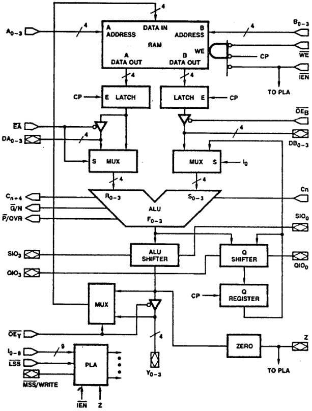

Nah, just build sort of an improved AM29203 with 74AUC, then sell it to other TTL CPU hobbyists. ;)
BTW: Würth Elektronik also is able to integrate SMD components into PCBs.
