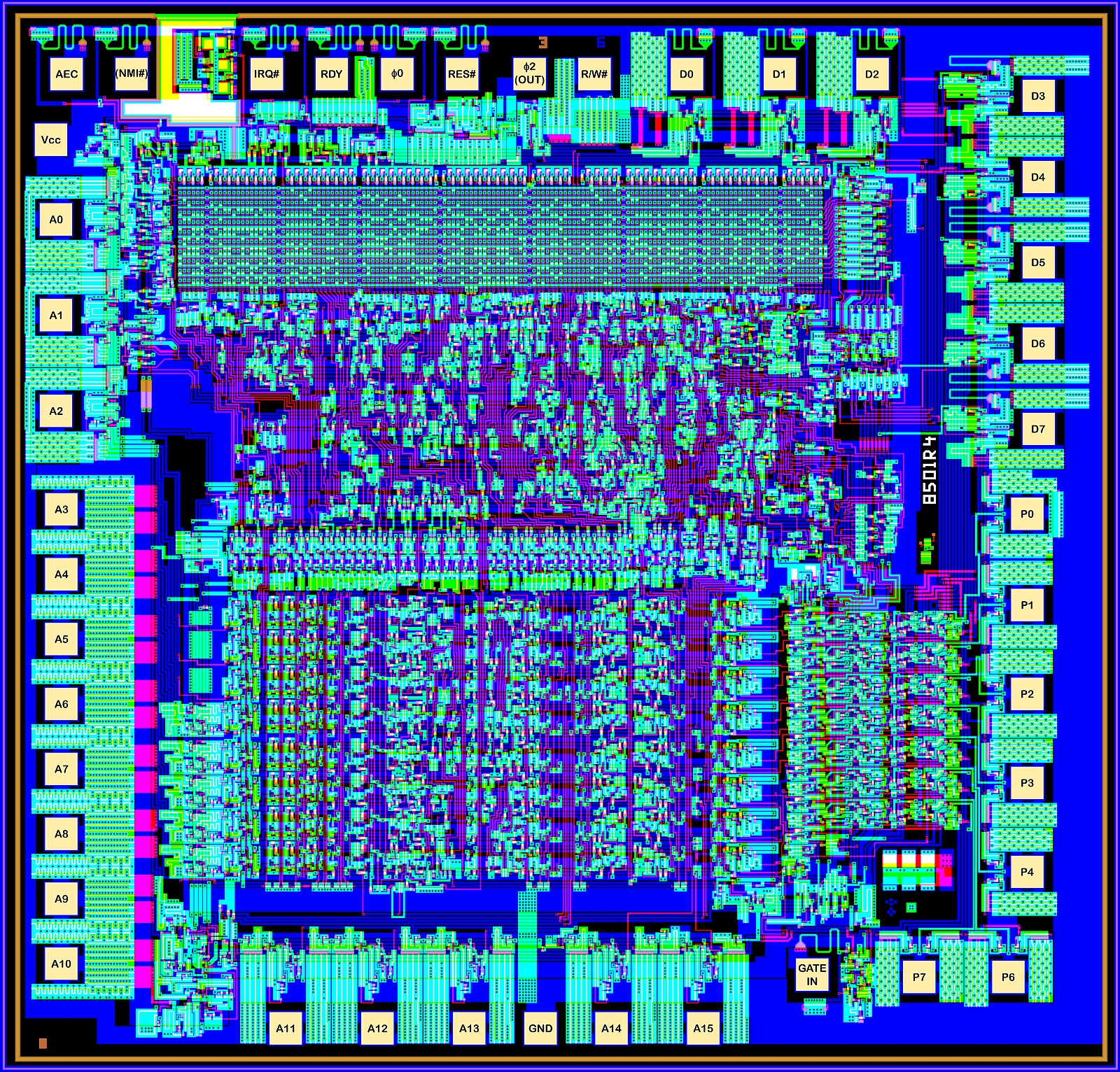

It is well known that the Commodore 264 doesn't support NMI. However https://www.floodgap.com/retrobits/ckb/secret/x64.html claims that the 7501/8501 can handle NMI signal. They wrote
Some of the apparent differences between the 6510 and 7/8501 are actually board-motivated: for example, (intriguingly) there is no way to generate an NMI on the Plus/4, and probably any other 264 series computer, despite the fact the 7501 does accept NMI signals.
The page https://myoldcomputer.nl/technical-info/datasheets/integrated-chip-pinout-and-datasheets/processors/8501-2/ shows the 8501 pin layout, there is no NMI input line... The 7501 should have the same pins...

GATE IN seems to be related to the DRAM control in the 264 series. The 7360/8360 (TED) handles DRAM refresh (Drives /RAS and /CAS, which are wired to U5 and U6 in the C16 schematic). The MUX line is driven by the TED and is wired to GATE IN on the CPU.
Is the 7501/8501 used in any computers other than the 264 series?
I think I read somewhere that the NMI circuitry is still on the die in the 7501 but not bonded out to a pin?

Yes... it's there but not bonded. See picture attached: Pad names in parentheses are the ones not bonded.
