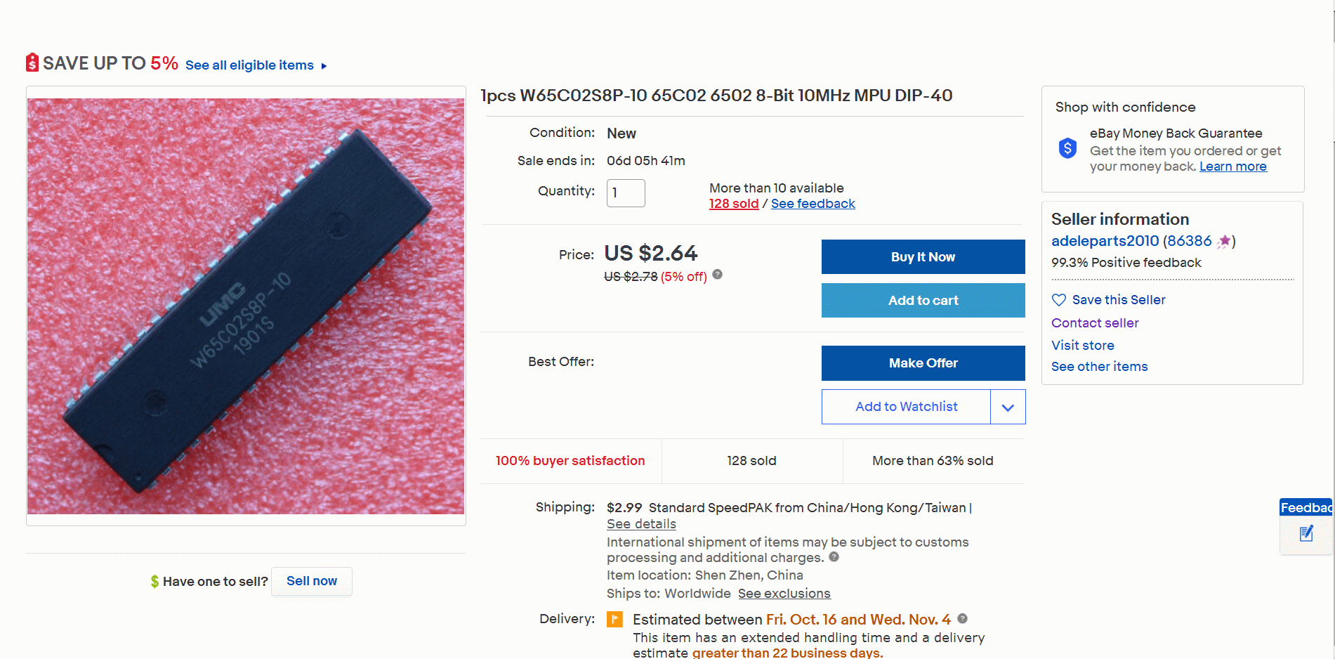

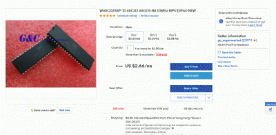

PLEASE READ THIS BEFORE BUYING ANY WDC 65XX PRODUCT!
Recently, I was in communication with David Cramer at Western Design Center (WDC) regarding when WDC switched foundries and processes for their products.  David’s reply has been copied below.
You have a fantastic question but the answer is not too straight forward, so I will do my best.  In general, I must say we are seeing more and more cases of remarked, NMOS, or flat-out fake chips.  So far, I have not seen any of these have been marked as TSMC .6u parts (i.e. W65C02S6TPG-14).  If you hear of one, please let me know or refer them to us.
Here is the general advice for those purchasing parts and want to make sure they get them from a reputable source.  They should refer to our Where To Buy page, as this page lists our current authorized distributors and we even have links to any available online purchasing they offer (note that the links for Coltek go to parts they sell on their UK Ebay site). Other than Coltek’s eBay store, I see many questionable listings.
Any part that is marked W65xxx that does not have a WDC logo is suspect.  WDC has never authorized any licensee to use our naming convention.  [Emphasis added.]  Here is an example on Ebay.
I wanted to highlight this Ebay listing as an example of a remarked part that is very wrong.  Here are a few things that jump out:
  1. The logo is incorrect, especially for a seeming laser-marked part.
  2. Date code.  This is likely a valid date code, however, that means it is from 2010.  No S8 parts were assembled in 2010.
  3. Speed. The -10 has not been made since likely before 2000 (my easy to get to records go back to 2001 and all of those seem to be -14 parts.
Below is some information about the manufacturing timelines that may help those that purchased parts before finding us or 6502.org.
SANYO to TSMC:
WDC switched from Sanyo .8u to Sanyo .6u wafers for the W65C02S, W65C22S, and W65C816S devices starting in 2002.  It is likely the majority of these new S6 devices were actually packaged in 2003 and beyond.
Here is a timeline for switching to TSMC wafers:
W65C22S6T - 2004 Note that W65C22S6P/PL/QG parts would have been packaged between 2002-2004 that had Sanyo .6u wafers.
W65C51S6T - 2004
W65C21S6T - 2005
W65C02S6T - 2006 - Note that W65C02S6P/PL/QG parts would have been packaged between 2002-2006 that had Sanyo .6u wafers.  Some S8 parts were also packaged in this timeframe of 2002-2006.
W65C816S6T - 2006 - PLCC and QFP devices are in production.  PDIP parts are still W65C816S6PG-14 devices using Sanyo .6u wafers (Most of these parts in the wild have a date code of 1023, 0627 laser marked or 0435 ink marked).  We just sent out some TSMC wafers for PDIP packaging so there will be some W65C816S6TPG-14 devices with date codes starting with "20".
W65C21N6T - 2009
W65C22N6T - 2009
W65C51N6T - 2009
ASE Packaging:
WDC used ASE as a packaging facility until the end of 2005.  To my knowledge, all of those parts were ink marked.  Anything from 2006 on was done at GTK and were laser marked.  Laser marking is harder to counterfeit than ink marking.
There you have it.  If you purchase any WDC product from anyone who is not an authorized distributor you are being very unwise and almost certainly will be sold a re-marked or counterfeit part.  Most of what you may see on eBay is likely fake, excepting product sold through eBay by authorized WDC distributors, such as Coltek.  If you are not sure that what you are about to purchase is genuine, refer to the above information from WDC and compare it against the markings of what the seller is going to send to you.
