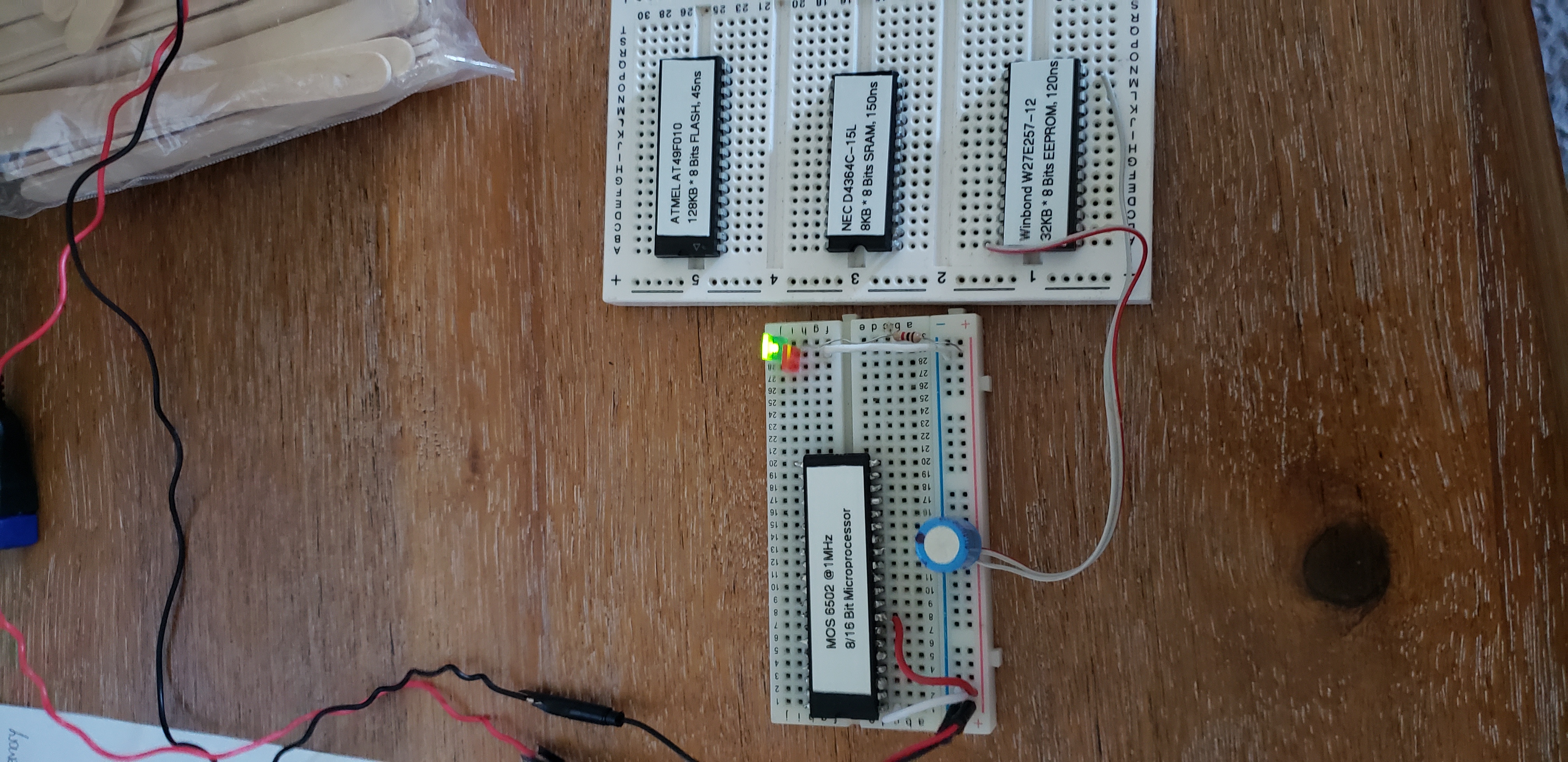

I've taken a look into the videos, and they help clear up some of my confusion. I've yet to acquire a EEPROM programmer to begin writing assembly code to use my chip, and a 1MHz full-can oscillator for the clock. I'll also be extracting the MOS 8520A-1 from my now "for-parts" Commodore 1581 drive (Bad idea now, so RIP... Then again I'm basically broke atm) Complex Interface Adapter for my project's I/O. Embedded is a photo of the basics, ready for me to get some work done.
I've considered using a similar memory map used in the videos. I'm probably gonna use a bit more efficient methods of using the 68K (idk) addressable space for RAM/ROM/IO... I'll also be using my FLASH chip instead of my EEPROM, mainly because of a faster maximum access time, according to the data sheets and AFAIK. Since I have a limited amount of SRAM to use (8KB), I'll probably use an extremely low-address, maybe a zero-page? And maybe the ROM an extra 48K, with the remaining amount of addressable space for the CIA, though this is a idea and I'm not sure my miscellaneous parts bin has the logic gates I need to determine what hardware device to use when the CPU fires a request over the system bus...

I'd suggest your first build can have a very simple, and even inefficient, memory map. It will make life easier. You have little choice but to put RAM at the low end, and programmable ROM at the high end, because of the 6502's design.
That is to say, I urge you to think of your first design and build as only the first - it does not need to have all the flexibility and capability that you might want in a subsequent design.
I know... It's just a thought. As I said in my last post, it's only possible if my miscellaneous parts bin has some logic gates for determining what I/O device to use. I haven't checked it in a while, but I do believe I may have some NAND gates... Not entirely sure at the moment but it's something along the line of the Texas Instruments CD-series logic chips?
Leave the CD4000 series for when you need 12V (or other high-voltage) logic with no speed requirement. CD4000-series logic is extremely slow (like hundreds of nanoseconds at 5V) and totally unsuited for address decoding and other glue logic.
PostPosted: Wed Jul 22, 2020 8:58 pm
CD isn't the relevant part. What's important is the letters after the 74, such as 74LS00 or 74HC00.
Garth's right about CD4000 series being unsuitable. But not all CD chips are 4000 series. I'm pretty sure CD74 series and CD4000 series both exist. AIUI, the CD is more of a manufacturer's designation, and not really of much concern to us.
So, in other words, I think you can ignore the CD part entirely. Look for one of the 74 families. 74HC and 74HCT are usually good choices, unless you really need some extra speed. As for 74LS series... well, it works, but it isn't the best choice.
Have a look in your junk box and see what you can find! :)
Well, I only have a pair of CD4011BE chips, and a MC14001BCP chip (which is a NOR, not a NAND)... Either I should run my CPU at a really low speed clock or consider purchasing the aforementioned logic chips.
I do have a spare 12V with 5V power supply, with which I can run the CPU and other low-power devices are 5V, whilst running the logic gates at 12V? Though, I'm not entirely sure how the chips will perform. I'm not really good with reading datasheets...
Edit: I have my for parts 1581 drive motherboard, and it does have a HD74LS00P chip. That's much better. Also, I've taken a look into the 74LS93 chip and the drive's circuit board diagram, and if I'm not mistaken the 74LS93 divides the oscillator clock (16MHz) by 12, so it should be theoretically operating at 1.33MHz?
I don't really have that much need for speed, just a basic design that "works". In the future I'll consider upgrading the logic and purchasing the W65C02S, with which I'll be able to use my 16MHz oscillator.
It's still a 4001; so the same advice applies.
You cannot mix voltages like that without voltage-translation parts in between. If you run a 4000-series logic IC on 12V, its inputs won't recognize a 5V (let alone 3.3V or 2.4V) input voltage as a logic '1'. Also, its 12V output may blow 5V logic's inputs. 4000 series is still slow at 12V too, just not as slow as it is on 5V or lower. You're pretty much stuck with either 74-family logic or programmable logic.
The difference in the speeds of these two will be extremely small compared to the difference in speeds between the 4000 series and most of the 74xx__ families.
Such finer-grained address decoding requires the cascading of more logic levels, which makes the gate delays add up. That's ok if the logic is fast enough for the desired clock speed; but seeing if you're in the clear will require looking at the propagation delays published in the various parts' data sheets and adding them up where you have multiple gates cascaded.
Ben apparently got it from the 6502 primer, specifically its address-decoding page, which I wrote nearly 20 years ago and finally published it eight years ago when I got my own website. [Edit: I forgot I had posted it here at viewtopic.php?p=2326#p2326 in Jan 2001.] I've been using the scheme since the early 1990's. It's possible of course that he came up with the scheme independently; but I still highly recommend going through the 6502 primer which is about the many aspects of building your own 6502 computer. It was written to answer questions and problems that kept coming up here on the forum.
