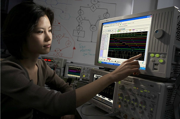

So I think I'll put off the O-Scope for now, maybe when I move, but I'll probably add a logic analyzer to my mouser basket.
Errr... make that "logic probe." Here's a logic analyzer, the Agilent 16821A 34-Channel Portable Logic Analyzer, kind of a low-end one, at $26,000 starting price:

Oops. I meant logic probe, thanks.
