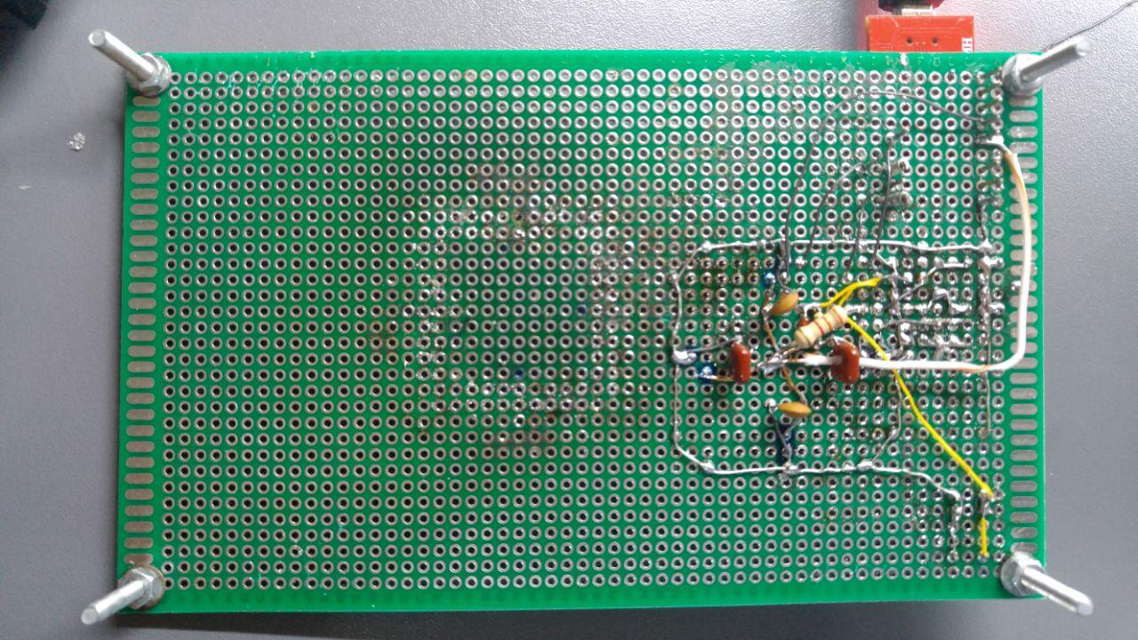

Re: My project with a w65c265s MCU.
This looks quite a lot better. But in the 2nd photo, are those bare wires leading away from the upper right corner of the '265 ??
A wrapping experiment, perhaps? -- something you'll remove later?
I decided to rearrange my geek room, and also decided to rearrange the SBC.
As I received the final items for the first part of the project (128K of 55ns RAM, the EEPROM and its socket, the 74HC00 chips...) I decided to move the MCU to the left.
So I have to desolder everything, rearrange the bottom part of the SBC to have as much as possible under the MCU itself, and put the reset button in a corner.
The board itself got a bit burnt because I used a heat gun to get all the soldered pins liquid at once.
I also got rid of the pins, because I just couldn't get the ability to wire wrap the right way -- also, the space was so full of pins that for me it was a no-brainer to take them away.
It's waaaay cleaner than before.
PROGRESS:
I've added a second serial port to my board, as I intend to implement Andrew Jacob's w65c265sxb-hacker tool.
I also have added a 74hc00 there, just at the left of the MCU.
I'm modelling this prototype after the w65c265sxb, and now I'm going to add both the EEPROM socket and the SRAM socket.
I have two questions:
1.- Is is better to arrange the DATA and ADDRESS cables in parallel or in a star configuration?
2.- The w65c265sxb originally comes with 32K of SRAM. But the chip I got is 128K. I've seen the 32K wired in the SXB schematics with all the ADDRESS and DATA bus pins. Does it mean that all the chip will be enabled when selected, or only its first 32K of RAM, as the original SXB does with its 74HC00?
You can make my hacker tool work with the same UART as the monitor or a different one. It is controlled by the UART equate in the w65c265sxb.asm file.
How much RAM you can see will depend which chip select line you drive it from. CS3B (e.g /CS3) selects $0200-$7FFF in bank zero ($0000-$01FF is provided by the chip). If you use CS7B (/CS7) then you can have upto 4M at $C0:0000-$FF:FFFF (or a smaller amount repeating).
I had a try using with CS5B but without much success. I've not spent long try to find out why. It may not be enabled by default.
Thanks! As I'm cloning the SXB design, the schematics show that its /CE input is driven by CS3B and, and I'm correcting my mistake here, its address inputs are driven from A0 to A14, so that means 32768 bytes for me.
So, my question was that if even putting a 128K chip there, wiring only from A0 to A14 would render the chip to just use 32K.
Anyway, the goal here would be to have a SBC with a custom ROM that, once enabled by the internal monitor, would disable the internal RAM and ROM at all and take full control of the MCU, having it access to the full 128K of RAM.
