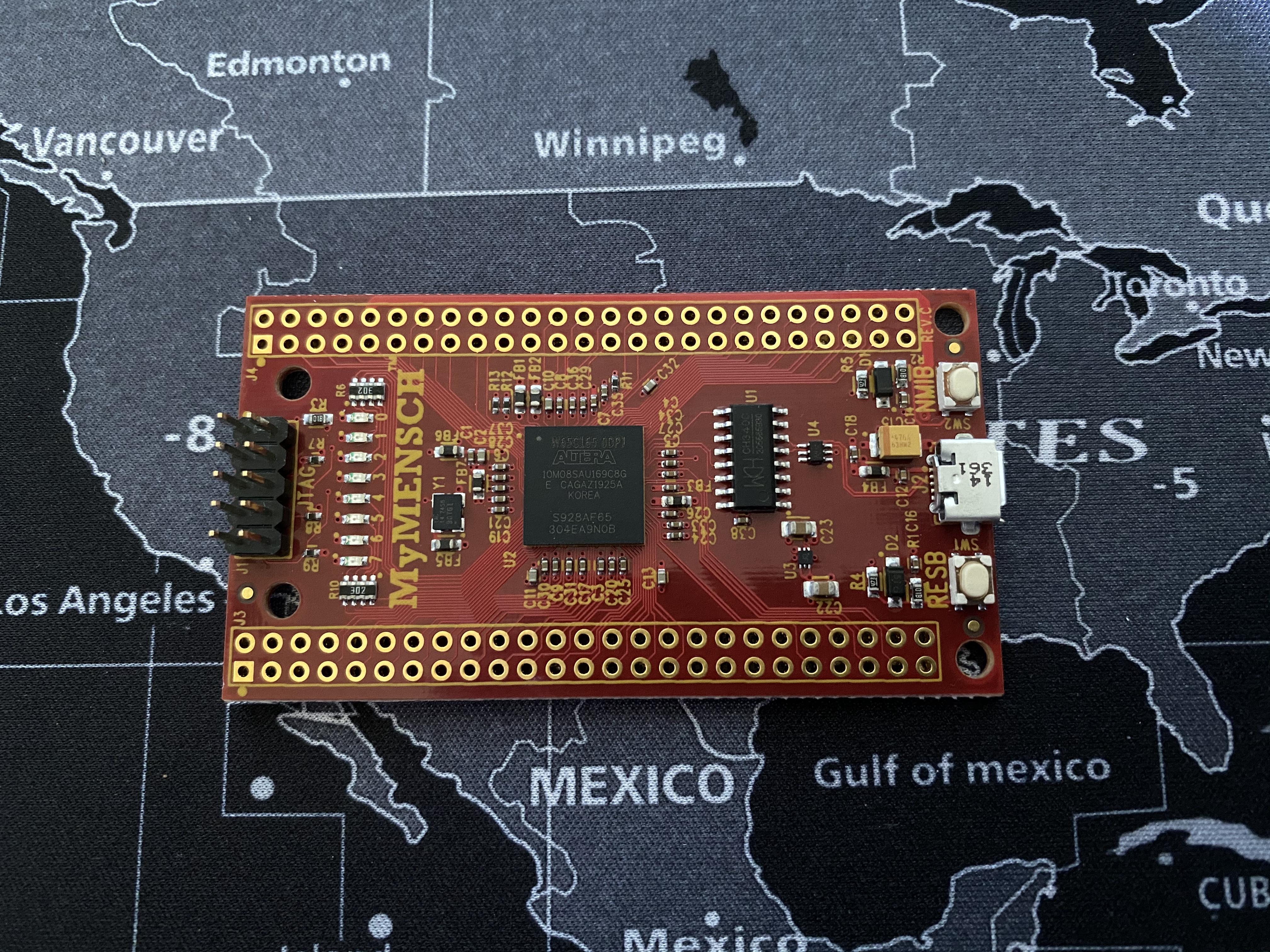

A received one of WDCs new FPGA microcontroller boards this morning. I'll try kicking the tyres later to see how it performs.

From the picture: 10M08, the smallest FPGA in the Altera MAX10 family.

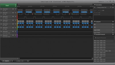

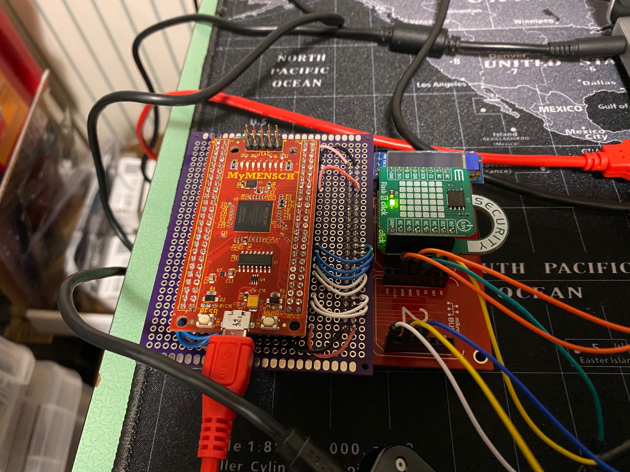

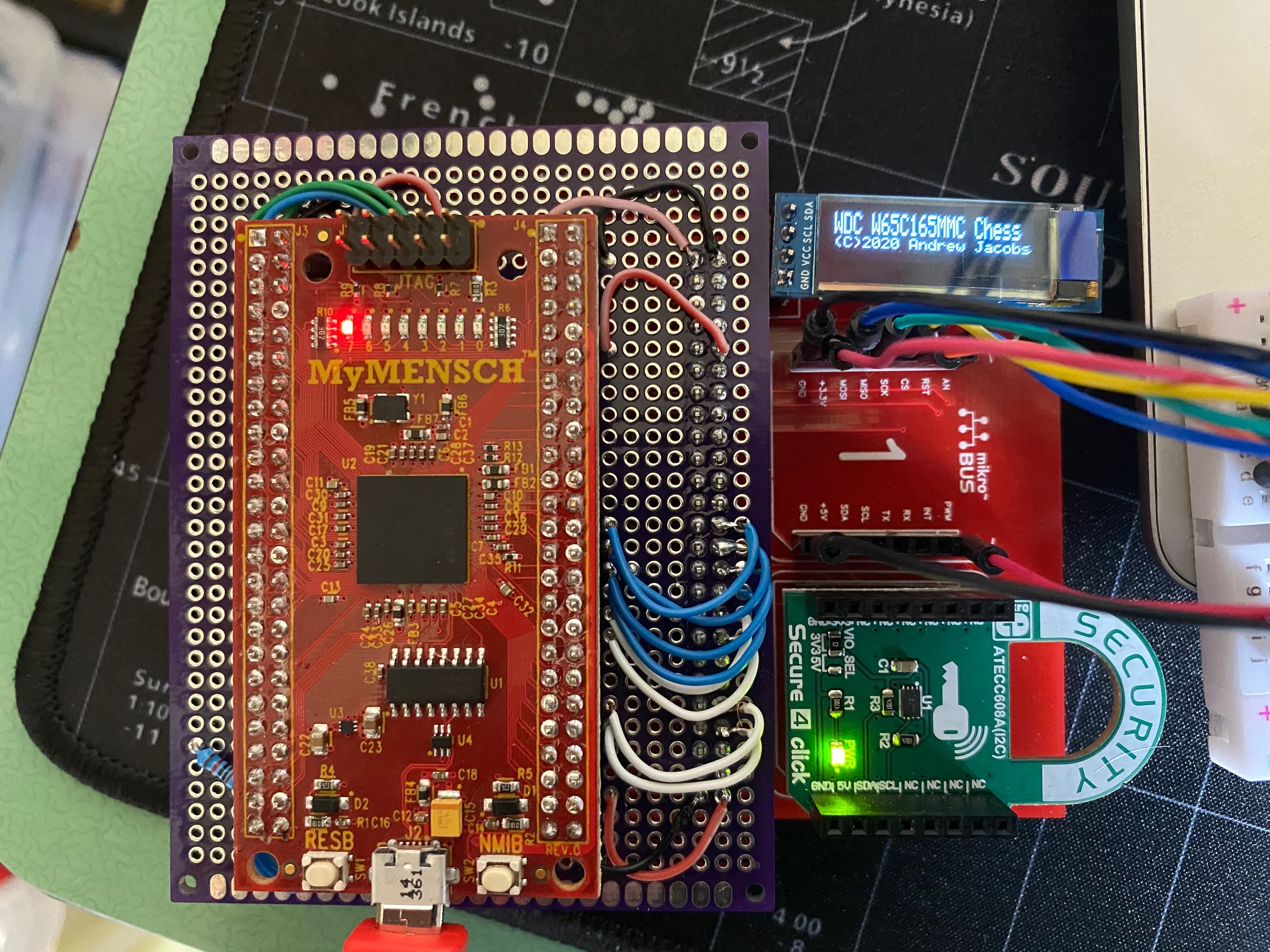

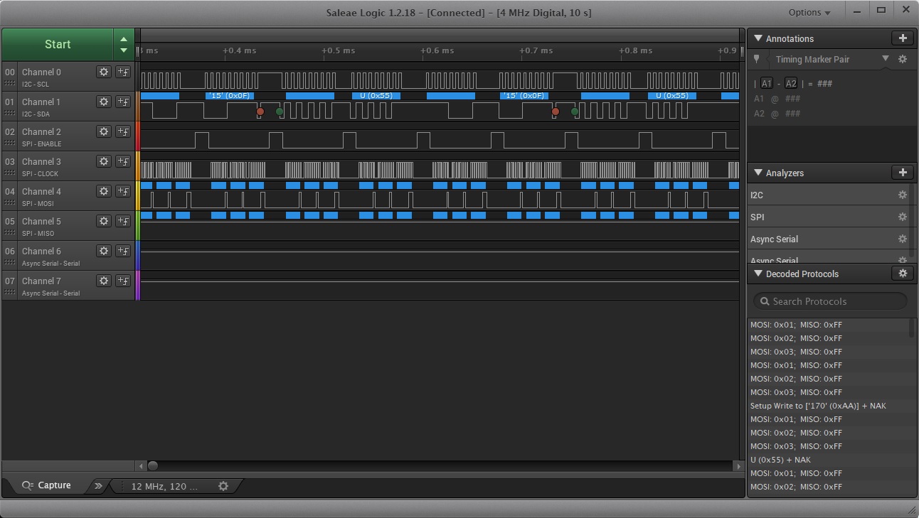

I've been fighting with the I2C and SPI controllers for a couple of days and am starting to win. WDC sent me a prototyping board that can be used with an I2C OLED display and Mikroe Click boards.
The prototyping board was designed for an earlier revision of the W65C165MMC so I've had to knock up an adapter this evening to remap some of the pins to get SPI chip selects working for my newer REV C board. If I'd had a suitable JTAG programmer it would have been possible to install a reconfigured core that has the old pin arrangement but I only have old Xilinx kit not Altera. WDC say they are updating the prototyping board so it will match.
The hardware I2C and SPI controllers make generating signals easy at high speed. It took a while for me to get my head around them. On PICs there are bits in the control registers to generate start/stop/read/write signals individually. The core WDC is using combines the generation of start with the write so you do an initial 'start and write' for the I2C address, 'write' for intermediate bytes and a 'write and stop' for the last byte.
The controller designs are a little inconsistent. The I2C controller must be disabled before you can change the clock divider but the SPI controller must be enabled or it ignores the change.
My test harness splits the hardware stack and creates two cooperative threads of execution. One loops generating a I2C test packets whlle the other generates test SPI data. The I2C yields while it is waiting for its much slower operations to complete. At 14.7MHz the operations run in parallel. Now I have the communications working I can start on creating valid commands to some of the slaves. I'm creating a set reusable assembly code modules for each part of the system and will publish on GitHub when I'm done.

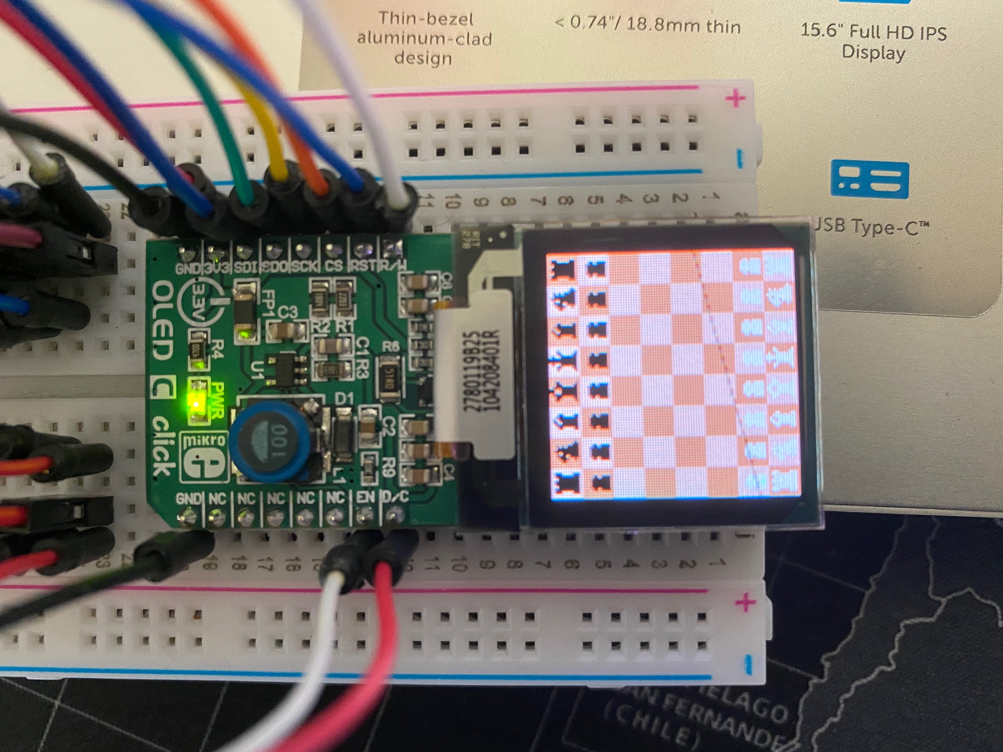

The I2C controller was harder to use than the SPI but in the end I got them both working reliably.
If you squint you can see text on the I2C OLED There are some issues with the Mikroe OLED 2 Click board I'm using. They designed it using two pins that are normally outputs (AN - analog and INT - interrupt) as inputs (R/W and EN) to the display controller and power boost chip. I connected via a bread board so I could attach a logic analyser and wired AN(R/W) low and INT (EN) hi. I'm going to play with the WiFi/BLE click next and add some ACIA/VIA timer interrupts.
