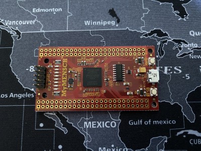

A received one of WDCs new FPGA microcontroller boards this morning. I'll try kicking the tyres later to see how it performs.

Do I take it that this is an FPGA with a pre-loaded WDC microcontroller design on it? So for the customer, it acts as a microcontroller chip, without any reprogrammability? (Not that that's a terrible thing, but it seems to make the FPGA aspect somewhat incidental.)
Ref: http://www.westerndesigncenter.com/wdc/ ... 1M16SA.pdf
I note that the underlying FPGA is built on a flash technology, so it's instant-on, and has some amount of user-programmable flash for user software.

My understanding is that this board works like a microcontroller with a set of embedded devices but its also a demonstration of the WDC softcore modules.
In addition to the CPU core there is a GPIO port, 3x VIA, 3x ACIA, I2C & SPI controllers, Hardware Multiplier, ADC, Chip ID and user flash.
I'm not sure how you actually get code into it at the moment. A puzzle for later.

From the picture: 10M08, the smallest FPGA in the Altera MAX10 family.
Now this reminds me to the XLR8: Arduino based on Altera 10M08 FPGA...

Wow, WDC pricing strikes again. If this really is just a 10M08 you can get a 10M08 dev board with more I/O pins and 8MB of RAM for less than half the price:
https://www.arrow.com/en/products/bemic ... A8QAvD_BwE
WDC is effectively charging a $30-40 dollar premium for their soft core (65816 + 3x VIA + 2x ACIA), which is quite a lot.
