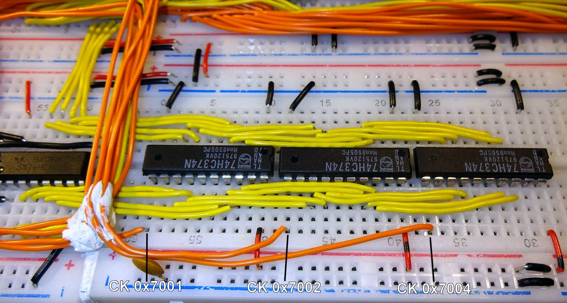

I'm going nuts...
I used a 74HC374 D-Latch in my 6502 Breadboard Computer to set an 8-LED-Output sucessfully (at address 0x7000)
With the same principle I want to do a 3-digit-7-segment-display and give them the addresses 0x7001 (left), 0x7002 (middle) and 0x7004 (right).
When writing to 0x7000 only the LED-Output is triggered, the 3 segment-display don't get a clock and signal at CK keeps steady high.
BUT: the Seg-Display in the middle (and only in the middle) changes it Q-Outputs without any clock on its CK.
It's a riddle to me... I measured with my multimeter and my scope, what I could, but haven't found the error reason?
Do you have a clue?

PostPosted: Thu Jun 25, 2020 7:19 pm
Welcome! It might be omething more specific, but in the photo I don't see adequate decoupling caps: you need a cap like the one you have near to each of the chips, and you need a bigger one, an electrolytic, on the rails. (I say you need these: if you have an unreliable circuit, it's the best starting move, to clean up the power.)

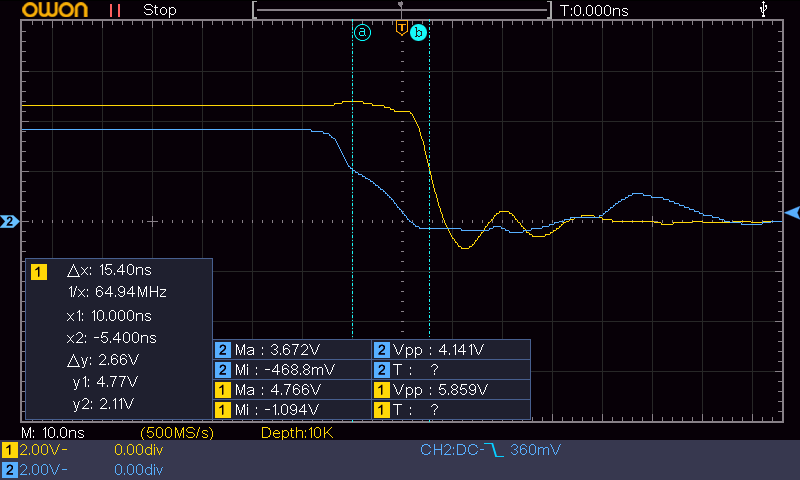

Okay, I've zoomed really deep in with my scope and found a 20 ns signal fall at the middle 374.
But only an the middle one, not on the left and not on the right one.
It's only 20 ns on low but this seems to be enough to trigger the 374er to update.
Yellow line on the scope is the NOT(A12 AND A13 AND A14) signal.
Blue line on the scope is NOT (A1 AND A12 AND A13 AND A14).

I've measured the time, the NAND gates needs to operate:
Thats means the time between
A12 is going low (blue curve)
A12...A14 (NAND cascade) is going low (yellow curve)
and it is 15.4 ns.
In the going-high-phase the NAND-Cascade needs 16.8 ns.
Have to think about the timing will differ on solution 1 (phi2 into A12...A14) or solution 2 (phi2 into A0, phi2 into A1, phi2 into A2), which would be more effort.

Finally I've found the reason for the strange behavior: propagation delay.
My TI 74HCT00N needs 5 ns for a gate pass, so the A12...A14 ist 20 ns befor A0, A1 and A2.
That is too much for the way I drive the 374er.
