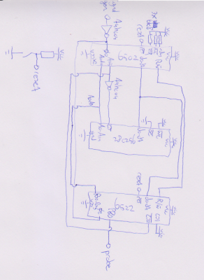

Thanks for your replies. I attached schematics for the breadboard computer.
I personally think that I did somehow damage the 6502, why would it otherwise get warm? Or is that normal?
In any case the goal now is to see if the chip can be made to work.
As I said, I have confirmed it does still work, but unreliably.

Further developments:
I decided to investigate the unreliableness a bit more. I tried adding a schmitt trigger using a comparator after the signal generator to make sure I was giving a clean signal to the NOT buffer. That didn't seem to have any considerable effect. After that, I decided to measure what was on the data and address lines after the 6502 randomly stops, and I saw that it was reading $00 at address $FFFF. That is of course the location for the irq/brk vector, so I though it was maybe for some reason stumbling upon a brk, and therefore trying to go to location $0000. I don't know what would then cause it to simply stop, but it apparently did. To confirm this hypothesis, I programmed the eeprom to let $FFFE/$FFFF point to the address of my loop. That worked, and it ran a lot more stable: up to 800khz it didn't stop anymore, but going any higher than that would still cause it to stop after a while.
Still suspicious about the quality of the clock signal, I tried removing the schmitt trigger to see if it would have any effect, and it did; it was way less reliable without. This confirmed that the clock was probably the source of my problems. I also tried hooking up a 555 to act as a clock source. That didn't work, however, I discovered that I had been using 680R resistors instead of 6K8... After changing that, and after changing the hysteresis ratio a bit, the 555 also worked, but it still wasn't reliable. But, after I changed back to the signal generator, it díd work! Even after removing that brk vector, it was still reliable up to 1mhz.
My conclusion: I probably had a very noise signal generator output, which sometimes caused unwanted extra clock cycles or something, messing up the 6502. That caused it to sometimes read $00 as an opcode instead of as part of an address, and therefore jumping to the address at $FFFF, stopping the cpu. Using the schmitt trigger, the noise was removed and that solved it.
This also means that my 6502 indeed isn't broken, and that my soldered prototype probably has some other problem somewhere, so that is what I'll try to find now.

Good investigation and result! It might be worth noting that problems in power supply decoupling, or noise on the ground line, can also work the same way as noise on the clock. So, clock and power are well worth getting very clean.
Yes, this is certainly important. It's not a good sign that you were "measur[ing] high frequency oscillations between 0 and 5v on all the data lines and address lines." :shock:
Prior to your latest post I began some annotations to your schematic, which I will share now. On older 65xx systems it was SOP to take the Phi2 and /Phi2 signals from the outputs on pin 39 and pin 3 of the 6502, and as you're using vintage parts it may be helpful for you to do the same, rather than taking them from the input side (where I've marked). It may also be helpful to feed /Phi2 to the /OE input of the 28C256, for the reasons explained here. Neither of these changes is a sure-fire fix. I'm more suspicious about bypass caps and power, and the clock signal.
The Schmitt trigger is certainly worthwhile -- your Signal Generator needs to provide crisp transitions.
You should probably consider debouncing the reset signal, BTW. There are some suggestions in Garth's primer, here.
" :shock: " Indeed... I don't think that was caused by noise, maybe my ground probe was detached or something, although I find that unlikely.
I should note that this breadboard version and the schematic I posted of it isn't really similar to what I have soldered, it was just a test to see whether my ic's were broken or not and whether I was still able to create a minimal working system.
The clock on the soldered version comes from a 1mhz can oscillator, so I assume that should provide a clean clock signal. It has worked before anyways. I also made a simple reset circuit that not only should provide a clean reset signal, it also provides two reset signals, so you can make sure that the IO resets before the 6502.
I did take care during soldering of ensuring good power and ground connections, as well as 100nf bypass capacitors, so I think that shouldn't be a problem. The power supply is a simple 2n3055 emitter follower to step down 12v to stable 5v, along with a 1000uf electrolytic capacitor. I'll try however whether I can measure any significant noise.

Well, I solved my problems!
When I filled my EEPROM with just nop's, I was still measuring garbage on all the data and address lines (AKA "the high frequency oscillations").
I ruled out problems with the clock and power supply by using the ones I used for the breadboard test. I then ruled out the memory map by testing it on the breadboard version. What is left? Soldering of course...
And indeed, after not only checking for shorts between neighbouring pins and ground and vcc like I had done before, I also checked for shorts between áll the pins on the 6502. Turns out I had shorted A1 to A13 and D3 to A12. :oops:
I have my chips very close to each other, just one pin-size in between, and a bundle of 10 or so wires somewhere running in that tiny space. If you then try to solder a wire to one of the pins of a chip, what apparently sometimes happens is that that wire punctures a hole in the bundle of cables and melts the plastic because the wire heats up trough the soldering iron. So that has happened to me twice.
