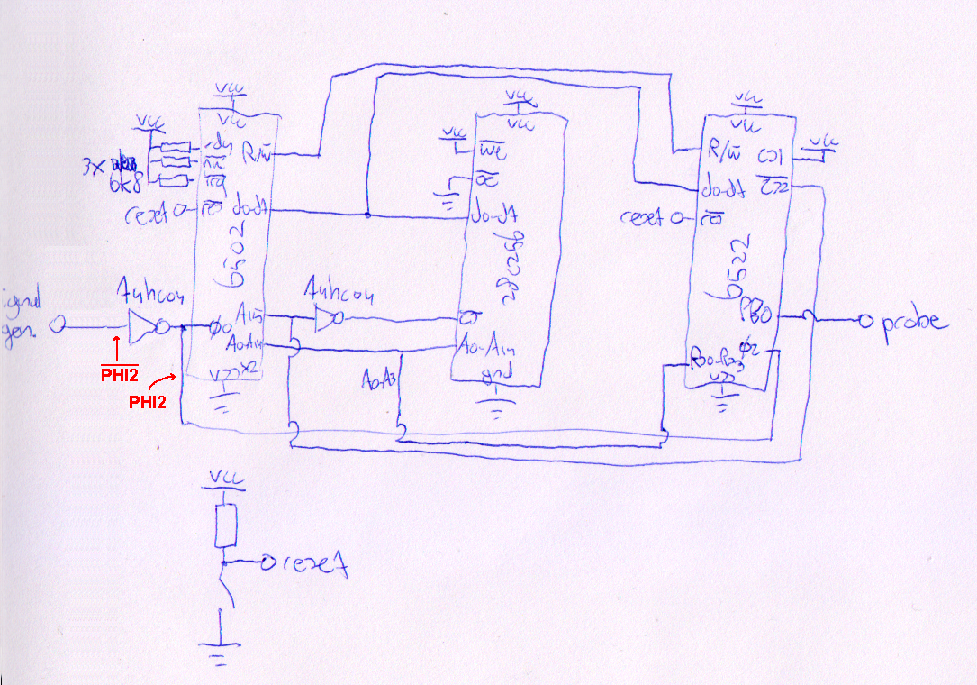

Thanks for your replies. I attached schematics for the breadboard computer.
I personally think that I did somehow damage the 6502, why would it otherwise get warm? Or is that normal?
As I said, I have confirmed it does still work, but unreliably.

Prior to your latest post I began some annotations to your schematic, which I will share now. On older 65xx systems it was SOP to take the Phi2 and /Phi2 signals from the outputs on pin 39 and pin 3 of the 6502, and as you're using vintage parts it may be helpful for you to do the same, rather than taking them from the input side (where I've marked). It may also be helpful to feed /Phi2 to the /OE input of the 28C256, for the reasons explained here. Neither of these changes is a sure-fire fix. I'm more suspicious about bypass caps and power, and the clock signal.
The Schmitt trigger is certainly worthwhile -- your Signal Generator needs to provide crisp transitions.
You should probably consider debouncing the reset signal, BTW. There are some suggestions in Garth's primer, here.
Since I got a computer up and running before soldering one, I can rule out most possiblities. That means that the problem should be a soldering error or something that I have changed. I triple checked every connection and possible shorts, so I don't think there is a soldering error. The only things I changed were the memory map, the reset circuit and the power supply. I have confirmed the reset circuit works. The power supply also works, but it may be noisy, so I will try powering the computer from my bench power supply. At first I also did make a dumb mistake in the memory map, as I reserved 48K of RAM for a 32K chip
