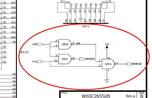

Well... Reorganized the board. Put away the big switch away so I will power the board just with USB by now.
Removed CLK fixed capacitors and rewired the circuit to a 14 dip socket where I can put in and pull off variable capacitors, so I don't need to desolder and resolder them just to change the trimmer and measure it.
By doing this, I got the board working at 3.3V stable so I can move to the next thing that is putting the EEPROM socket.
I will follow the w65c265SXB schematics, that uses a NAND logic gate to accomplish that.

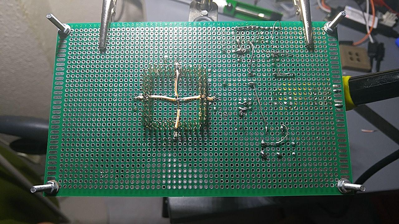

Well, I don't know if what I've done has in fact worsened my circuit, but here it is:
I took all the pins of IDE ports of an old Pentium 4 motherboard and soldered them along the small pins of the PLCC adapter the '265s was into.
And I'm reworking all as you suggested. I'll try to get a wire wrapper so I can do the next connections that way. I will remove and place back the clock circuits, next to the '265s. And I will also put a small FTDI board I ordered, so I will have a fixed serial converter there.

I will stop today here:
I don't know if having VDD in one side and VSS in the opposite one, will make things better or worse. Maybe it will make putting clock, reset or serial circuits more difficult to replace...
PostPosted: Tue Jun 23, 2020 11:59 am
That's looking a lot better. But I hope you get some wire-wrap wire or other fine gauge wire soon, because I think you'll find it easier to work with.
It's OK to solder wire-wrap wire, BTW. Stripping off the insulation can be tricky, but you'll figure it out. When you buy a spool of WW wire there's usually a little stripping tool in the housing for the spool. Sometimes I use the tip of a hot soldering iron instead -- I just melt a nick in the insulation then pull it off with my fingernails or whatever.
In the photo, the arrow suggests (approximately) where you could attach the oscillator capacitors. I would relocate them so they're right next to the '265, ideally with one lead of each cap going directly (no intervening connection) to the appropriate pin on the '265.
And I'll bet you can use the values stated on the schematic -- no need for variable caps. Good luck!

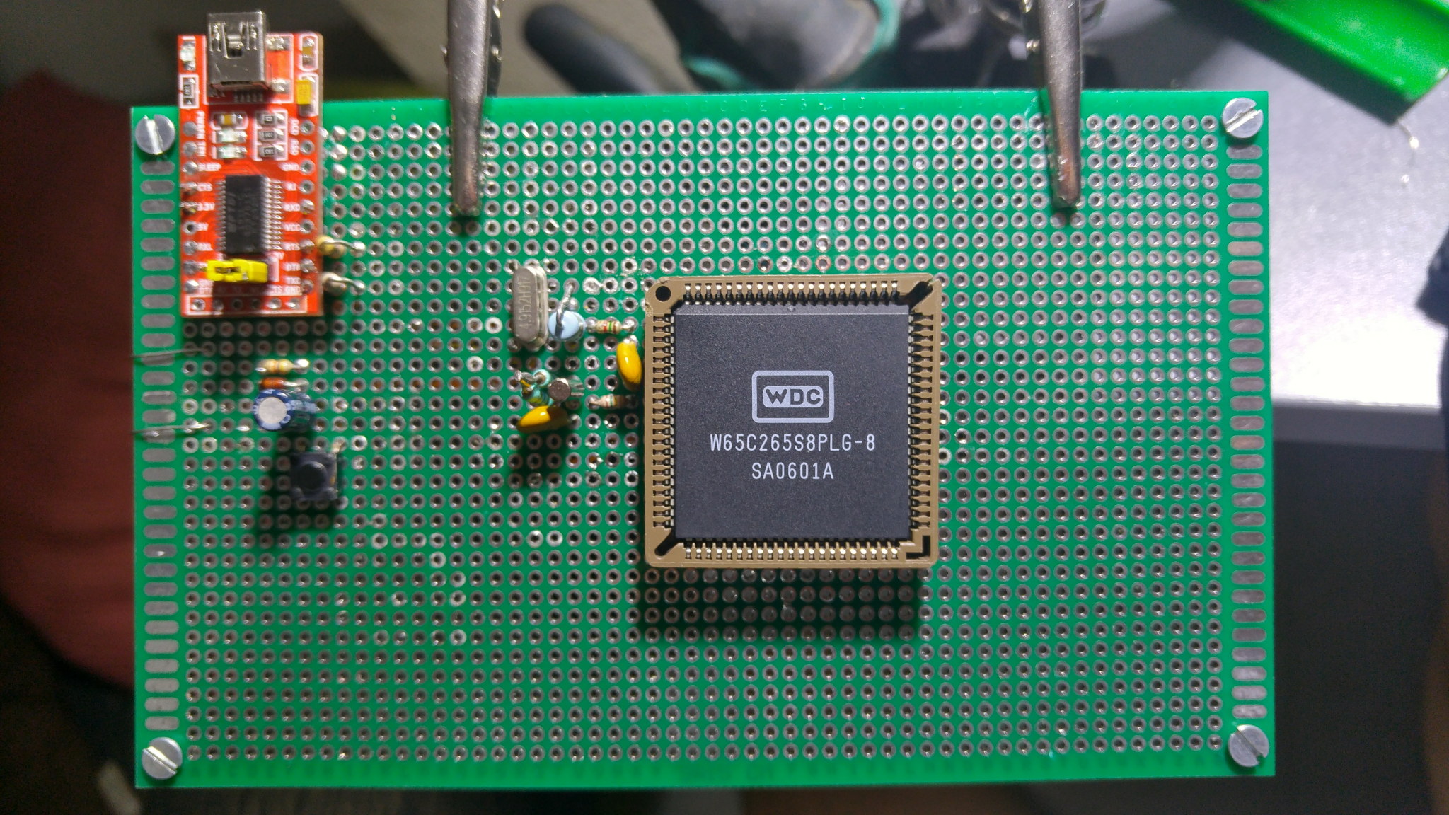

UPDATE:
AS suggested, I reworked the entire board. Well... the '265 is still in the same place. =D =D =D
I put a fixed FT232RL based daughter board to both power the board and interface the CPU. It seems that I could Fclock the CPU with it, because it can output a 6 Mhz clock in one of its pins, removing the need of a second crystal chip in the board. I have yet to test that way.
The bottom has now the capacitors under the main chip, and also the BE resistor directly soldered to the BE pin. I used a cross shape for the VDD supply, and a square shape for the VSS supply. I'm pretty sure this can be improved and in fact I will have to do it because...
