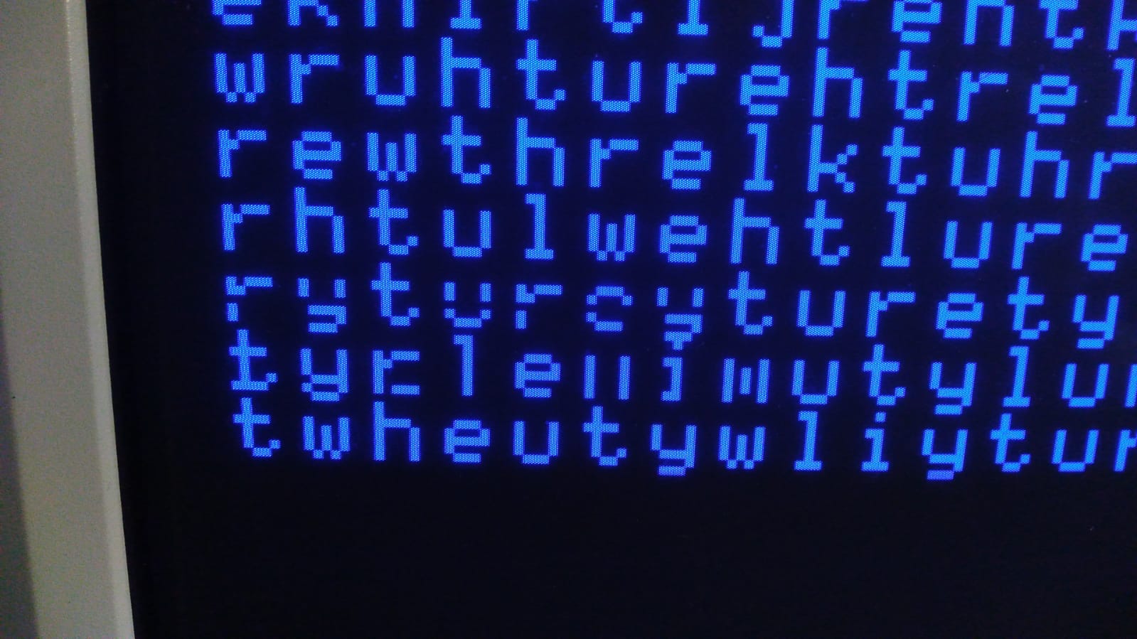

I wasn't too keen on the microcode thing either. Yes pixels did change from light to dark (rarely so). See attached, when scrolling the screen with something in it, some dark lines also appear. More on this below.
Proxy wrote:
tests could be done to fill the entire screen memory with 1's and then scroll around or specifically write to those bad regions to see what happens.
I made two scrolling subroutines, one that filled the last row with 0s (blank) and the other one with ones (light). I fount that no errors were made when filling the last row with ones. Screen just turned blue, and no dark lines appeared.
I tried re-locating the video card on a different address, but it made no difference. Now it is on it's original address.
So here is what I found. Turns out that my LCD, which is connected directly to the data bus, doesn't fully leave its bus in high impedance when inactive, but has some pull-ups always active. This may explain why turning 0s into 1s is more common than turning 1s into 0s.
Also, the data bus is going from the CPU to the memory card and video card, and from the memory card to the LCD, by a not so short ribbon cable, as can be seen on the photo I posted earlier.
Removing the LCD and the ribbon does make mistakes less frequent, even running at the intended 5 V. So I'm doing away with the LCD. It makes no sense to use it having the video card. I've read advice on not running CPU's buses off the board. Even if this is a "slow" computer, and the CPU is three boards already, it may make a difference.
Adding some more ground wires between the CPU and the memory card seems to eliminate errors completely. It seems that the couple ground wires in the IDE cable, pus the power cables on the back are not enough. So I think I'm just going to add some copper tape to the IDE cable and have it connect the grounds of both bays. Shortening the IDE cable is out of question (I've tried...).
All this makes making a SBC with some 65C816's I've got around even more appealing...

Sounds like a classic case of ground bounce, possibly combined with a mild instance of signal reflection and/or crosstalk. The result is that the write strobe gets briefly activated when it shouldn't be, and that sends whatever happens to be on the data bus at that moment to wherever happens to be on the address bus at that moment.
Indeed. And there is some crosstalk for sure. Running tens of wires close together on a tight space doesn't help much. Signals look reasonably clean on the scope, but there's always the ocasional spike and such. I've also caught a "runt pulse" on the data lines, but happens when no one is actually driving the bus, and adding pull down resistors kills it.

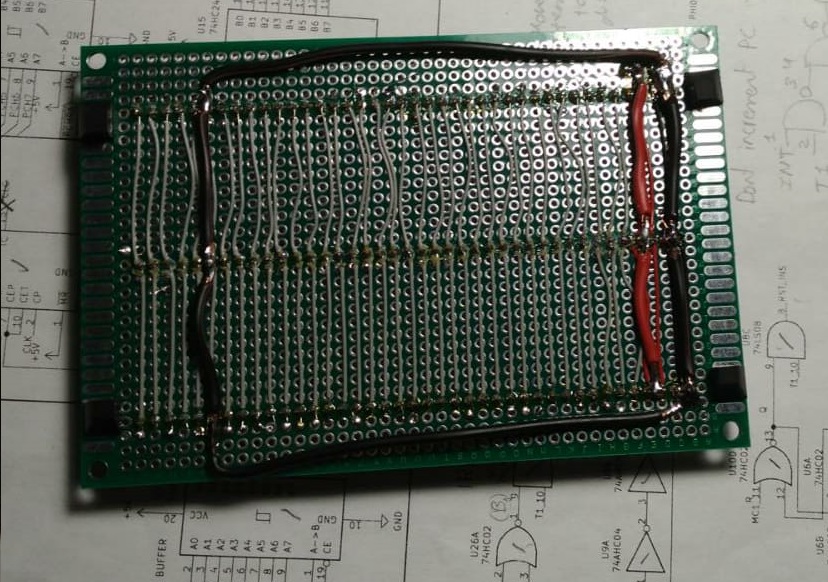

I've added the copper foil as can be seen below. Its just a test, I can peel it off anytime. Adding it does make "scrolling errors" disappear.
The IDE cable follows the pinout of a 6502. I've just realized that I have some unused pins: of the 3 NC, I'm using one for the "Valid address", and SO is free too as I'm not implementing it. These are reasonably close to the clock pins, and the R/W line. So I will be wiring those to ground. They won't be side to side, but one conductor apart. R/W line is already right next to VCC.
There was other error that became more frequent, the Interrupt disable flag would just remain 1 after exiting the ISR. Probing with the logic analyzer, I found that it changed when it shouldn't. Probing the flag prevented this from happening (My logic analyzer has an input impedance of 100K), but probing it with the scope didn't make a difference. I added thicker power and ground wires to the backplane and problem solved. I also had a couple unused pins on the CPU bus, and I connected one of them to ground too. This way cards have ground connections on both sides.[These two unused pins were reserved should I need to implement the b flag, which is not there, I don't know if I will need it any time soon. Should be able to do it with the remaining one.].
Later, I added a thick ground wire on the perimeter of each of the CPU cards. Not sure if id actually does something, but it doesn't hurt.
Next (and hopefully last) issue is that it randomly resets itself, but only when typing on the keyboard. I thought it was a software issue, but after some measurements I now think it's a hardware thing. Needs further investigation.
Juan

About terminations: refer to my recent post at viewtopic.php?p=76261#p76261 .  There are no transmission lines in your pictures though, so resistor terminations will probably not do any good.  Diode terminations could help, but fast-enough ones are rare.  The tiny static-protection diodes at the inputs of CMOS logic will provide some protection from overshoot though.
Something that's much, much better than a thick ground wire around the outside (which is what I think I'm seeing in your pictures) is to have a grid of power and ground wires.  Remember that even a plain wire has inductance, and even doubling or tripling the wire size has very little effect on that inductance; so you want to keep the power and ground connections from one IC to another as short as you can.  That includes not requiring a signal's return current to go out to the edge of the board and way around to cut in somewhere else, if a 1" piece of wire between the ICs could have made the same connection.  See the links at the bottom of the AC-performance page of the 6502 primer, at http://wilsonminesco.com/6502primer/construction.html .

Something that's much, much better than a thick ground wire around the outside (which is what I think I'm seeing in your pictures) is to have a grid of power and ground wires. Remember that even a plain wire has inductance, and even doubling or tripling the wire size has very little effect on that inductance; so you want to keep the power and ground connections from one IC to another as short as you can. That includes not requiring a signal's return current to go out to the edge of the board and way around to cut in somewhere else, if a 1" piece of wire between the ICs could have made the same connection. See the links at the bottom of the AC-performance page of the 6502 primer, at http://wilsonminesco.com/6502primer/construction.html .[/color]
There is a grid of power and ground wires on each card as well. It's wired with regular wire-wrapping wire, and can be seen on the photo above. I just added that thicker wire on top to see if it helped, maybe the LEDs were causing some voltage drop on GND. It did make a difference on the power rails on the backplane. Voltage drop may be more of an issue there.

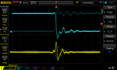

Some updates:
A couple measurements with the logic analyzer confirm that reset happens either after an RTS or an RTI, so its due to errors getting the return address back from the stack. Here are some scope screenshots of the signals that I'm observing. Using the probe's ground lead or the low-inductance-ground-springy-thing (scope probe accessory) makes little difference.
As it can be seen, address lines do have a shorter rise time and that causes ringing and what not. Data lines are better behaved, which is curious, as data lines are driven by a 74HC245, which is supposed to have greater driving capability than the 74HC377 that drives address lines. I don't know if this directly influences errors on reads/writes, but it may very well be.
Using Schottky diode termination seems to work. I don't have enough diodes for all lines, some more are on the way. But maybe I could just add some series resistors on the address lines (CPU side) so together with the bus capacitance they slow down those edges. I've solved crosstalk on slow signals with fast edges that way before.
EDIT: Clarification.
Juan
File comment: Slower rise time. Signals look nice and clean. Driven by 74HC245
File comment: Faster rise time. Overshoot and undershoot. Driven by 74HC377
File comment: Using the ground springy thing.
File comment: Adding a schottky diode to ground reduces undershoot. Using the ground springy thing.
File comment: Not sure if the blue trace causes the yellow one, but nasty stuff.
On the '245 (unlike the '377) the rise/fall time of the outputs will to some extent depend on the rise/fall time of the inputs -- perhaps they, too, are fairly slow. And is the capacitive loading on the 377 comparable to that on the 245?
I'm not sure what you're referring to when you mention the "ground springy thing." Is that the copper foil you applied to the ribbon cable?
