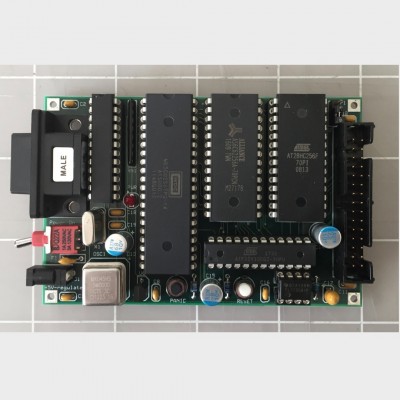

I used an ATF22V10CQZ in my recent C02 Pocket SBC for a single glue logic chip. It provides selects for EEPROM and RAM, 5-I/O selects that are 32-bytes wide and PH2 qualified memory read and write lines. This was my first ever use of single glue logic, and I'm very happy with it. I have a Dataman 40Pro programmer which supports the Atmel devices, so erasing, programming and verifying is trivial.
