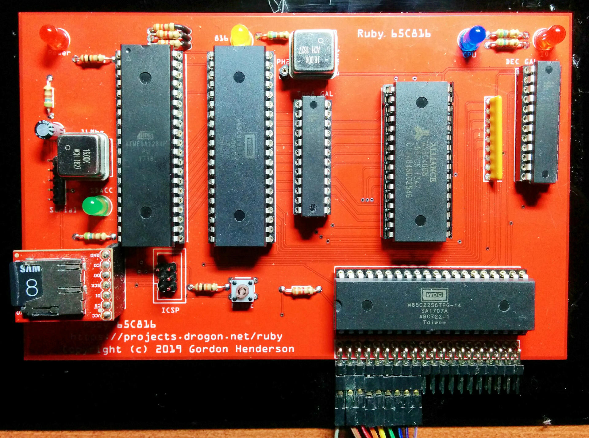

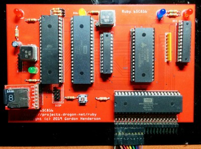

Description of the 6502 board: https://projects.drogon.net/6502-ruby/
Picture of the '816 board:
I buy Lattice parts from China - they're all board pulls that have (probably) been programmed just once (from what I can tell anyway). I've not had any issues - they're all worked for me, but it's possible I got lucky. I use a Genius G540 programmer off a WinXP Laptop, but I use something called GALasm running under Linux to generate the JED files.
I did buy a Minipro programmer, but (a) an early one and (b) turned out to be a "clone" and it won't program them. I'm told the next (current) version will program them and the still in-production Atmel (Microchip) ATL22V10 versions - I bought some of them new, but neither my old programmer nor the G540 will program them. (Currently I'm loath to buy another programmer, but I may in future)
If you can program them, then unless you want to be totally authentic to some historical design then spend the money and run! There is a fine-line between the purist retro and something a little newer though, but we had one time (mask) programmable logic chips in the late 70's/early 80's (ULAs) and user-programmable PALs in the early 80's too, so for me, it's retro enough, and is saving me 3-4 TTL chips and they enabled me to get my boards running code more or less immediately.
(edit to add photo+link)

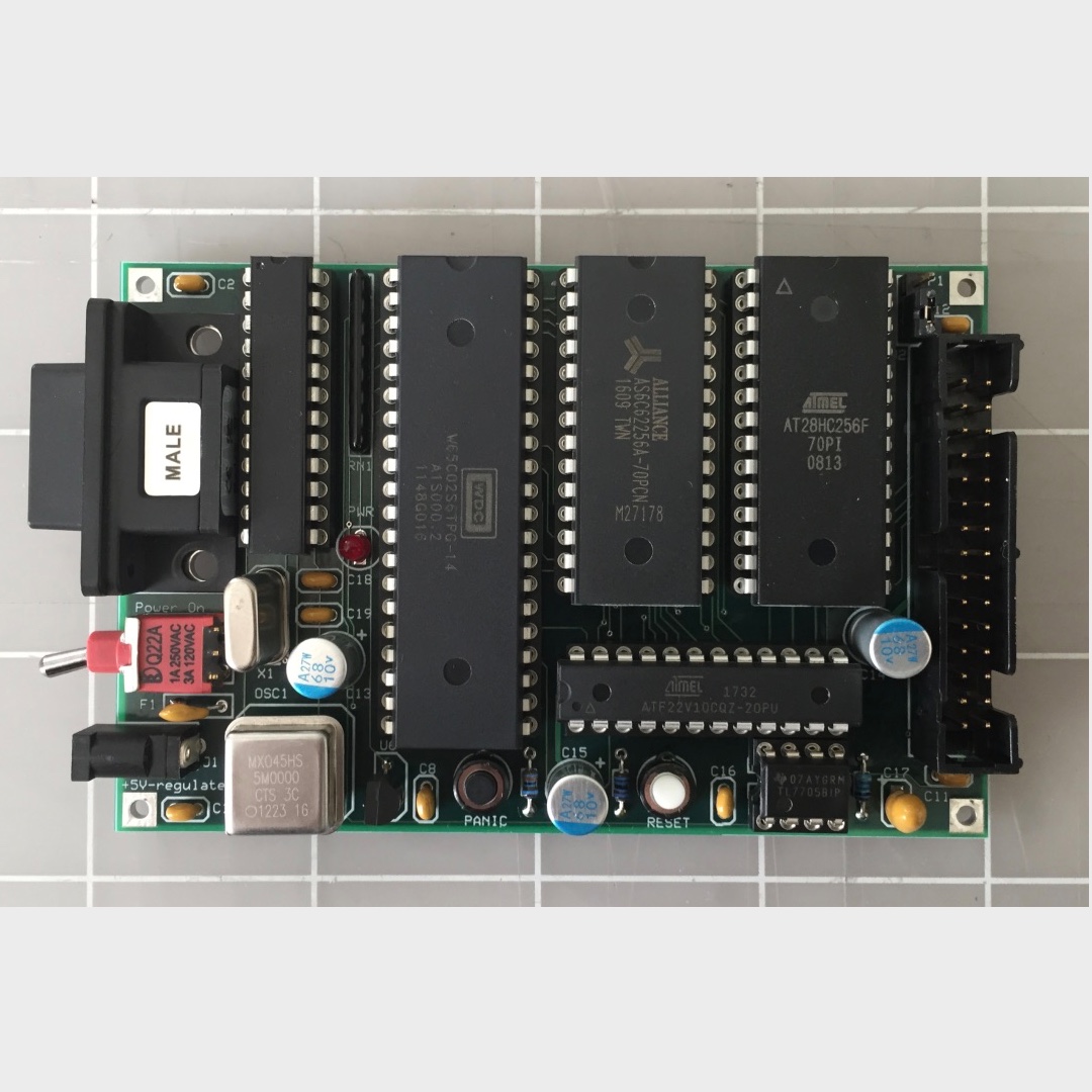

I used an ATF22V10CQZ in my recent C02 Pocket SBC for a single glue logic chip. It provides selects for EEPROM and RAM, 5-I/O selects that are 32-bytes wide and PH2 qualified memory read and write lines. This was my first ever use of single glue logic, and I'm very happy with it. I have a Dataman 40Pro programmer which supports the Atmel devices, so erasing, programming and verifying is trivial.
