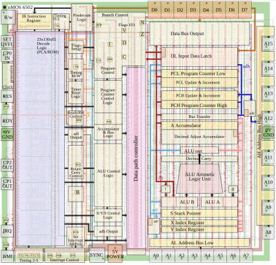

I created an svg circuit diagram of the 6502 which is now available (in a first draft) at https://davidmjc.github.io/6502/cd.svg. This is based primarily on the circuit diagram by Balazs Beregnyei (of which it is a derivative work, by permission) but I also made use of BreakNES and the Visual 6502. Although I don't think it qualifies as a derivative work of either of the latter, I chose the license cc-by-sa for maximum compatibility.
Disclaimer: this is not a 100% faithful representation of the 6502 circuit. I fell into this project in stages and made several questionable design decisions along the way. In particular, my goal was not fidelity, but understanding. My initial motivation was to understand the instruction decode of the 6502 as a fully fledged PLA, with both an AND and an OR plane (implemented as NOR-NOR in nmos logic): indeed a large part of the so-called "random logic" of the 6502 can be viewed as a space-optimized OR plane. However, to bring this out, I reordered a few PLA lines, and moved timing control lines for the read-modify-write cycle (which I call TA, TM and TW) into the PLA. This reduces the random logic considerably, and makes it easier (for me at least) to understand.
I have tried to lay out the circuit much like the original chip (with Hanson orientation, i.e., PLA on the left, data path on the right) but circuit diagrams and silicon chips have somewhat different constraints, so many compromises were necessary. Nevertheless I found the iconic layout of the 6502 quite inspirational for drawing this circuit diagram. My diagram likely contains many errors, as I found many along the process of creating it. Some of these errors are deliberate (e.g. using the same circuit for both halves of the decimal half carry which the 6502 does not). However, modulo these issues, I would like to think my diagram is still 99.9% faithful to the original 6502 circuit, and maybe 95% like the original layout!
One of my main motivations for releasing it under a free license is so that other 6502 enthusiasts can go back and fix my errors and dubious design decisions (e.g., by producing a completely faithful representation of the original 6502). I would be happy to be more specific about changes I made to anyone interested (although sadly I did not keep notes - my biggest regret).
The svg has some interactivity in a suitable browser (you can mouse-over or click on nmos circuits), but this is not completely developed in this draft. I would welcome comments and suggestions for features to add (or links to your own additions based on this freely licensed work!).

As suggested above, I have now produced a version of the circuit diagram with a block diagram overlay. In a suitable browser the overlay can be switched off (or on again) by clicking on the title. It can be found at https://davidmjc.github.io/6502/bcd.svg.
Any suggestions for other improvements/bells-and-whistles are welcome!

 Post subject: Re: 6502 svg schematic
PostPosted: Mon May 18, 2020 8:14 pm
Very nice indeed! Here's a screenshot:

Thanks. Note that in the screenshot, the fonts have not been rendered correctly (this is probably a browser-dependent issue). Also you can click on the black squares next to the title to get more text detail (not a great user interface at present, I admit!).

PostPosted: Tue May 19, 2020 7:11 am
Wow - thanks for the tip on the black squares. I think that makes for 4 different views of the various layers. There really is a lot of annotation here - and tooltips too, and highlighting of nets.
I've added a github issue for a few things I've noticed.

Thanks. I made those fixes. It looks like the font issue is not about the browser, but whether the font is installed by the OS. The font in question is Latin Modern Mono Caps. I could include the font specification in the svg or convert the text to paths, but both solutions would increase the size of the svg, which I have been trying to keep small. A perhaps nicer solution would be to get the browser to download the font from the internet, but I haven't figured out how to do this.
Concerning features, it would be easy enough to add buttons to switch other layers off or on, but maybe it would get a bit complicated (unless it was just in an "advanced" mode a la visual 6502!).
