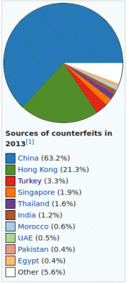

If it's true, that would be be marvelous! Do they really have 10,000 real ones in stock?? It's in China, so it is suspect, because of all the fakes that have been coming out of there. According to this pie chart from Wikipedia, China produces nearly twice as many counterfeit products as all other countries combined:
It might be worth buying two or three, testing them, and if they prove to be legitimate 65802's buy more, and if it still looks good, buy a load of them to keep for people here and other 6502 forums.
