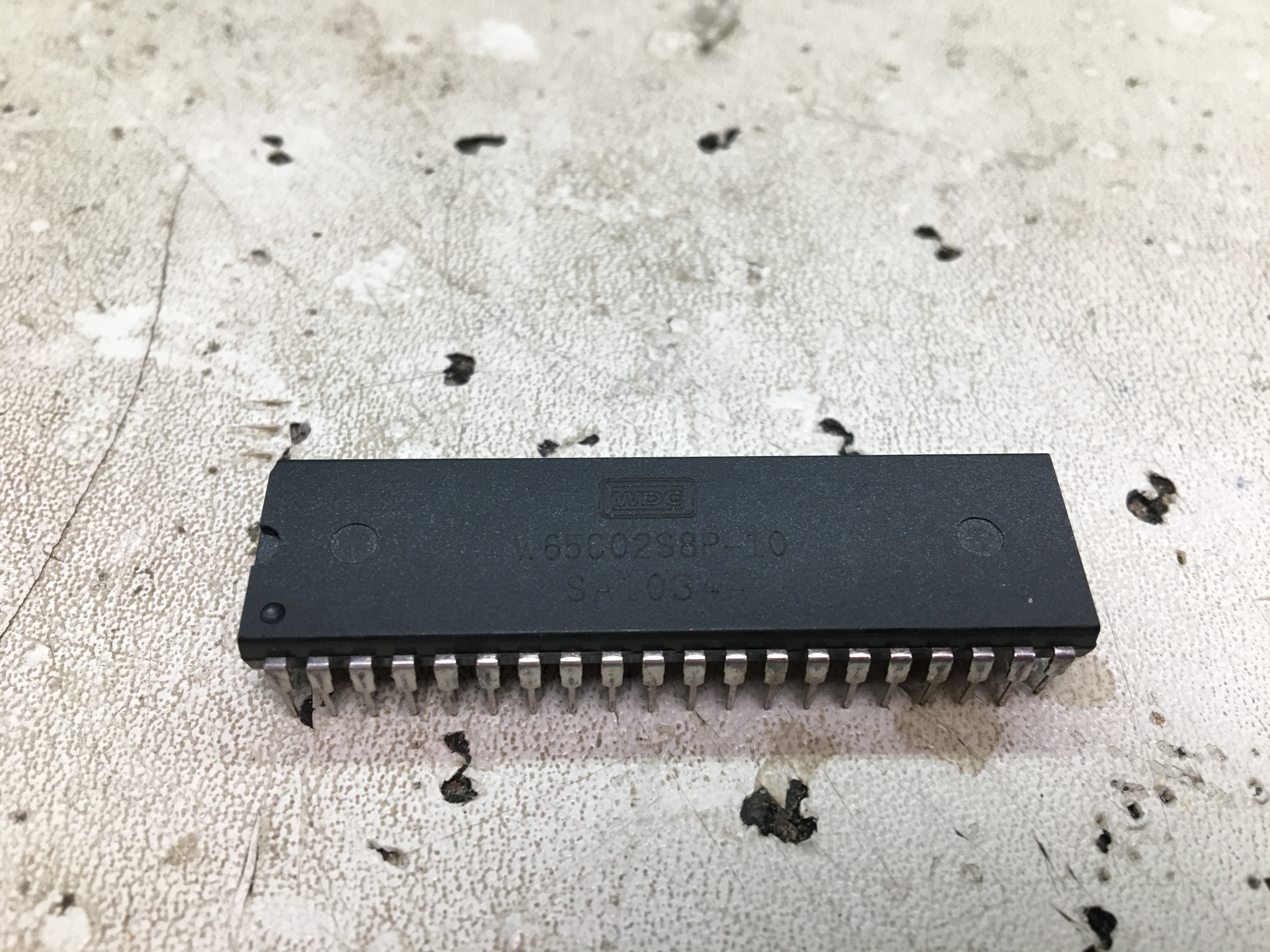

Pics of the chips as requested, don't appear to be any date codes.....
hope this helps...

PostPosted: Sat Feb 08, 2020 3:30 pm
Okay, in the second line of text, the date code is 1034, which means the 34th week of 2010. This is obviously wrong for the part number. Sometimes these date codes correspond to the date the chip was reprinted by the recycler, but I find it hard to believe that it's been sitting around in China for a decade.
The printing itself is also suspect. Normally white silkscreen is used on PDIP packages, but this appears to be almost black, and might even be stamped or engraved rather than printed on the surface.

Definitely a fake. If the date code were valid it would be a -14 part made to the .6µm process.
Also, as Chromatix noted, genuine WDC parts are white silkscreened. They've been that way since at least the latter 1980s.
