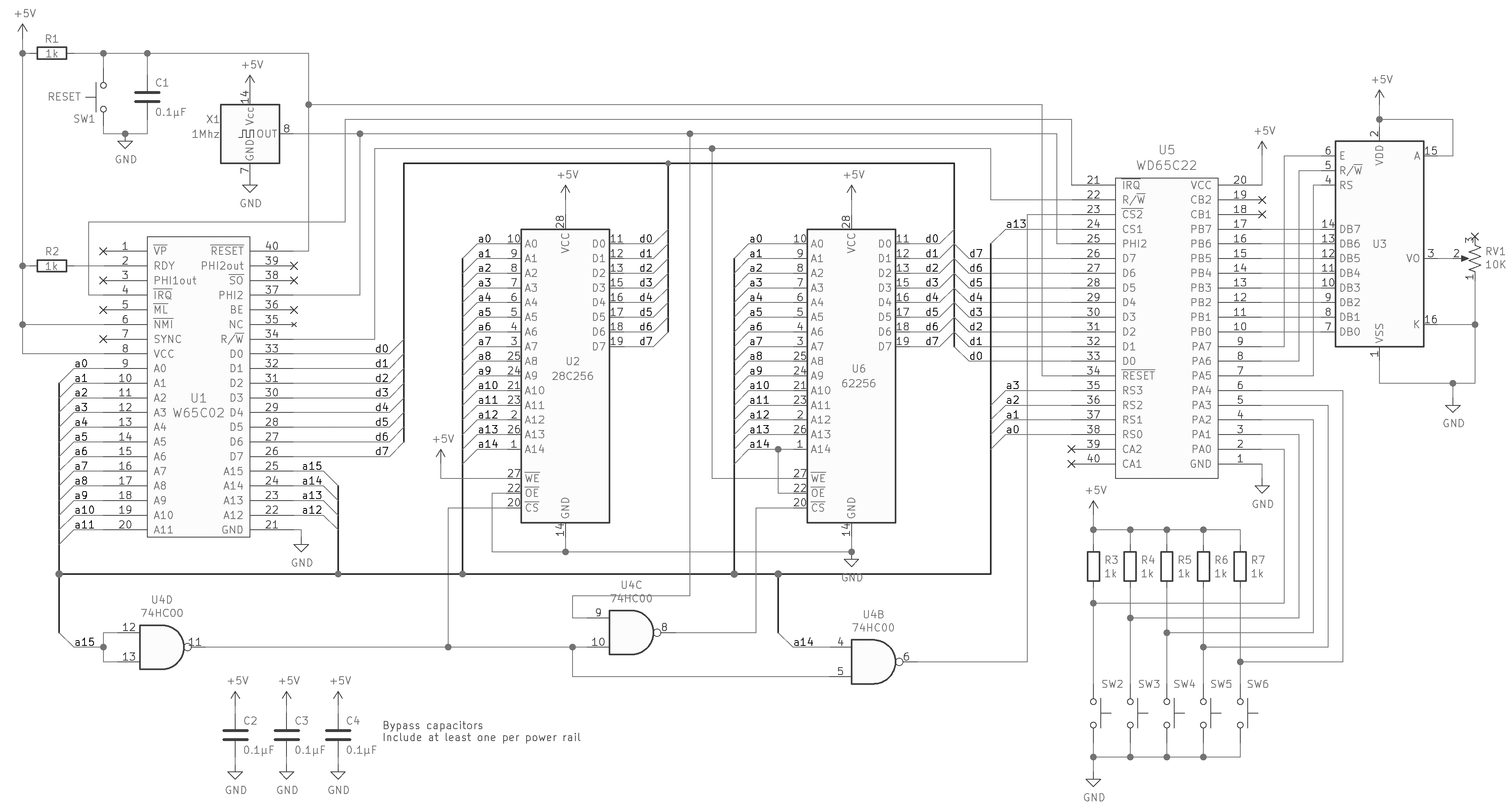

Hi All, like a number of you guys, I am also playing along to Ben Eaters excellent series on the 6502. I have it created and working on a breadboard with the LCD displaying "Hello World!"... so far so good. So keen have I been to keep going, I have also added the SRAM chip and wired in accordance with his Schematic (hopefully attached below..), and have verified that ALL signals go to the right places and are wired correctly. BUT, with his new code to use a Subroutine to do the Reading and writing of the Data to the 6522 VIA, this code doesnt work. It would seem that Data ISNT being written to the SRAM... (I have "tested" the SRAM in the EEPROM Programmer, TL866 II Plus, and it reports no issues. This post is already getting too long, so currently I am trying to TRoubleshoot the signals are working in the right order and at the right time, BUT, when using my Scope to monitor the Chip Select signals and the OE signals, all works fine, but when using it to Monitor the R/W line, it is permanently LOW (According to the scope..) and doesnt change, apart from a few VERY short Spikes every now and then (Assuming its when the CPU is trying to Raise the line for a READ....) Its all VERY odd, as the code that drives the LCD is working fine when using Ben's LONG version of code (IE everything is done, In-line repeteively, no SUbroutine jumps), which I am assuming has to Read and write to the VIA chip.... Even disconnecting the R/W line from EVERYTHING, and letting the code simply run, I cant see the R/W line going up and down ?
Should I be able to see this line going up and down? If so, during a Write cycle, what sort of "pulse width" should I see? I am beggining the think I have a dead R/W line on the WDC 65C02 chip... but would welcome anyones comments and suggestions. I have a couple of new chips on order from Mouser, but its driving me crazy (although I am learning a HUGE ammount, so very heppy :D )
Forgot to mention, the Clock source shown in this schematic ISNT the one I'm using, I am using Ben's 555 based clock generator with the Single Step feature... AND, I have tried a 2nd CPU that I ordered from the same source, and that behaves in the same way... I have read all the stuff about dodgy chips etc etc....

Welcome.
I see lots of potential problem sources. Go through the 6502 primer at http://wilsonminesco.com/6502primer/ . It addresses all of them. (The 6502 primer is apparently where Ben got his address-decoding scheme; but he ignores a lot of the other things there.)

I had a hard time reading your schematic due to it being in color, but did see what I thought are couple of things that could be giving you some grief. Can you please re-post the schematic in monochrome?
Also, it's helpful to break up your text into paragraphs to make it easier to read.

Re-posting the Schematic in Mono as requested....

Getting back to your circuit, you need to pull the MPU's BE and SO inputs up to Vcc—CMOS inputs, as a rule, should not be allowed to float. Also, change R2 from 1K to 3.3K. RDY on the WDC 65C02 is bidirectional—the MPU will attempt to drive it low if a WAI instruction (opcode) $CB) is executed, intentionally or otherwise. A higher resistor value will limit the amount of current drawn by RDY when driven low to a safe level, while not making the input too noise-sensitive.
Assuming you are using a W65C22S, your IRQ circuit is okay. If you are using the W65C22N you must pull IRQ up to Vcc, as the 'C22N has an open-drain IRQ output. 3.3K is a customary value for the pullup resistor.
Your hookup to the SRAM is not good. /CS should not be qualified by the Ø2 clock—the address bus becomes valid about midway through Ø2 low. However, the SRAM's /WE does need to be qualified by Ø2 to prevent a wild write during the time when the address bus is settling. For best results, /OE of both the SRAM and the EEPROM should also be qualified by Ø2 to avoid possible glitching as the MPU sets up the address bus and other signals.
You may run into some trouble with your reset circuit at power-on. Many can oscillators require tens of milliseconds to start oscillating and stabilize. The short time-constant of your reset circuit may cause the MPU to come out of reset before Vcc is fully settled and a stable Ø2 clock signal is available. Lacking a stable Ø2 signal after coming out of reset, the MPU will likely play possum. Although it adds a little cost to the circuit, a Maxim DS1813 reset controller (or something similar) will hold reset down for about 150ms after Vcc has stabilized.
You don't have enough bypass capacitors nor are you correctly using them. Bypass capacitors should be used at each active device, with the capacitor connections as short and direct as possible to the device being bypassed. Merely bypassing across the power supply rails will do little for you.

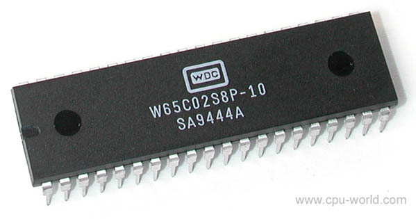

PostPosted: Sat Feb 08, 2020 3:30 pm
Okay, in the second line of text, the date code is 1034, which means the 34th week of 2010. This is obviously wrong for the part number. Sometimes these date codes correspond to the date the chip was reprinted by the recycler, but I find it hard to believe that it's been sitting around in China for a decade.
The printing itself is also suspect. Normally white silkscreen is used on PDIP packages, but this appears to be almost black, and might even be stamped or engraved rather than printed on the surface.
Here's a photo of a genuine WDC 10MHz part - note the date code from the 1990s, and the different orientation mouldings.
PostPosted: Sat Feb 08, 2020 8:29 pm
Posts: 8509
bellaf wrote:
Pics of the chips as requested, don't appear to be any date codes.....
hope this helps...
Definitely a fake. If the date code were valid it would be a -14 part made to the .6µm process.
Also, as Chromatix noted, genuine WDC parts are white silkscreened. They've been that way since at least the latter 1980s.
