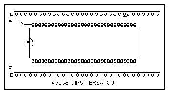

Since completing my SBC based on the 65C02. I've now starting work to design an Video adapter using the V9958 (as used in the MSX2 computer). I've done some web searches and it appear no one that I can find using V9958 with 6502.
My plan is to have V9958 using simple 1 or 2 SRAM chip with some latches to interface to the V9958 DRam interface. Any help or comment will be very much welcome.
As a start I've designed and produced a breakout board so that I can use 0.1" pinout configuration. I've attached the Gerber file in case if anyone else would like to get the PCB make.

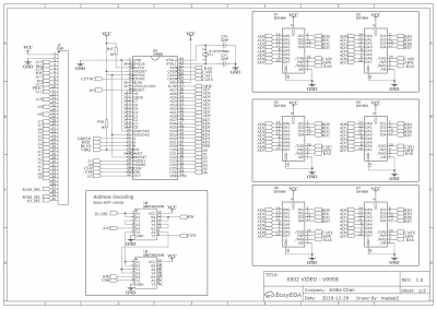

hi all,
I've done more research and have put a design together using DRAM for now (planned to use SRAM in the future). The design will have 192KB vram and a VGA output.
Any comment or advise will be most welcome.

I'm not seeing a lot of connections. Are some of the lines blue?
PostPosted: Sun Feb 09, 2020 7:41 am
Yes, most of the markings are blue. I've attached a converted version, though I'm not sure how well a two-page document works as a PNG.
You really should find yourself a way to display things as monochrome. Blue should turn out as a dark grey.

I've attached black & white version of the the pdf document for better viewing.
thanks,
eddie

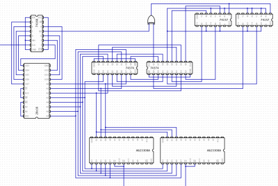

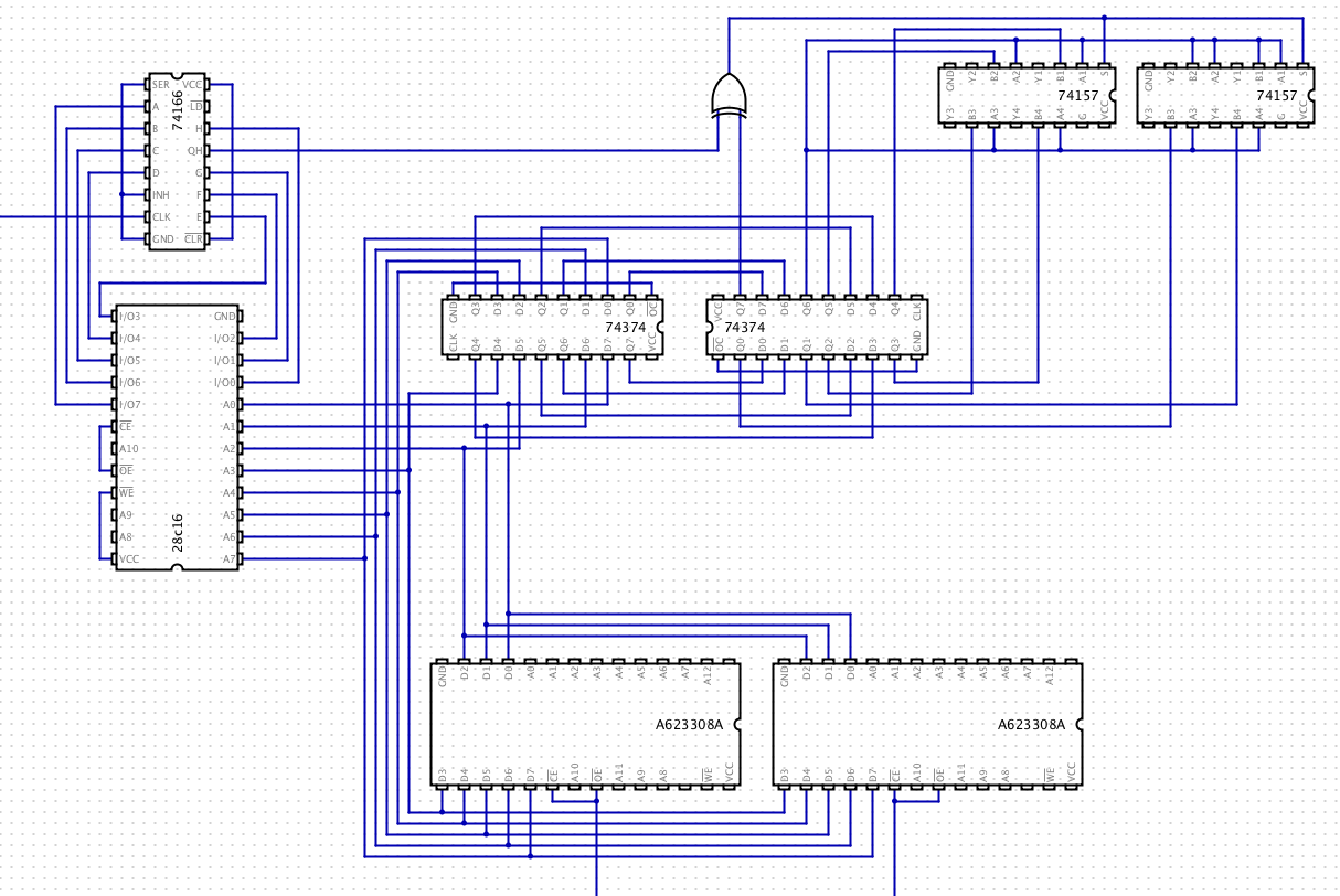

The distinction between logical and physical pin layout can be debated. To illustrate one extreme, why don't you try to figure out, at a glance, what the attached circuit (sketched the other day in Digital) is supposed to do?
PostPosted: Mon Feb 10, 2020 2:04 am
Posts: 8514
I can't read it.
PostPosted: Mon Feb 10, 2020 10:57 am
The point is, the diagram shows the various chips as DIP packages, labelled only with their part numbers. Unless you're a walking parts catalogue, you won't know which ones are RAM, ROM, shift registers, latches, or multiplexers - the only immediately identifiable component is the XOR gate, which is meaningless without context. Maybe you could guess some of them by looking at the pin labels, but that's a very inexact science. And because of the physical pin layout, routing the signals is especially awkward visually.
KiCad's symbols are usually more logically oriented, though they're still based on a particular physical product. This means you can efficiently use it to design a logic system, rather than merely simulating an existing one. Unfortunately, it then lacks the simulation part entirely, so it's much harder to check your work without actually building it.

I'm wondering if this will work. Doesn't it require 128KB of VRAM and 64KB of DRAM? I've not gone through the entire spec sheet, but it seems VRAM needs separate data in and data out buses at least, or am I out to lunch? I've only seen this chip used with 4164 style DRAM which can be configured that way.
I'm most likely mistaken though, but willing to learn.
PostPosted: Thu Feb 13, 2020 5:50 am
Posts: 45
BillO wrote:
maded2 wrote:
hi all,
thanks,
eddie
thanks for taking time to look over my design. I am also learning on the go as well.
As far as I've worked out from my research, V9958 required minimum of 128kX8 DRam (maximum 192kX8) to work. So currently I will use 6 x 64kX4 Dram. As far as I can tell it uses regular DRam only.
