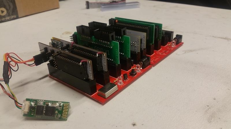

This is almost exactly how my SBC was designed and built. PCB was produced with clock and reset circuitry, everything else is on little cards connected by 50 pin edge connectors.
Also by not populating certain components I was able to daisy chain two backplanes together for 8 available slots.
The contraption runs stable at 4mhz for weeks or months at a time.
EDIT: Sorry for the giant image, copy/pasted the linked (raw) image from my gallery instead of the normal sizes image.

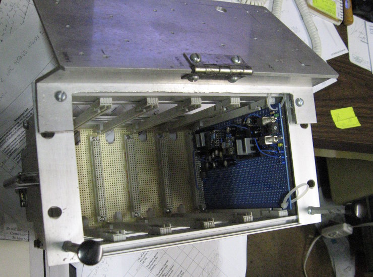

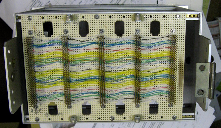

I did a 4 slot, hand wired, backplane for my Acorn Atom project details & pictures are on the forum at:viewtopic.php?f=3&t=5728
it's currently running with a 10mhz clock.

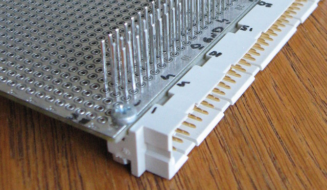

I think that DIN 41612 looks a lot more promising, if one's going to go for a "real" connector. It's on 0.1" centers, and so goes straight into protoboard, it's got KiCAD footprints available (at least for the 2-row versions), and it seems fairly cheap (2×32 is under $2/connector on AliExpress). I notice that the 3×32 version of the connector is used for the RetroBrew (ex-N8VEM) ECB (EuroCard Bus); they provide CAD files for a nice little 3-slot passive backplane.
Agreed. The following pictures show it in wire-wrap, but soldertail is of course available too, and less expensive.
