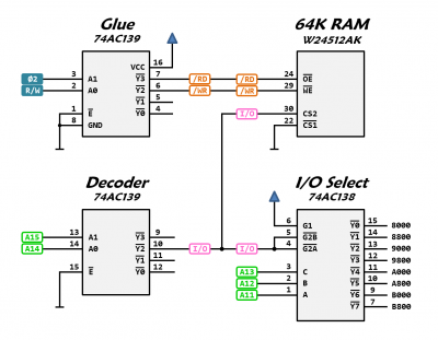

PostPosted: Sat Jan 18, 2020 2:36 am
Posts: 589
Hi, dani. If I may... an example decoder method for a 64K RAM system (using a 64K or 128K SRAM chip)...
Good luck on your project. Cheerful regards, Mike, K8LH

@Mike, of course you may, all help is appreciated, even though any new idea sparks a new tree of posibilities, with the risk of making me go crazy :)
I'm pretty sure I've seen that image before, most likely in this same forum. I like it's simplicity, and I can't think of many ways to get a faster propagation delay to RAM.
I've managed to combine some ideas from you both into this:
MEMCE propagation delay goes down to a mere 8.5 ns max(6.5 typ, 3 min!)
Peripherals enable gets the same 22~ ns as before.
By using a RAM chip with to enable inputs, I can let the address decoder handle one, the arduino the other, so I save 3 gates needed to mux both signals. Same number of ICs though, but routing is going to be much much nicer.
I've found 128k, 12ns RAM ICs on mouser that should be a good choice.
Once I double check this new version. I'll update the initial posts.
Edit: Corrected the order of pins 14/13 on IC2B, as correctly pointed by Mike in the next post.
PostPosted: Sat Jan 18, 2020 4:18 pm
Posts: 589
Looks good but I think you may have the inputs on IC2B reversed...
This "Bus Enable" Boot Loader interface method requires controlling a whole bunch of pins and will only work with a WDC part, yes, no?
