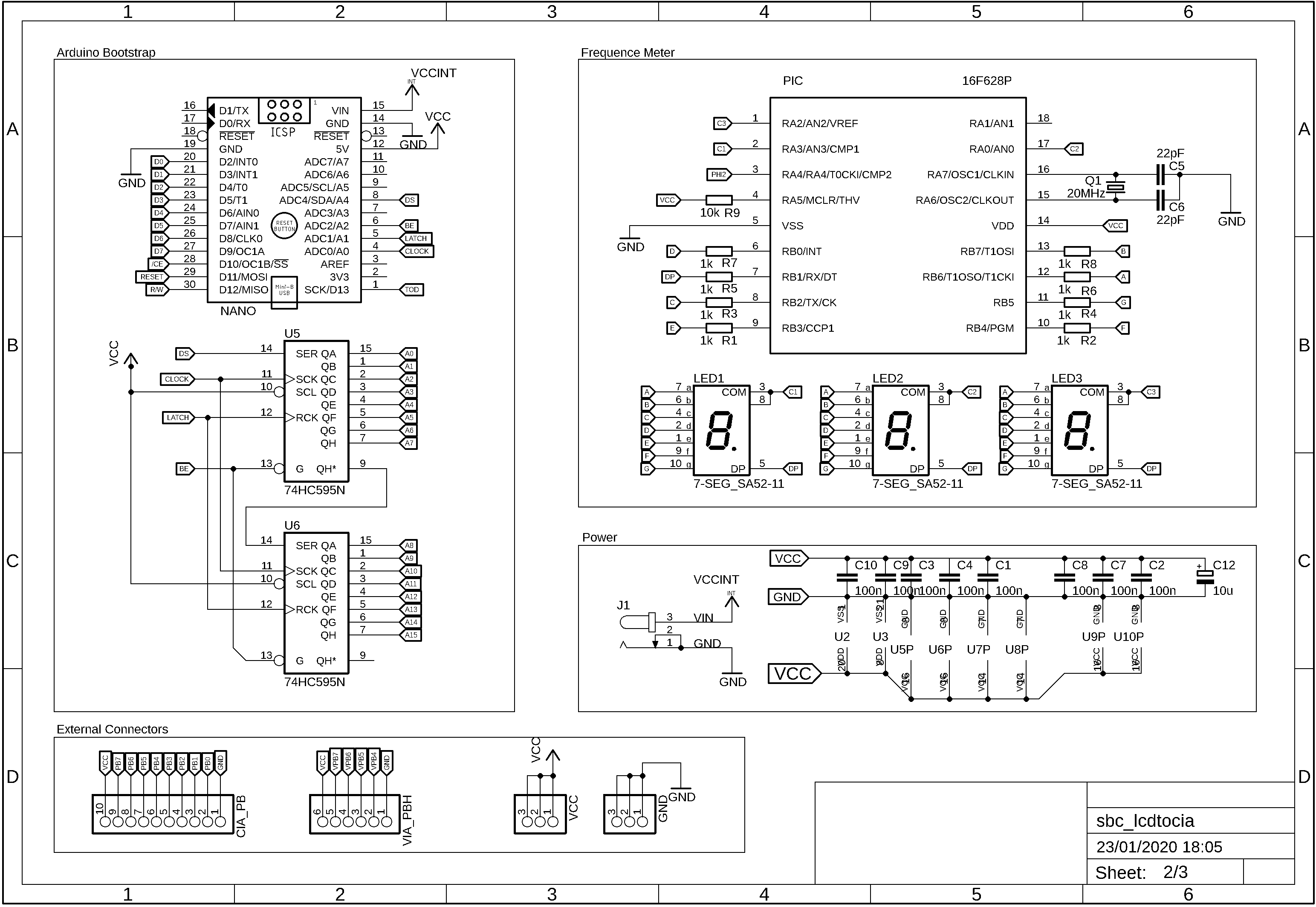

Second post. I'll use this as a place holder for the schematics. I'll be updating the post as I make changes.
Nov'20 Edit:
After quite a long time without working on this... I'm starting to catch up again. I've reworked the whole SBC to fix some issues I had.. A few pull-ups missing... some errors in placement... I've also taken this oportunity to finally move away from Eagle, so the SBC6526 is now created using KiCAD.
Here are the new schematics for it, much much cleaner than it was:
sbc6526.pdf [427.72 KiB]
Downloaded 74 times
I'm keeping here the old schematics, as a reference.
SCHEMATICS
Core
CPU, RAM (128KB), 6522 and 6526, and LCD Display.
MemDecoder, Reset and Clock
Arduino bootstrap and Frequency meter

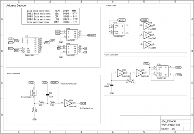

Hi Dani,
I suspect you might be able to simplify address decoding by modifying your memory map slightly. Any reason why you can’t keep RAM to the lower 32k? If so, then /MEM = /A15 and the ‘138 can decode addresses for I/O devices in the upper 32k (with A15 tied to the G1 pin of the ‘138).
Also, you can probably also make LCDE = /(IC8.15 + PHI1). (PHI1 is already generated by your clock divider circuit at the /Q pin of the clock divider flip-flop). Finally, you may want to use gates rather than tristate buffers to avoid transient collisions on /MEMCE. With the simplified memory map /MEMCE = (/A15 + PHI1 + /BE) * (/CE + BE).
Drass
EDIT: Corrected LCDE above.
PostPosted: Fri Jan 17, 2020 10:45 pm
Posts: 193
Location: Madrid, Spain
Hi Drass. Thanks for your tips. In some form or another, they've crossed my mind at some point. Being my first attempt at a SBC, and being so early in the design process (No more than two weeks) I still have a lot of "ifs" and I may change nothing, I may change everything.
To save on chip count, simplify layout, and get rid of the hassle of EEPROM programing over and over, I won't have any ROM on board, Just RAM. With the current memory map, I have the full 32K in 0000-7FFF, and the upper half on the RAM is mirrored at C000-FFFF. I need memory in the upper range of the address space for the reset/interrupt vectors. I've considered using a 128K SRAM, so memory at C000 won't be a mirror of 4000-7fff. PCB layout is easier (Although this won't affect address decoding). However, I'm finding it easier to locate faster 32K SRAM than 128K SRAM.
This was the original setup. The current design saves one IC, as I don't need a '32 and I had spare inverters and NAND gates. Anyway, propagation delay is longer and layout becomes a bit messier, despite of having one less IC, so I may try to squeeze one more IC on my board. Right now, I'm pretty sure LCD is the longest propagation delay in the system. (Ignoring of course anything inside my 74HCT6526!)
This one's really nice. I wan't too comfortable with those buffers. Somehow I was failing to combine /CE with /MEM... Now that I see it it's very obvious!
I'm now thinking I may not neet to generate /CE from Arduino at all. When I assert BE, a couple of '595 will be enabled and will drive the full address bus, so, /MEM will be enabled when reading/writing to RAM from Arduino except... It won't be in control of PHI2, so some writes/reads may go nowhere. I can work around this, by repeteadly writing/verifying each byte until it succedes. I won't be fast, but it only needs to be done once during startup...
Anyway... I'm a bit tired right now, so I may not be thinking straight :)

Hi, dani. If I may... an example decoder method for a 64K RAM system (using a 64K or 128K SRAM chip)...
Good luck on your project. Cheerful regards, Mike, K8LH

I totally agree. Don't have any IO pins free though to do that. The startup sequence is as follows
1.- Arduino releases BE and waits for a "RAM Image" from the host PC. Meanwhile, 6502 happily crashes while reading an "empty" memory
2.- Host PC starts to send the RAM Image to the Arduino. BE is asserted and, by using a couple of 74595 shift registers, RAM is accesed and writen to.
3.- When RAM is complete. Arduino resets the SBC, releases BE, and then releases Reset.
After that, the Arduino just sits there waiting for another programming cycle, if requested. It only generates a 50hz square wave to feed the TOD signal in the 6526.
@Mike, of course you may, all help is appreciated, even though any new idea sparks a new tree of posibilities, with the risk of making me go crazy :)
I'm pretty sure I've seen that image before, most likely in this same forum. I like it's simplicity, and I can't think of many ways to get a faster propagation delay to RAM.
I've managed to combine some ideas from you both into this:
MEMCE propagation delay goes down to a mere 8.5 ns max(6.5 typ, 3 min!)
Peripherals enable gets the same 22~ ns as before.
By using a RAM chip with to enable inputs, I can let the address decoder handle one, the arduino the other, so I save 3 gates needed to mux both signals. Same number of ICs though, but routing is going to be much much nicer.
I've found 128k, 12ns RAM ICs on mouser that should be a good choice.
Once I double check this new version. I'll update the initial posts.
Edit: Corrected the order of pins 14/13 on IC2B, as correctly pointed by Mike in the next post.
PostPosted: Sat Jan 18, 2020 4:18 pm
Posts: 589
Looks good but I think you may have the inputs on IC2B reversed...
This "Bus Enable" Boot Loader interface method requires controlling a whole bunch of pins and will only work with a WDC part, yes, no?

Regarding BE, yes, I need a good amount of pins on the arduino
BE: To tristate the buffer of the 6502. It will also enable the output of two shift registers.
CLK,LATCH,DS: 3 pins to control the 2 shift registers that will generate the address
D0-D8: 8 Pins to handle the databus, once tri-stated by the CPU
CE and R/W.
On top of that, one more pin to trigger a reset of the SBC, and one more to generate TOD for the 6526.
Some time ago I did an EEPROM programmer with an Arduino and it used the same concept to drive the address and data buses.
And yes, as far as I know, BE only exists on WDC chips.

I'm not sure how important performance is to you, but if it were me I'd be using a 74AC00 in place of the 74AC139 (U10). The average prop time of one section of an 'AC00 is about half of the 'AC139. This isn't too important a consideration with U10b, but could matter with U10a.
Also, I fail to see the need for U9a as you have it wired. A write operation to the LCD module does need to be qualified by Ø2, but it's unnecessary with a read operation if you are using a 65C02. As you have it, you're adding an unnecessary gate delay to the LCD chip select. Again, it all depends on how much performance you expect.
PostPosted: Mon Jan 20, 2020 4:27 am
Agreed. (And I also endorse the goal of reducing the number of gates in the chain, if possible.)
During read cycles, all 65xx peripheral IC's refrain from driving the data bus except when Phi2 is high. This is not a fluke or some kind of coincidence, and it's advisable to do as they do. Although with 65C02 (unlike '816) it's often possible to get away with breaking the rule and letting a device drive the bus even before Phi2 goes high, there are reasons that's not a great idea.
But is the question even relevant? It looks to me as if the "LCDE" signal that's output by U9a is used by the LCD module to enable both reads and writes -- isn't that true? As BDD noted, it's mandatory that writes be qualified by Phi2. And it looks as if reads are qualified, too, which addresses my concern.
ETA: the output of U9a as wired is an active-high signal. Is that what the LCD module requires? Just checking... :)
