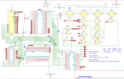

So I Recently started the design for my 8-bit computer, and have got the basics in (EEPROM reading and VIA). However i need a little bit of help:
#1. What ram would anyone recommend for my computer
#2. Does anyone use KiCad for design of boards like this? If so how would you go around having a footprint of a 74xx series NAND chip(It only comes as a multi-part footprint(see image))
#3. Is there any way that i can get an EEPROM programmer which is less than £50 (The most common one i find is around £50)
#4. Is there any blatant flaws/improvements i can make for my computer?
EDIT: Now Includes RAM Chip

Hello! Welcome and all that :-)
1 - RAM is up to you - look at the past and the Atari 2600 has just 128 bytes, then Apple II started with 4K then (very quickly!) went up to 48K then 64K, Pet (4K -> 32K), Vic 20 (4K?), BBC Micro 32K and so on.
I'd suggest 32K is a good starting point unless you're trying to be compatible with something else.
2 - I understand lots use KiCAD. I use something older, un-maintained now and somewhat cranky called Fritzing, but I've been using it for about 8 years now. I'd not recommend it, but take the time to learn KiCAD if you can. It's on my roadmap to learn & use ...
3 - No idea. Look on ebay?
4 - I' d have to spend time, but one somewhat vital thing to note: The 6502/65C02 must have RAM from location $0000 to $01FF as a minimum. I would reserve $0000 through $7FFF for RAM, then $8000 for the VIA and the top 16K for the ROM. There must be ROM (or equivalent) in the top 6 locations to even boot a 6502 as that's where the reset vector is fetched from.
There are a lot of template 6502 designs out there - a good current one is Ben Eaters 6502 project. One here is Garth Wilsons - start here: http://wilsonminesco.com/6502primer/ so give these a good look before warming up the soldering iron!
I started my project on breadboard then went to stripboard then PCB, so there are plenty of options for you.
I Have Modified The Schematic To Include The Modifications You Said. Thanks!

A good start, many of our systems started out with a schematic like this.
What is your plan for I/O? With a single 6522 it would be possible to drive a keyboard and display, or are you going with a serial console?
It's a big question for a design with no RAM yet, but an important one!

Welcome. Be sure to go through the 6502 primer, at http://wilsonminesco.com/6502primer/ . It was written to answer the questions and problems that kept getting brought up on the forum regarding making one's own 6502 computer. It is organized logically into 22 sections of design considerations, construction, debugging, practical interfacing, etc.. One thing I see right away is you have 4000-series logic there which is nowhere near fast enough. You have hundreds of nanoseconds' worth of propagation delay there just in the address decoding. 74HCxx is a much better starting point.
Thanks for the feedback, I have changed it and updated the schematic photo
(Be sure to take care of the 4081 that's still there too.) You might end up making major changes (and simplification) after you go through the 6502 primer.

The image is not viewable anymore. Did you somehow delete it? In the future, please post schematics in monochrome for the benefit of us vision-challenged old guys. :D
Regarding your memory map, the glue logic will be less complex if, starting from the top of the map, you have ROM, with I/O below it and all RAM below the I/O. There is no reason to waste 8KB of map space on a single I/O device. Take a good look at Garth's basic circuit for a start.
At first i was mostly concerned about the cost of the Logic Chips and the space they would take up on the board, however after a quick search have found them to be excruciatingly cheap! So I Believe I will integrate it now to use less address space so i can have more ram and integrate your simple yet so much better map into my own! Thanks for the help.
