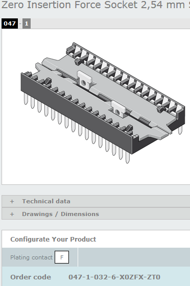

PostPosted: Tue Dec 17, 2019 6:56 am
Posts: 1431
ZIF (zero insertion force) sockets tend to be expensive, they tend to take a lot of space on the PCB,
but for EPROMs which are supposed to be plugged/unplugged quite often they are a good choice.
While looking around at mpe GARRY, I had stumbled over the 047 series of sockets.
They take less PCB space, and maybe they are less expensive... maybe not...
IIRC I have seen sockets like that in CNC controllers back in the 90s,
but don't ask me how/where to buy them.
Part numbers:
047-1-032-6-X0ZTX-ZT0 //Sn plated
047-1-032-6-X0ZFX-ZT0 //Au plated
Fischer Elektronik also has nice sockets and connectors, but they won't be cheap.
