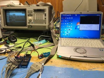

Hi,
This is my first post. As a vintage computer collector I find the eBay listings too expensive.
Instead, I am building my SBC designs.
For this forum, I submit my latest design, the TIM-1.
It differs from the original by replacing the 6530 with a 6532 and EEPROM.
The assembly code had to be modified as well.
I thank the 6502.org for providing the information and tools to make this possible. :D
Cheers.

Hi,
In response to an information request, I decided to respin my TIM-2.
I have attached the schematic PDF and the tested assembly code.
Note, the schematic indicates Max232 but I have changed this to the Max3232.
Note: for some reason, the decoupling capacitor for the 6116 RAM is missing on the PCB despite that the schematic has it.
This does not prevent the system from working
Cheers.

The serial connection works ok if I use a Max3232 serial to TTL module which has the Max3232.
That connects to the 4 post header next to the Max232.
For some reason, which I have not figured out yet, the on-board Max 232 circuit does not always work.
I don't know why it wouldn't, unless you are using the wrong charge pump capacitors. The MAX232 and siblings all accept TTL-level inputs, so that should be an issue with an NMOS UART.

I found my problem with the RS-232 circuit.
The culprit is an erroneous symbol provided by the user community in EasyEDA.
I have re-spun the PCB and I am waiting for delivery.
