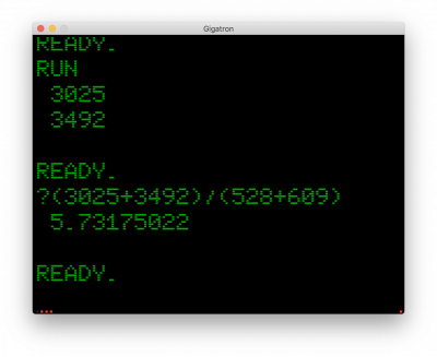

All these back-and-forth conversions make integer variables slower in MS BASIC. I can only see their point in large arrays. This is easy to test:
Result in video mode 3:
This is not a completely fair comparison because the GOTO20 is a bit faster than the GOTO50. But if you remove line 10-40, the integer loop still runs slower (3337 ticks).
This now also gives us our apples-to-apples benchmark reference, without having to port another Pi program (we already have one for TinyBASIC of course).
Hmm, I wonder how we can compute their ratio? Oh wait, there's only one way that's appropriate:
Wow: non-trivial machine code v6502 is only 5.7 times slower than the real thing?! Perhaps that's too good to be true, Edit: but confirmed by a stopwatch. This debunks the "v6502 is 10 times slower than the original 6502"-myth, and refines our earlier "8x slowdown" guesstimate. In reality we're running very close to 75 KIPS, or 3 instructions per scanline. Sweet 8)
