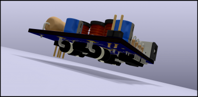

Technically, that should work, but with through-hole components on both sides and consequently the solder points for some components being hidden by others, assembling it is likely to be difficult. I'm also not entirely happy with relying entirely on the 10µF low-ESR capacitors I was able to squeeze on there, given how little capacitance the S4's motherboard has on it, and thus how much it must have relied on the original batteries for ballast when running on mains power (another factor possibly contributing to short lifetime).
Closer examination of the S4's casing suggests that if a thin plastic partition is cut away, it might be possible to fit the battery holder in a more favourable orientation, leaving about 10mm more space for the PCB. That doesn't sound like a lot, but in this context it means being able to arrange the components for easier assembly at the very least. It also raises the possibility of fitting some larger capacitors, maybe off-board and tucked into random corners of the case, just to make sure the power delivered is clean.

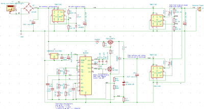

The top half of the schematic is the direct path from mains input to unit power, and should be able to operate without the bottom half (or the batteries) fitted. Essentially it's a rectifier for the original unregulated AC input, then a buck-converter down to 6V regulated, and a boost-converter back up to about 9.6V. On the potential divider selecting that last voltage, there's a second tap which offers the correct feedback for 8.8V, for the benefit of the otherwise identical boost-converter attached to the battery. The latter should thus go idle whenever mains power is available, operate in discontinuous mode for standby and "edit" mode, and in continuous mode for the 180mA power consumption specified for actual programming operations.
It may seem excessive to have effectively five regulator circuits, four of which need a relatively beefy inductor and flyback diode, for this job. Perhaps I can find a way to combine the two on the direct power path, although it'll have to be a different regulator than the LT1110, as the datasheet advises against using it for stepping down to move than 6V. The unregulated input voltage might sag under combined charging and programming loads, far enough that a simple LDO regulator wouldn't hold the output voltage out of the boost converter's target, and the load this would impose on the battery would likely trip the charge controller to prematurely end the charge cycle. Using separate buck and boost stages avoids this scenario, but for example a SEPIC topology could also handle it with fewer components.
The complicated part remaining is the battery charger, based around a BQ2004 charge controller. This itself requires a 5V supply, but at low enough power that using a simple linear regulator is sensible. To the lower-left of this is a resistor network to calibrate the thermistor (to be inserted into the battery pack somehow) with sane temperature limits and the BQ2004's expected voltage relationships for dT/dt detection. Configuration pins are tied as appropriate for a NiMH charge algorithm (peak voltage detection and top-off charge enabled, C/2 rate during fast-charge phase), and to make the LEDs on the right properly distinguish all the important phases of charging. To the lower right, a potential divider configures the dV/dt sensor for a 3-cell battery, and the current-sensing resistor selects 1000mA charging current. Finally, the MOD output is used to drive a buck-switching MOSFET through a simple gate driver.
This arrangement of the BQ2004 is much simpler than the suggestion in the most relevant application note I could find. As well as completely unnecessary (and rather unclear) provisions for charging Li-Ion battery packs with the same circuit as for NiMH, it used an active gate driver circuit to accelerate switching off the MOSFET at the end of each pulse - which I consider completely unnecessary, with a simple resistor being sufficient to discharge the gate rapidly when the driver is switched off. For all that complication, the application note left the LED outputs completely unused.

There is a "PWR_FLAG" connection (?) below U4p4 that annoys me somehow. There are two others above U1 and U2 - these will not cause a single net ?
But why don't you omit U4 entirely and put BT2+ and the output of U1 via two (schottky)-diodes together charging a 100 or more µF/10V cap?

The PWR_FLAGs are there only to satisfy KiCad's Electronic Rules Checker (ERC) which, without them, can only see that the power outputs of each stage are on the wrong side pf a passive component (an inductor, usually) from the power inputs of the next stage. They don't themselves represent a common connection, any more than adding a "single pin connector" component would.
As for using a diode to supply battery voltage to a single boost converter, I did consider that, but losing half a volt of power-Schottky forward drop from the 3.0V end-of-discharge voltage is actually quite painful for designing the booster. That diode would also be dissipating a large fraction of a watt during each programming operation. It's probably easier to reduce the number of converters by combining the functions of U1 and U2.
Ah ok, just looking similar to power taps.

One hefty redesign later, I now have a pair of Cuk converters based on the LT1372 (which has specific support for negative-voltage feedback) in place of the two boost and one buck converters based on the LT1110. This means that the board now technically provides a -9V supply instead of +9V, but this ultimately doesn't matter. A big advantage of the Cuk topology is that the current ripple is largely confined to the switching elements and the coupling capacitor, and is quite thoroughly damped at both input and output - the attendant disadvantage is needing more components. Cuk converters allegedly work best with pairs of coupled inductors, but these seem to be hard to come by in through-hole format, so I've used individual inductors instead.
The BQ2004 still uses the linear regulator and buck-switching MOSFET for the actual charging circuit - that hasn't changed at all. I did correct the connection of one of the LEDs, for which I must have momentarily read the wrong part of the table in the datasheet.
Speaking of ripple, I decided that omitting the 4700µF capacitors I originally specified for both input and output would lead to unacceptable performance. In particular, the fact that the input power is AC means I have to hold the voltage up there under at least a half-amp load for as much as 10ms between peaks. Even with the larger board size, however, they won't fit in the battery compartment. So I've had to make provision for attaching them by flying cables, so that a suitable place can be found for them elsewhere.

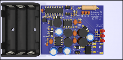

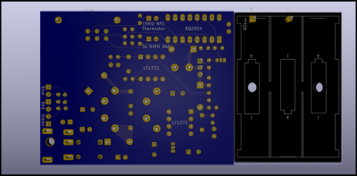

Here's the updated PCB, with battery holder for scale:

After getting LTspice to work and fiddling around with it a bit, a few refinements revealed themselves as being desirable. One of the more visually obvious changes is that the 10µF low-ESR caps are now ceramic discs instead of electrolytics. Three extra diodes also put a rough clamp on the current draw through the direct channel via the compensation pin of the switcher, as the combination of the relatively high impedance of the PSU and the 100Hz ripple would otherwise result in the undervoltage lockout triggering during startup and making the transients look *horrible*. This also has the happy side-effect of causing a smooth handover of duties when external power is removed. The battery booster merely relies on the internal current limiter; applying a further limit to that would risk not being able to supply enough power during a programming cycle.
Also obvious, as it takes up a lot of a previously clear scrap of board, is an extra 14-pin IC which turns out to be quite important. It's a 74HC132 featuring four Schmitt-triggered NAND gates, which I'm using as a slow, low-power oscillator. Its job, when enabled, is to put the battery booster into a roughly 1% duty cycle - because these switching converters have a roughly 4mA parasitic drain unless you actively shut them down, at which point that shrinks to a dozen microamps, comparable to the standby power drain of the whole programmer unit (probably just keeping an SRAM chip powered up). Without this refinement, therefore, the standby time would go down to under a week on fresh batteries, far less than the 8 weeks claimed for the original battery pack (which is probably dominated by self-discharge). I'm content with having a month of standby, rather than two months - that's comparable to the change in overall battery capacity - but cutting it to under a week was something I had to address.
This low-power mode doesn't matter for the direct converter, which draws all its power from the external source; likewise the battery charger is only powered when external power is present. I will need to check carefully whether I can derive the enable signal from the original power switch, or whether I'll need to fit an extra one to enable the long-standby mode. For the moment I've just designed in a header for an SPDT switch.
Less obvious changes include physically (but not electrically) reversing some freewheel diodes to shorten their current loops, and adding small capacitors on the "high" side of some potential dividers to act as a D term in the PID sense, reducing overshoot and improving load regulation. The transfer capacitors in the middle of the Cuk structures are also now of smaller value, as is the main output capacitor; the latter should make it easier to fit into random niches in the casing.
