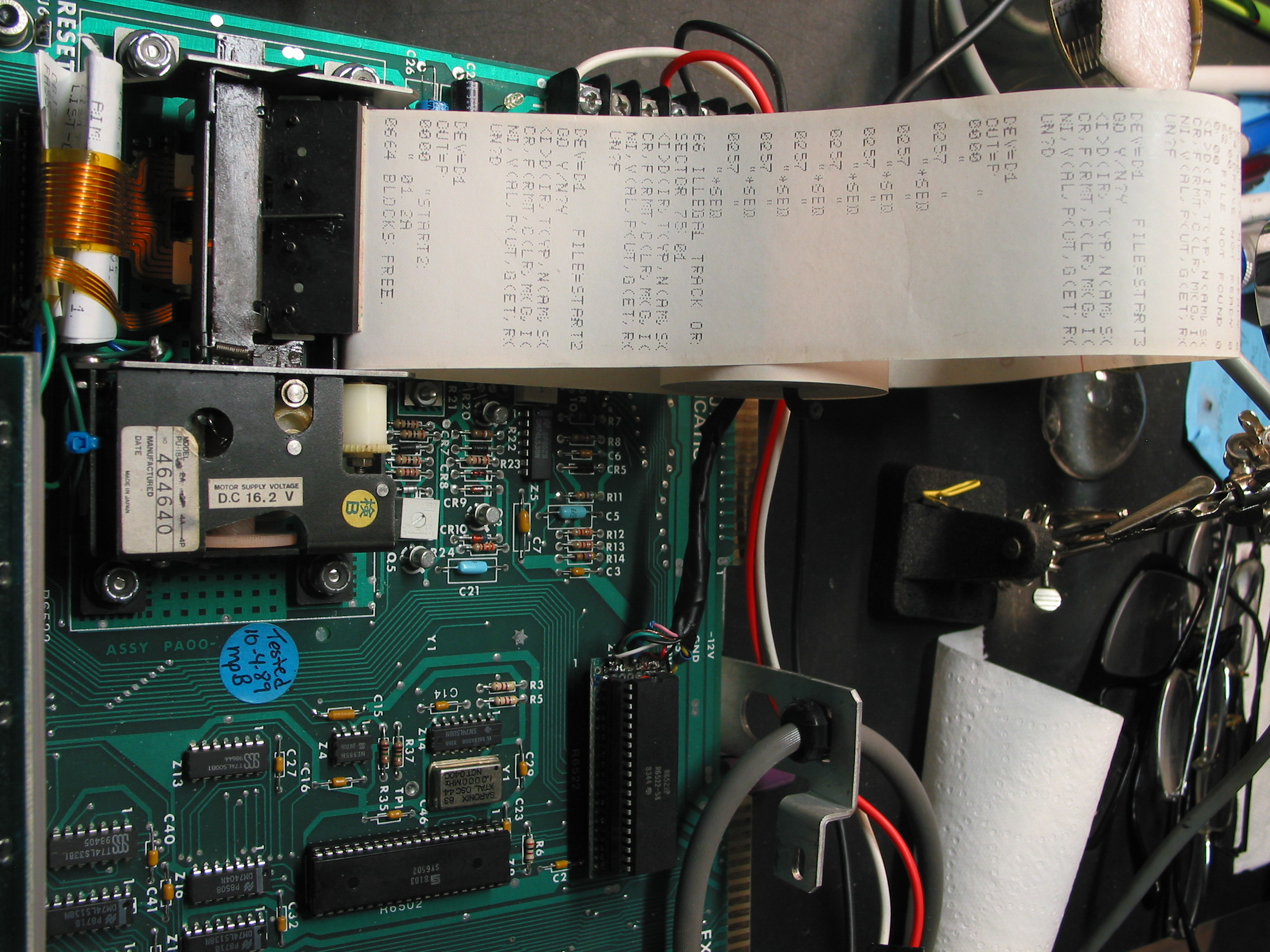

I have been developing a new 6522 board using the code and hardware from this vintage board that is now working for the AIM-65 to interface to the C1541. You pull the application 6522(hopefully you aren't using the I/O ports that this needs) and plug in my VEB Vertical Expansion Board. You can find it on ebay under my store Rootskiceller. I am working on getting it to work with an SD card emulator. The image shows my prototype but my production boards are much cleaner and not nearly so tall.
My email has also changed to orgwood65@gmail.com

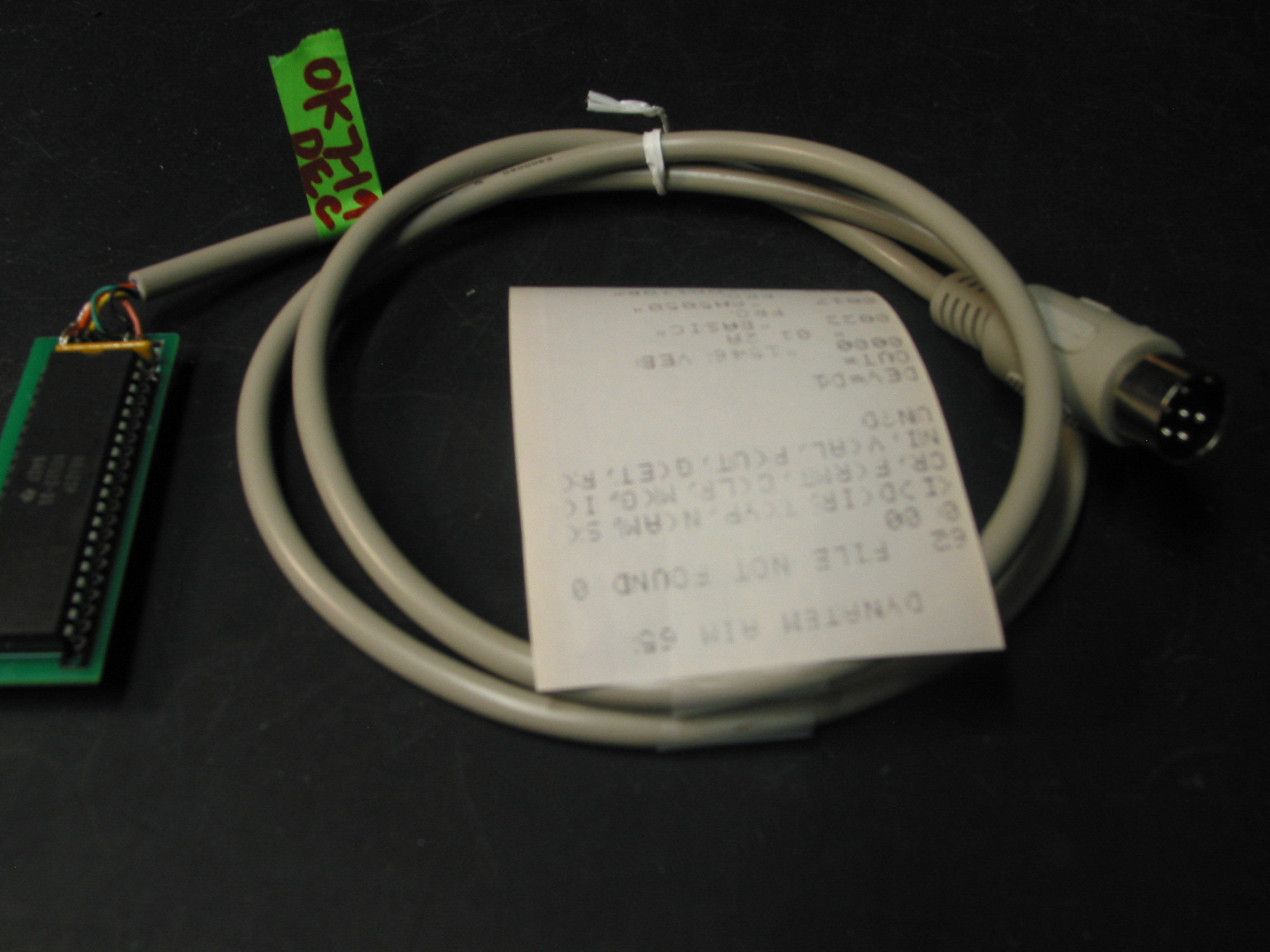

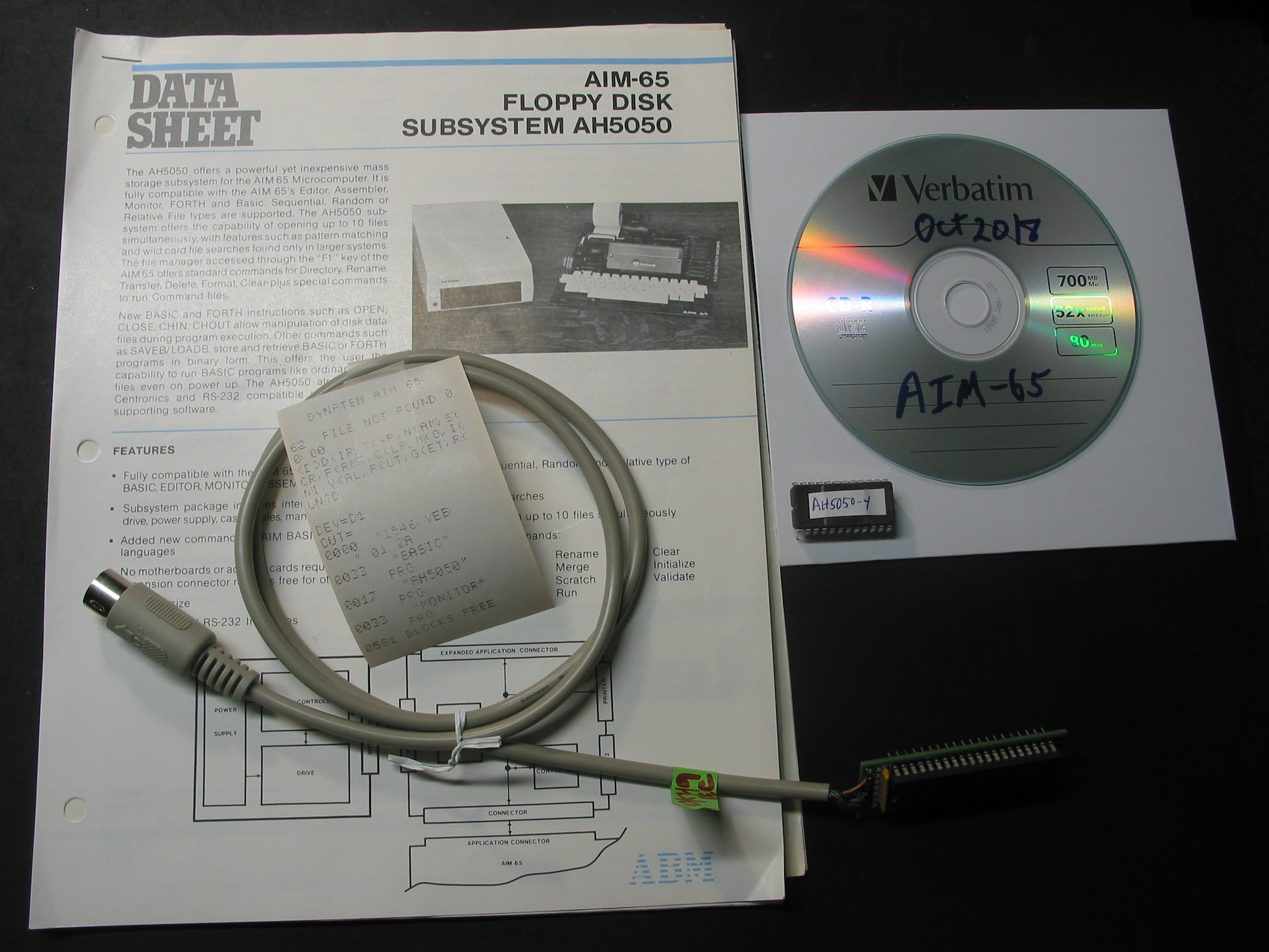

The AIM-65 C1541 interface uses the user 6522 with 5-6 I/O lines and I've tested it with the tfw8b Classic C-1541 SD emulator. I tried formatting a 1GB SD card first but ran out of room for 6502 files so I upgraded to a 2GB card so now I have plenty of room to work with. I plan on trying a 4GB card soon as I have a few of these micro cards that I can fit into the SD adapters. The 2GB card was read by my older XP laptop that has a built in Large SD reader/writer that won't go above that capacity so it was my default choice. The 4GB cards and up with go into a USB reader for testing. I formatted several 4GB cards recently and tried to read them on the AIM-65 for blocks available. There is a substantial increase I think because the 2GB cards normally have around 600 blocks while the 4GB cards show over 6000 blocks free.
My AIM-65 interface is now available on eBay under my store name Rootskicellar. I would make a special price offer to those here on the group if it would get some of these into the hands of some users. Any interest? I'm thinking the software on a 2532 for the AIM, card with cable to the C-1541, a 6522 mounted and tested and manual on CD would run about $100. I could lower the price by $25 if I provide both the software and manual on CD. This software would have to be disassembled by someone much more knowledgeable than me and reassembled for your particular machine since it was developed for the D000H socket on the AIM and uses the I/O devices in the monitor program. This program was provided by ABC Inc Alex Blanco and sold by Dynatem after they purchased the rights to the AIM-65 AIM-65/40 and RM65 line in the early 1980s. I was a distributor for both Rockwell and Dynatem under my company EXCERT Inc. Educational Computer Division. I would like to see if it is adaptable to daisy chaining so both the C-1541 and the SD emulator can be present and usable at the same time. I am not certain that the software currently supports that.
I am really needing some suggestions on how to daisy chain the C1541 Floppy Drive to the C1541 SD emulator so I can transfer files directly between them. I found some more files on old disks that a customer said she found in the documents that will allow an interface to BASIC and FORTH. There are also some demo files, etc that could prove quite valuable to today's USERS.
