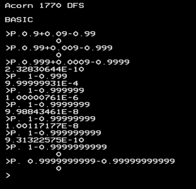

Note sure if this is any help, but I was musing about how many significant digits need to be accepted by a decimal to float input routine. And how things should be rounded. It feels like it might be valid to accumulate the mantissa at much higher precision than the eventual target precision.
Here's BBC Basic in action - not sure if these results are as you'd expect, but it might be food for thought.
