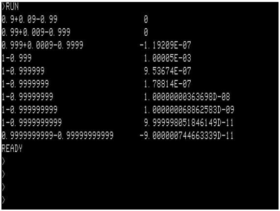

Note sure if this is any help, but I was musing about how many significant digits need to be accepted by a decimal to float input routine. And how things should be rounded. It feels like it might be valid to accumulate the mantissa at much higher precision than the eventual target precision.
Here's BBC Basic in action - not sure if these results are as you'd expect, but it might be food for thought.

Here's how the Apple ][+ responds to your inputs using its MS 40-bit floats:
Similar, but not quite as "accurate" on average.
Here's how the TRS-80 Model III responds to the same inputs with its MS 32-bit floats:
There is an automatic promotion (including a brutal speed penalty) to MS 64-bit floats for longer input strings.
If I ever get to that point with Woz floats, I'll do the same experiment. In the meantime, what other kinds of inputs could you imagine that might shed some light on a few of the darker corner-cases?
