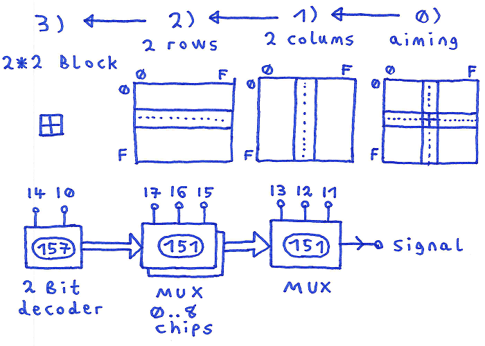

Now for something different: Opening a big can of worms.
6502 has 8 Bit instruction, and 8:1 decoders have three select inputs.
Spent some time on how to figure out, how to do a (more or less) efficient approach on decoding the 6502 instruction set with 8:1 multiplexers.
Background is, that we have a predecoder in our old TTL CPU, which detects if a fetched instruction is one Byte in size.
If one would want to go a bit deeper into pipelining and such, it might become necessary to go for a bigger predecoder which strips dome more info
from the fetched instruction, like:
if there would be a read or a write on the external data bus later,
if the instruction might cause a change in program flow (JMP\JSR, conditional branch, RTS etc.).
When using a 32 Bit or 64 Bit external data bus, it also might become necessary to decode in a fast way how many Bytes a fetched instruction has.
Now for my proposal for generating one signal from the 8 Bit instruction (256 instructions in total):
You start planning from right to left (signals go from left to right, don't get confused).
I7..0 are the outputs of the instruction register.
The drawing is a bit oversimplified, of course.
0) aiming: make a map on whether the signal should be 0 or 1 for every instruction in the OpCode table.
1) 74151 only has 3 select inputs, so we tie them to I3..1 and use one 74151 for generating our output signal.
//One of the eight 74151 inputs then rakes through two colums of the OpCode table.
//Inputs could be tied to HIGH, LOW, I0, /I0, I4, /I4, or to 2).
2) when necessary, use up to eight 74151 (with the select inputs tied to I7..5) for feeding the inputs of 1).
//Each one of these 151 decoders then rakes through two rows of the OpCode table.
//Inputs could be tied to HIGH, LOW, I0, /I0, I4, /I4, or to 3).
3) when necessary, use a 2 Bit decoder on I4 and I0 for decoding a 2*2 Block of the OpCode table.
BTW: to simplify things, I'm using 74157 and 74151 in the drawing, but it also could be 74CBT(LV)3257 and 74CBT(LV)3251 instead.
Now for decoding the 2*2 blocks for 3)
Left: conventional decoding with 74139 decoder
Right: decoding with 74157 or 74CBT(LV)3257 2:1 multiplexers\switches

For the 65816 OpCode map, instruction length looks like this:
  0123456789ABCDEF
0 2222222212113334 0
1 2222222213113334 1
2 3242222212113334 2
3 2222222213113334 3
4 1222322212113334 4
5 2222322213114334 5
6 1232222212113334 6
7 2222222213113334 7
8 2232222212113334 8
9 2222222213113334 9
A 2222222212113334 A
B 2222222213113334 B
C 2222222212113334 C
D 2222222213113334 D
E 2222222212113334 E
F 2222322213113334 F
  0123456789ABCDEF
So we mark every 1 in the table (every 1 Byte instruction, that is)
  0123456789ABCDEF
0 ........*.**.... 0
1 ........*.**.... 1
2 ........*.**.... 2
3 ........*.**.... 3
4 *.......*.**.... 4
5 ........*.**.... 5
6 *.......*.**.... 6
7 ........*.**.... 7
8 ........*.**.... 8
9 ........*.**.... 9
A ........*.**.... A
B ........*.**.... B
C ........*.**.... C
D ........*.**.... D
E ........*.**.... E
F ........*.**.... F
  0123456789ABCDEF
The result:
