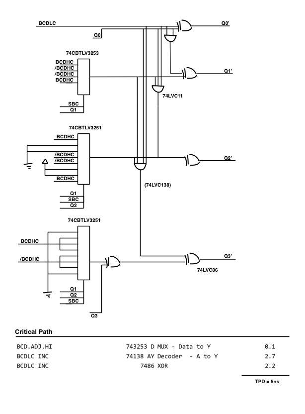

[EDIT: Found a useful optimization over the previous circuit ... ]
Here’s where I’m at for the BCD.ADJ.HI adder, which now includes a BCDLC carry input. It’s just the same as the previous BCD.ADJ.LO circuit, but followed by a carry-lookahead incrementer (the carry-look ahead uses a 74LVC138 as a 4-input AND). The XOR gates that followed the MUXes for Q1 and Q2 have been folded into the Multiplexers to make the incrementer more efficient. The combined circuit comes in at 5ns, as follows:
But now I’ve noticed that the [A..F] DETECT.HI ICs are CBT parts, and that means we don’t get /BCDHC for free. An inverter adds 2ns, so in fact this circuit takes 7ns. :evil:
hmmm, a 4-bit FET Switch adder has a higher IC count, but comes in at just 6ns. Gonna have to keep working at this ... :|
Drass

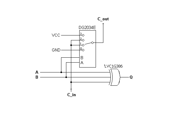

To recall, a 1-bit slice of Dieter’s FET Switch Adder as refined by Dr Jefyll looked like this:
For our purposes, we can use a 74CBTLV3253 for the 4-way FET Switch. As Jeff suggested, the second channel in the Dual 1-of-4 Mux can be used as a “Logical Unit” (http://6502.org/users/dieter/a2/a2_1.htm) to implement OR, AND and XOR functions for the ALU. All in all, it’s a tidy arrangement.
Ok, the carry-chain in this circuit includes several FET Switches in series, and while the datasheets usually provide a tpd figure for FET Swtiches, they do so with an asterisk:
*The propagation delay is the calculated RC time constant of the typical on-state resistance of the switch and the load capacitance, when driven by an ideal voltage source (zero output impedance).

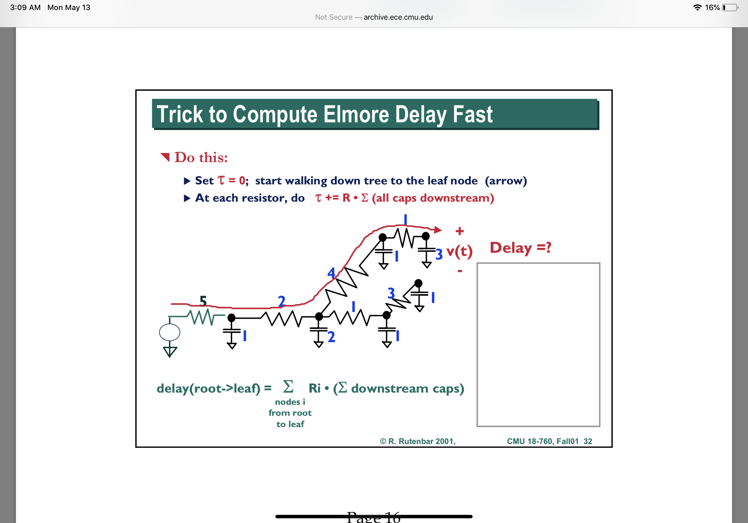

From what I understand, Elmore delays can be used to approximate the delay through an tree-structured RC-Network. Here is a nice illustration of the process:
In essence, the delay of each node in the tree is the resistance at that node multiplied by the sum of all downstream capacitance. The total delay through a given network path is the sum of all such RC delays in the path.
In our case, the second to last FET Switch has the following load on it: an XOR Gate pin (2pF) + 2x ‘3253 pins (0.9pF) + the “following IC” pin (3pF) = 6.8pF. So the simple RC delay for this node is 15Ω * 6.8pF = 102ps. Given this, I tallied up the simple RC delays for each of the FET Switches in an 8-bit carry-chain, as follows:
Bit 7 — 0.045 ns
Bit 6 — 0.102 ns
Bit 5 — 0.159 ns
Bit 4 — 0.216 ns
Bit 3 — 0.273 ns
Bit 2 — 0.330 ns
Bit 1 — 0.387 ns
Bit 0 — 0.444 ns
The Elmore delay for the full carry-chain is the sum of all these delays (~2ns), and the delay excluding the last FET Switch is ~1.5ns.

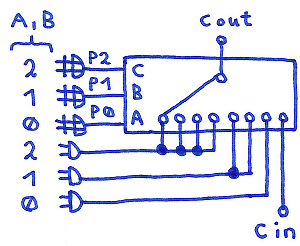

Just fur the fun of it, some obscure (and probably not 100% technically correct) ideas
which might be (or might be not) useful for other projects:
74151 working as 3 Bit carry lookahead circuitry for an ALU which uses propagate\generate signals.
Downside is, that an 8:1 74CBTLV3521 FET multiplexer\switch might be slower than 2:1 FET switches.

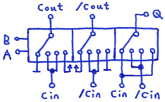

An adder which uses a 4:1 multiplexer instead of an XOR gate for generating Q.
Unfortunately, this requires a carry chain with an inverted and with a non_inverted carry signal,
resulting in a higher chip count... and in a higher capacitive load to the carry signals,
so I think it won't be faster than the conventional XOR output adder.

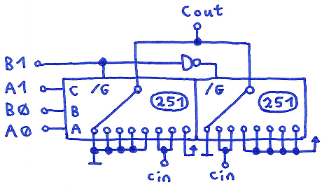

Two 8:1 FET multiplexers (74251 or 74CBTLV3251) working as a 2 Bit carry lookahead circuitry for an adder,
but the one inverter required is sort of a "show stopper".

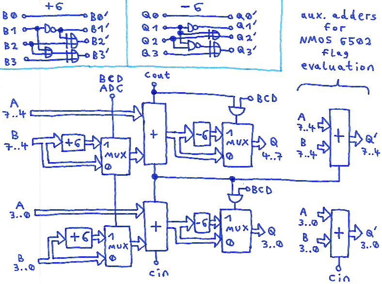

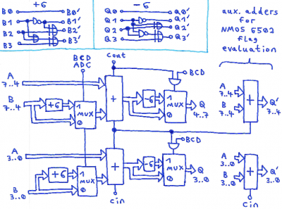

So we have that BCD mode...
with a $A..$F detection circuitry at the outputs of the adder nibbles,
with +6 and -6 correction at the outputs of the adder nibbles,
with some logic in the carry chain between the adder nibbles and so on.
And that's why I would like to toss in a (probably) controversial idea
for an alternative approach to handling BCD mode,
inspired by how the 100181 ECL ALU handles BCD.
It tosses the $A..$F detection logic and the logic in the carry chain
between the adder nibbles out of the equation...
at the cost of adding +6 to the B inputs of the adder for BCD ADC,
and correct incorrect NMOS 6502 flag evaluation requires an additional 8 Bit adder.
//Somebody please check if this makes sense, and if this works as intended.
Edit: for SBC, one would have to invert B7..0, that's not shown in this block diagram.
Posts: 11464
Re: Ideas for a faster TTL CPU //6502 related
Just to throw this in there, there's a BCD-like encoding called excess-3 which deals more symmetrically with addition and subtraction. Just possibly it's a way to build a BCD engine, by converting fore and aft.
https://en.wikipedia.org/wiki/Excess-3
ttlworks
Posts: 1464
Joined: 09 Nov 2012
Post by ttlworks »
Thanks, Ed.
An interesting topic is, what the 6502 does when adding/subtracting non_BCD values in decimal mode.
Somehow I'm afraid that converting BCD to Excess 3, doing the math, correcting the result
and converting it back to BCD might give us some compatibility problems there.
Posts: 11464
Ah, yes, another little corner of undocumented behaviour!
ttlworks
Posts: 1464
Joined: 09 Nov 2012
Post by ttlworks »
Yes, all these little details.
NMOS 6502, 65816 and our old TTL CPU produce the same results for ADC\SBC with non_BCD values in decimal mode.
65C02 produces different results for this.
To be honest, I'm not exactly sure how NMOS 6502 compatible my schematic above is when it comes to non_BCD values in decimal mode.
Answering this little question would require running some simulations... but as usual: there is too much to do, and too little time.

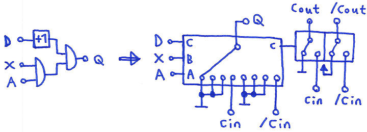

Since I had that schematic for building an adder with an inverted and a non_inverted charry chain up in the thread,
now to toss in an idea for an incrementer which ANDs two other values to the result of the increment.
Might be, that it would be useful for implementing the UFOs (instructions UnFOrseen by the NMOS 6502 designers),
might be not.

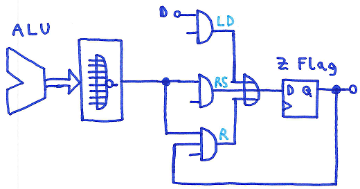

For being able to handle 16 Bit data types with an 8 Bit ALU (if one would try to implement something like a 65816),
we would need a little modification to the evaluation of the Z flag.
The first AND gate is for writing the Z Flag from the bus (PLP).
The second AND gate can set or reset the Z Flag, depending on if the ALU output is zero or not (that's what we already have now).
This AND gate would be used when the first Byte of 16 Bit data goes through the ALU.
The third AND gate can only reset the Z Flag (that's the new part).
When the second Byte of 16 Bit data goes through the ALU, the flag is cleared when the ALU output is not zero.
//It's just a conceptual drawing, of course, and a physical implementation later might be looking a bit different.

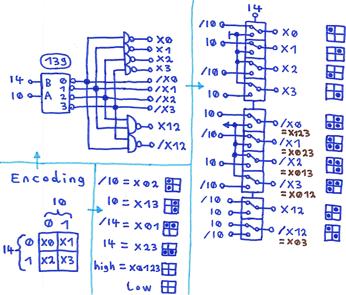

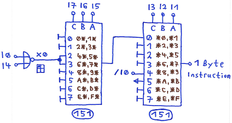

Now for something different: Opening a big can of worms.
6502 has 8 Bit instruction, and 8:1 decoders have three select inputs.
Spent some time on how to figure out, how to do a (more or less) efficient approach on decoding the 6502 instruction set with 8:1 multiplexers.
Background is, that we have a predecoder in our old TTL CPU, which detects if a fetched instruction is one Byte in size.
If one would want to go a bit deeper into pipelining and such, it might become necessary to go for a bigger predecoder which strips dome more info
from the fetched instruction, like:
if there would be a read or a write on the external data bus later,
if the instruction might cause a change in program flow (JMP\JSR, conditional branch, RTS etc.).
When using a 32 Bit or 64 Bit external data bus, it also might become necessary to decode in a fast way how many Bytes a fetched instruction has.
Now for my proposal for generating one signal from the 8 Bit instruction (256 instructions in total):
You start planning from right to left (signals go from left to right, don't get confused).
I7..0 are the outputs of the instruction register.
The drawing is a bit oversimplified, of course.
0) aiming: make a map on whether the signal should be 0 or 1 for every instruction in the OpCode table.
1) 74151 only has 3 select inputs, so we tie them to I3..1 and use one 74151 for generating our output signal.
//One of the eight 74151 inputs then rakes through two colums of the OpCode table.
//Inputs could be tied to HIGH, LOW, I0, /I0, I4, /I4, or to 2).
2) when necessary, use up to eight 74151 (with the select inputs tied to I7..5) for feeding the inputs of 1).
//Each one of these 151 decoders then rakes through two rows of the OpCode table.
//Inputs could be tied to HIGH, LOW, I0, /I0, I4, /I4, or to 3).
3) when necessary, use a 2 Bit decoder on I4 and I0 for decoding a 2*2 Block of the OpCode table.
BTW: to simplify things, I'm using 74157 and 74151 in the drawing, but it also could be 74CBT(LV)3257 and 74CBT(LV)3251 instead.
Now for decoding the 2*2 blocks for 3)
Left: conventional decoding with 74139 decoder
Right: decoding with 74157 or 74CBT(LV)3257 2:1 multiplexers\switches
ttlworks

We want to have a signal, which indicates that we have a 1 Byte instruction.
For the 65816 OpCode map, instruction length looks like this:
  0123456789ABCDEF
0 2222222212113334 0
1 2222222213113334 1
2 3242222212113334 2
3 2222222213113334 3
4 1222322212113334 4
5 2222322213114334 5
6 1232222212113334 6
7 2222222213113334 7
8 2232222212113334 8
9 2222222213113334 9
A 2222222212113334 A
B 2222222213113334 B
C 2222222212113334 C
D 2222222213113334 D
E 2222222212113334 E
F 2222322213113334 F
  0123456789ABCDEF
So we mark every 1 in the table (every 1 Byte instruction, that is)
  0123456789ABCDEF
0 ........*.**.... 0
1 ........*.**.... 1
2 ........*.**.... 2
3 ........*.**.... 3
4 *.......*.**.... 4
5 ........*.**.... 5
6 *.......*.**.... 6
7 ........*.**.... 7
8 ........*.**.... 8
9 ........*.**.... 9
A ........*.**.... A
B ........*.**.... B
C ........*.**.... C
D ........*.**.... D
E ........*.**.... E
F ........*.**.... F
  0123456789ABCDEF
The result:
Of course, if one has something like a neat Excel list of the OpCodes, and wants to generate some more signals,
he\she\it could automate the process by writing a little C program that reads the list,
and then generates a script which generates a schematic when sending that script into your preferred CAD software.
