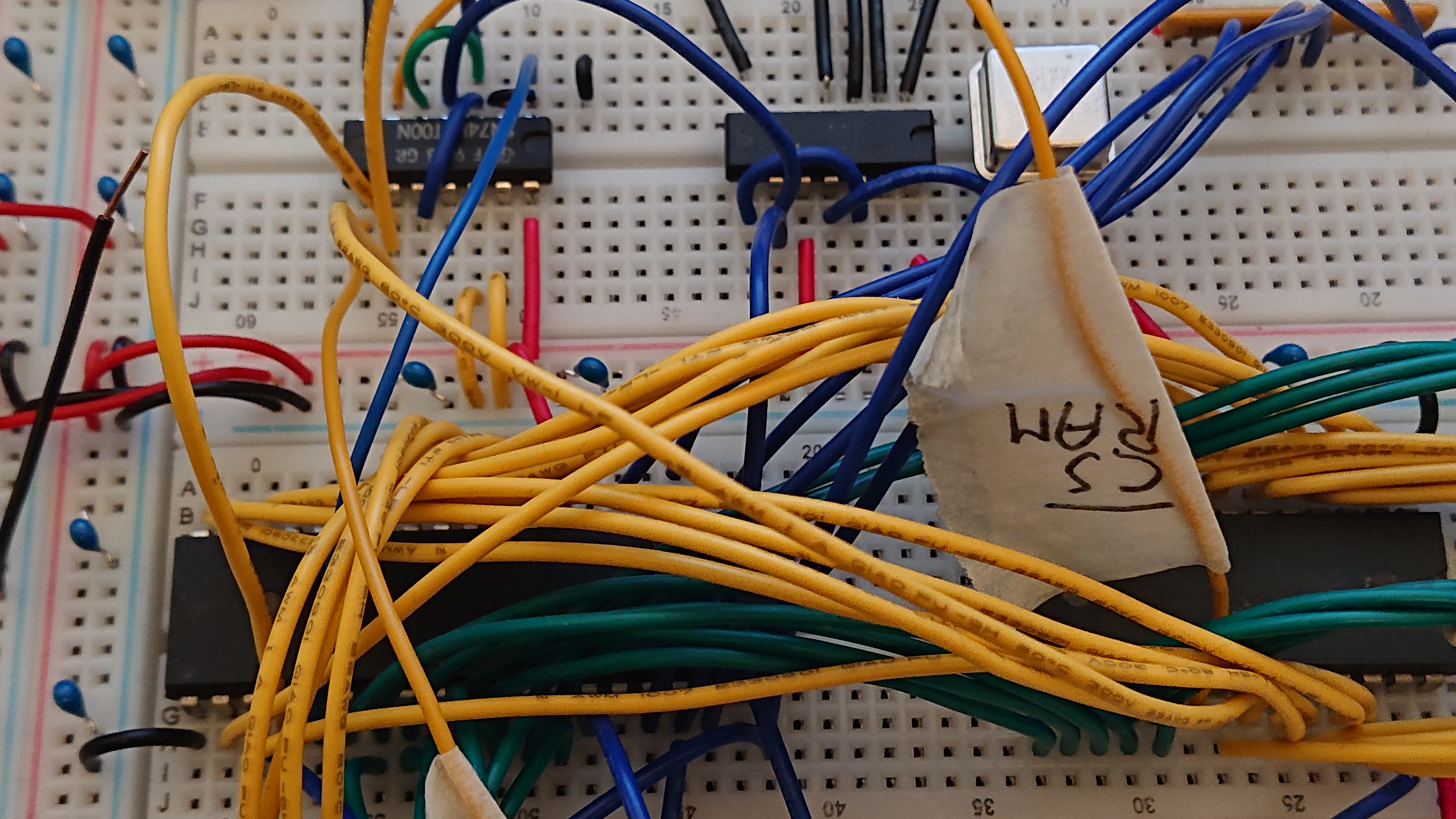

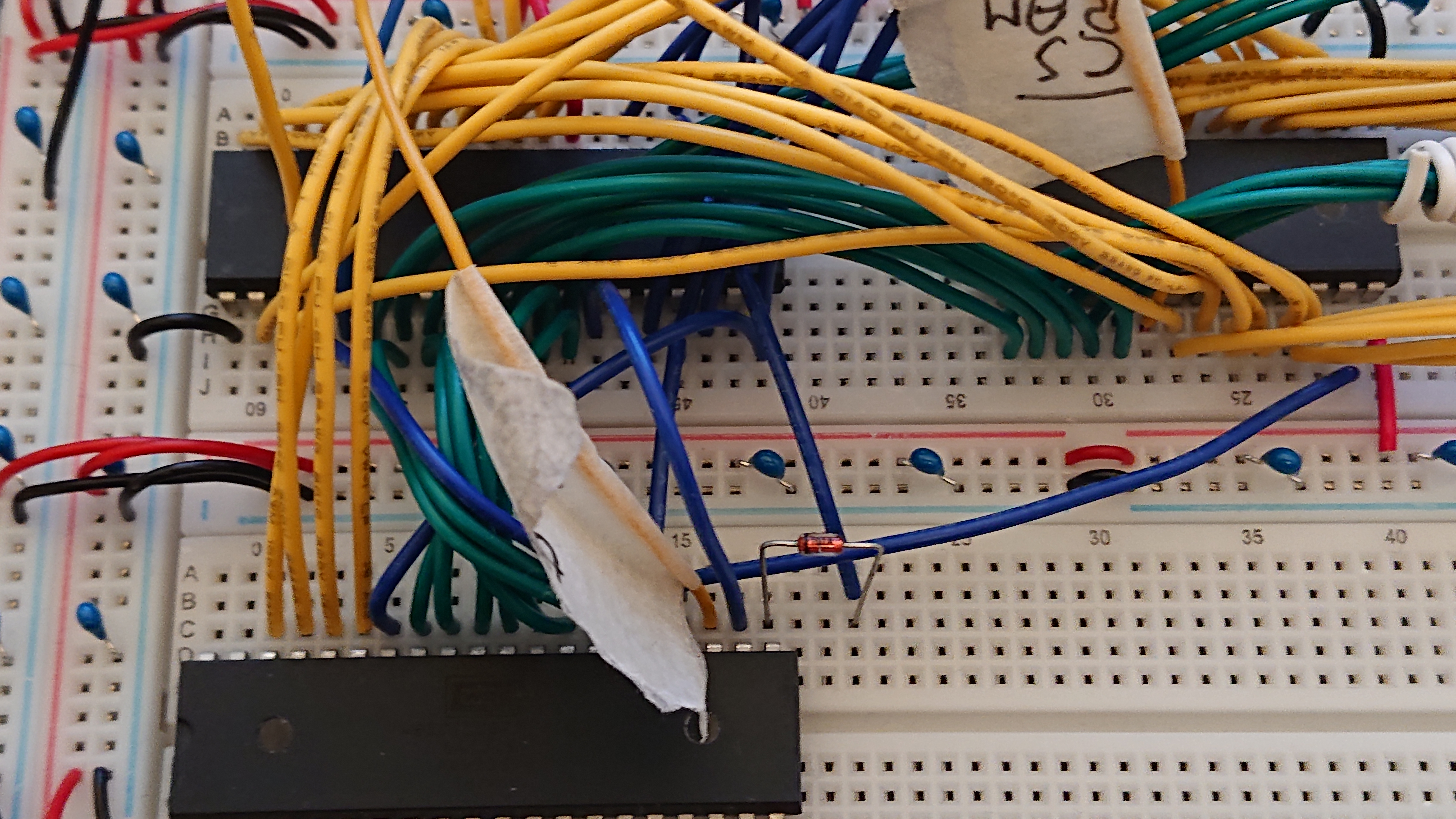

I can indeed. I built it on a solder less bread board though so there are wires everywhere.
File comment: The entire board.
File comment: Just the CPU
File comment: CPU, 74HCT00 (left) and 74HCT74 (right).
File comment: CPU, RAM and VIA
File comment: RAM, ROM and reset circuit.

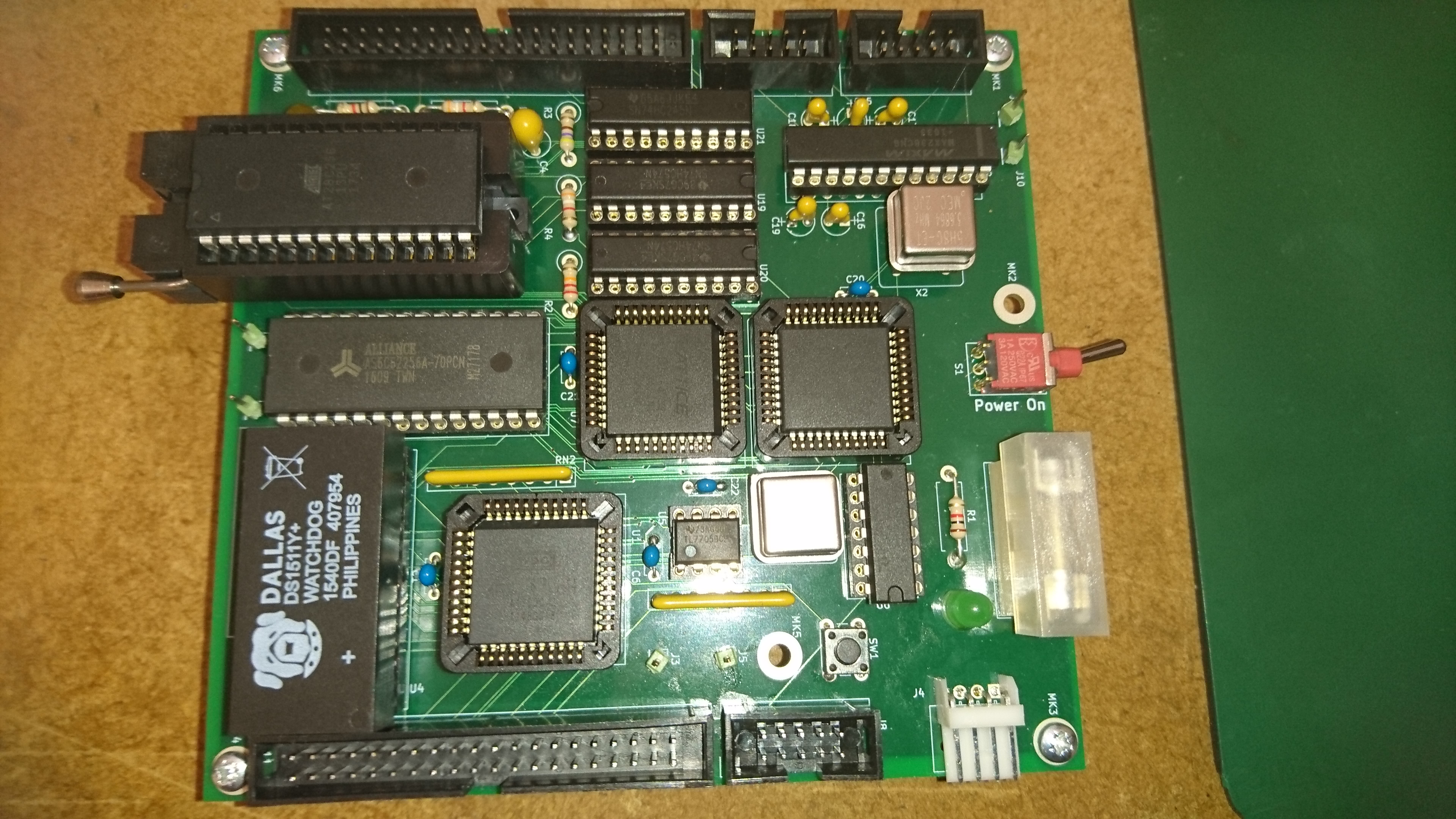

The dream is to get this computer to work.
PostPosted: Fri Jun 21, 2019 6:20 pm
Posts: 1468
Looks interesting - what is it?
PostPosted: Fri Jun 21, 2019 7:23 pm
Joined: Thu Sep 15, 2016 1:52 pm
Posts: 60
Location: UK
It's a 65C02 based computer with 32k ROM and RAM, an SC28L92 DUART, a Lattice MACH4A5 CPLD and some surrounding logic. A very experimental IDE interface is also there. Half of the implementation of the IDE interface is in the CPLD and the rest on the board (http://blog.retroleum.co.uk/electronics-articles/an-8-bit-ide-interface/. But since I can't even get a NOP ROM to work I thought it is time to go back to basic hence the bread board computer where the NOP ROM does work BTW. The VIA doesn't want to play ball though (still wonder if it got something to do with the RAM though).
PostPosted: Fri Jun 21, 2019 8:28 pm
