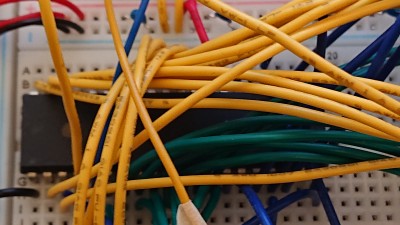

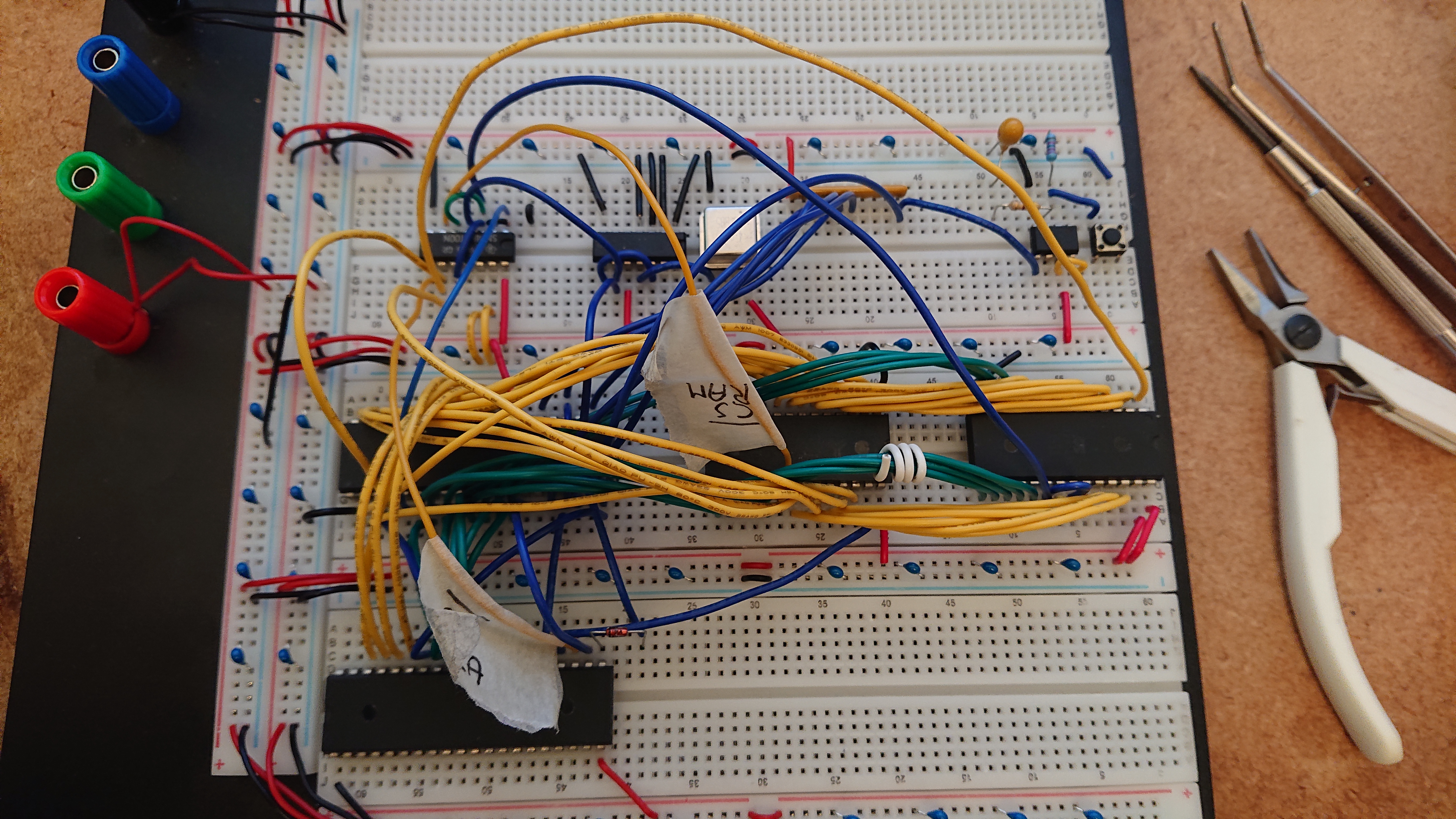

PostPosted: Fri Jun 21, 2019 4:10 pm
Can you post some photos of the project? Often it's helpful to examine things visually.
( And remember, on this forum you're allowed to attach images with your post. There's no need to use a third-party site such as Imgur.)
PostPosted: Fri Jun 21, 2019 5:26 pm
Joined: Thu Sep 15, 2016 1:52 pm
Posts: 60
Location: UK
I can indeed. I built it on a solder less bread board though so there are wires everywhere.
File comment: The entire board.
File comment: Just the CPU
File comment: CPU, 74HCT00 (left) and 74HCT74 (right).
File comment: CPU, RAM and VIA
File comment: RAM, ROM and reset circuit.

Posts: 60
Location: UK
The dream is to get this computer to work.
PostPosted: Fri Jun 21, 2019 6:20 pm
Posts: 1468
Looks interesting - what is it?
PostPosted: Fri Jun 21, 2019 7:23 pm
Posts: 60
Location: UK
It's a 65C02 based computer with 32k ROM and RAM, an SC28L92 DUART, a Lattice MACH4A5 CPLD and some surrounding logic. A very experimental IDE interface is also there. Half of the implementation of the IDE interface is in the CPLD and the rest on the board (http://blog.retroleum.co.uk/electronics-articles/an-8-bit-ide-interface/. But since I can't even get a NOP ROM to work I thought it is time to go back to basic hence the bread board computer where the NOP ROM does work BTW. The VIA doesn't want to play ball though (still wonder if it got something to do with the RAM though).
PostPosted: Fri Jun 21, 2019 8:28 pm
Posts: 8521
One step to try might be to pare it down further, if you're comfortable with that. You have a lot there that's not necessary. For example, the data sheet says, "The reset input clears all internal registers to logic 0 (except T1 and T2 latches and counters and the shift register). This places all peripheral interface lines in the input state, disables the timers, shift register, etc. and disables interrupt from the chip." So the only setup you need it to make port B (PB) all outputs, by writing FF to DDRB. Then decrementing PB, regardless of where it started from, will cycle all the bits, bit 7 being slowest, cycling about every 2/3 second at 1MHz, 1/3 second @ 2MHz, etc., plenty easy to see with a flashing LED.

The 65c02 can be single-cycled; so using a single-cycle circuit like what's 3/4 of the way down the clock-generation page of the 6502 primer, you can stop at each phase-2-high time and probe around looking at logic states and looking for voltages that are not a solid logic high or low, indicating bus contention. (The power supply's current meter might also tell you that when you get to the troublesome cycle.) WDC's W65C02S allows you to stop in either phase of the clock, not just the phase-2-high time; but you will still need to debounce.
