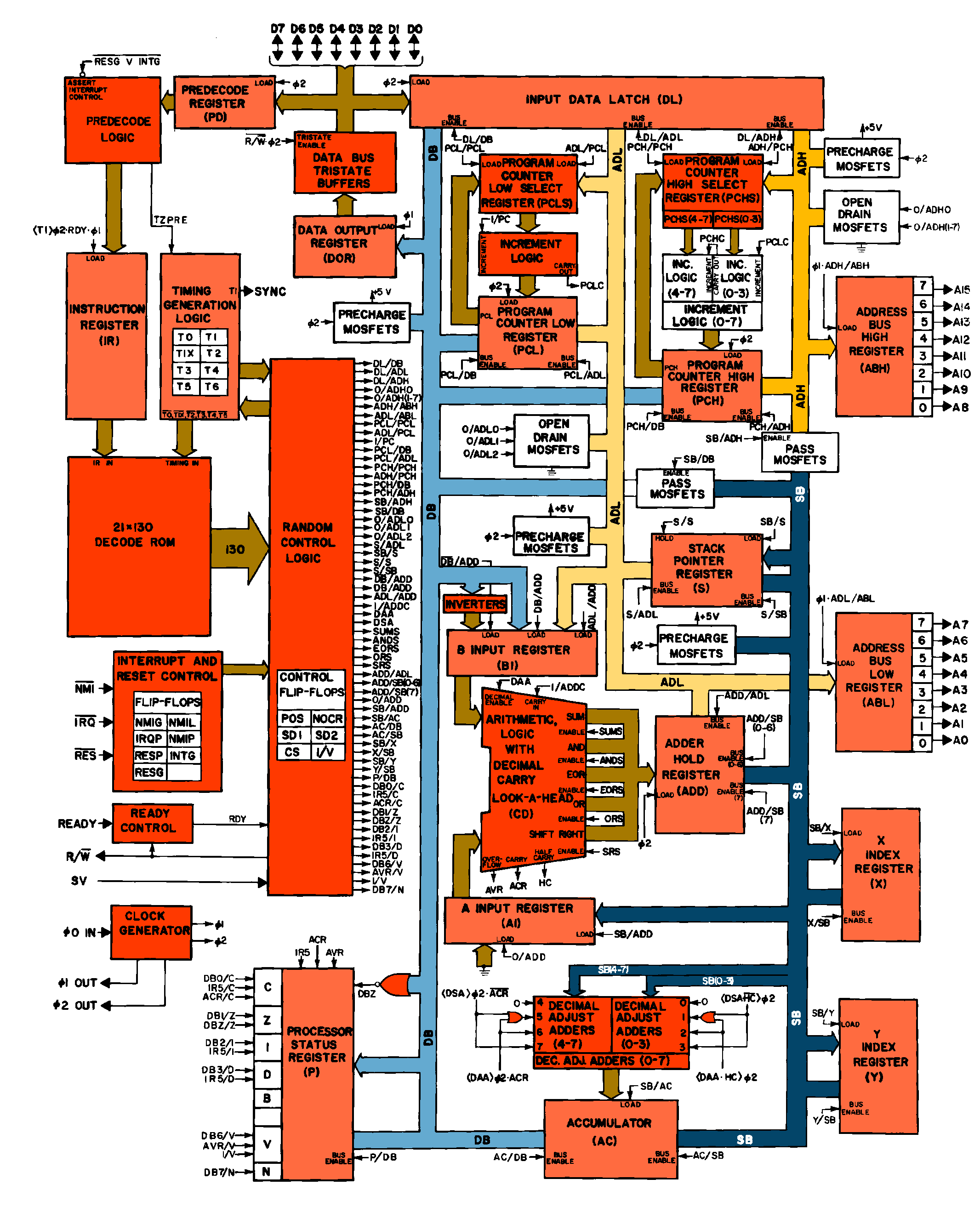

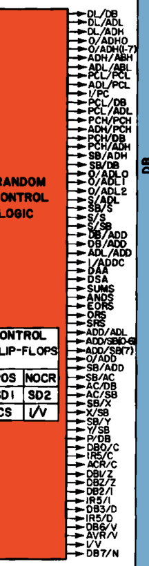

I am trying to make a 6502 work-alike processor in Logisim. I was trying to find info about 6502's control signals/pins/bus, but couldn't find anything except for Hanson's 6502 block diagram where you can see the control signal's names, but nothing about how they actually work.
The reason I want to learn more about 6502's control signals is that my current Logisim 6502 architecture would require over 10 clock cycles to execute a simple instruction, whereas a normal 6502 would do it in 2-3 cycles. How it would do so is a mystery to me and I would like to learn a lot more about the 6502 control signals.

Hanson's block diagram is a very good place to start - as you've noticed, there's a lot of detail there, in the signal names and their use within the datapath.
The signal names in visual6502 are in many cases inherited from the block diagram, which should help you piece together the way things work.
