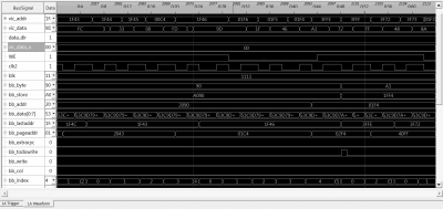

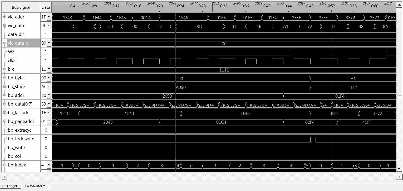

Yes I added such a filter. In the event that more than one NMI happens, it will only care about one. I will remove it again since it will make a mess of the logic (that takes care of nested interrupts), but for now I keep it to find the other bug I am experiencing (see below).
Reading what happens in the 6502 based entirely on the data/address bus is not easy, and for IRQ/NMI it is less obvious. I can look for the IRQ and NMI vectors on the address bus, but what is making this difficult is that the last opcode (to run) is not the last thing that appears on the databus. I run this code on the 6502:

The "NOP" opcode $FC is my MMU instruction that the Verilog code reads to switch memory page (here its page $33 which translates to address $33xxx). The STA $A000 accesses the external memory that is controlled by the MMU ($A000-$AFFF range) so that these two opcodes end in a STA to address $33000,X. This usually works but not if a IRQ happen. The following debug waveform shows what is happening:
File comment: Debug waveform
As you can see from the address and databus, an IRQ had been triggered and eventually access address $FFFE and $FFFF (this shows up as $3FFE and $3FFF here since I don't read A14 and A15). Anyway, the trigger happen after the "NOP $0033,X" instruction (with opcode $FC), but for some reason the next opcode byte $9D (STA) appears on the databus before the IRQ actually triggers. That is what was confusing my MMU decoder.
I have tested this in the Visual6502 simulator and it also happens there, so I just have to adjust the code to cope with this quirk..
Edit: I have adjusted the code and it now seems to work as expected.
Thanks to you all for all the help! (again!)
This is supported by the 65816 data sheet which has the cycle-by-cycle behavior of every addressing mode, as well as by my own testing.  The processor picks up the first byte of the following instruction and then discards it, as it is doing internal operations in preparation to handle the interrupt.
