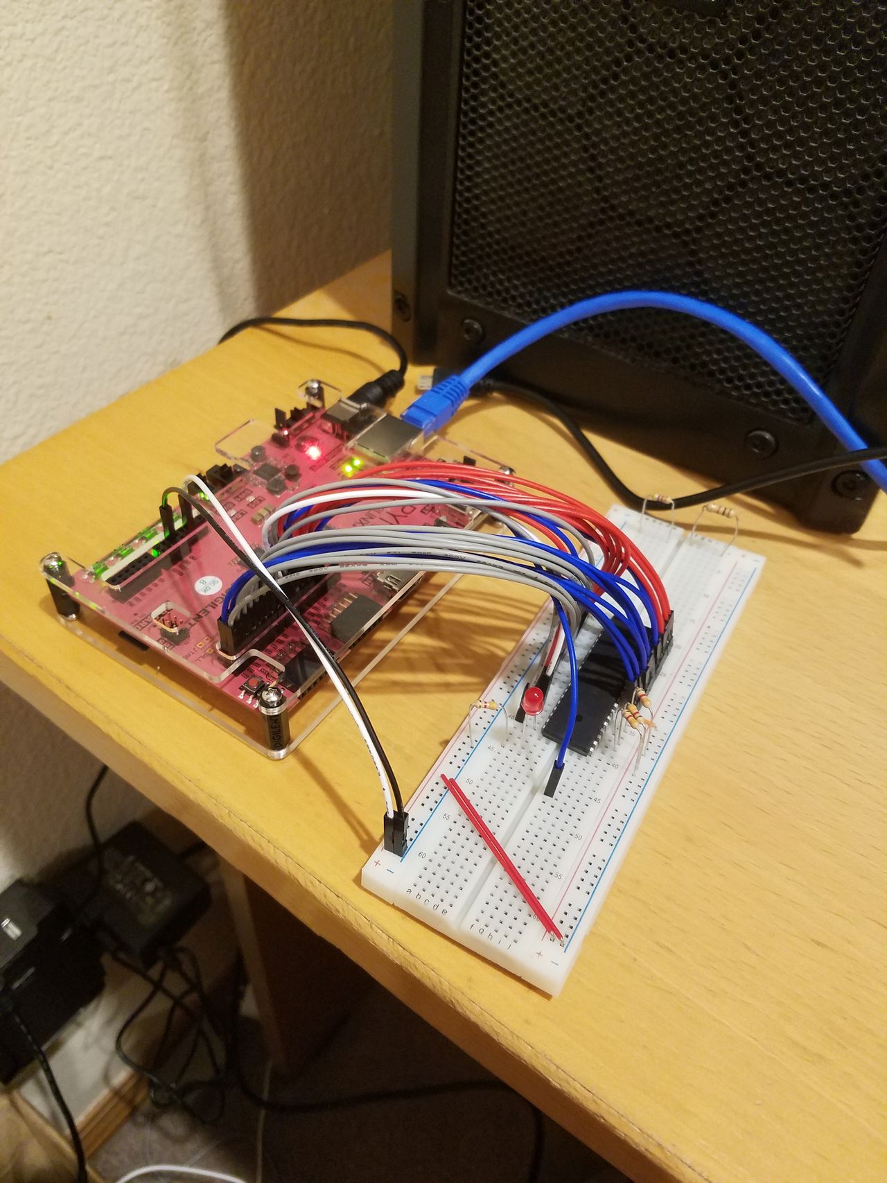

I suppose I might as well show off the project. Attached is a photo. Please don't laugh.
As I've mentioned, the FPGA is able to detect the FFFC,FFFD bootup sequence and run a program made of all NOP's (0xEA). Attached is a capture of the A0 line when running NOP's (it should toggle every cycle). The result looks... more like a sawblade than a digital signal. The "0" part is -0.1 to 0.3 V. The "1" part is 2.59 to 3.20 V. At a 3.3V power supply, this is barely within tolerances. Something should probably be done to improve it.
It might be important to note that the Pynq-Z1 board has 200-ohm safety resistors on almost all of its digital I/O pins. There are 6 pins available without resistors, but I don't want to use those pins unless I absolutely have to.

Oh oh - I cannot find any capacitor on your breadboard !?
This is very necessary : place a 100 nF (0.1 µF) capacitor (ceramic or film) between Vdd (pin 8 ) and GND. The cap's pin should be next to pin 8 then the (shortest available) wire to Vdd. There another 0.1µF should sit directly between Vdd and GND. I would add another one (this time 10µ tantalum or ceramic) where you power the breadboard (black & white wires).
Second: provide a shorter (additional) wire between GND (pin 21) and GND - best a wire to the other pin of that C that is next to pin 8.

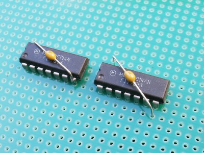

Yes, and this is where I was saying there should be a capacitor straddling the IC itself, with the shortest possible connection from the VDD pin to the Vss pin. Connection length adds inductance, something you definitely don't want here. Capacitor leads will have about 18 nanoHenries of inductance per inch of length.
PostPosted: Mon Apr 22, 2019 6:24 pm
Right. Here's a photo to illustrate. It's not on a breadboard (I don't own any) but it'll give you the idea just the same. The soldered version is preferred, though perhaps less convenient.
beholdnec wrote:
Attached is a capture of the A0 line when runnin.g NOP's (it should toggle every cycle).
Actually not. NOP (opcode $EA) is a one-byte instruction that takes two cycles to execute. Thus you can expect A0 to toggle every other cycle. To see toggling every cycle, use a two-byte instruction that takes two cycles to execute, such as LDA #. The opcode is $A9, and if you like you can use $A9 as the operand, too -- that way there's only one value to apply tothe data bus. :)
