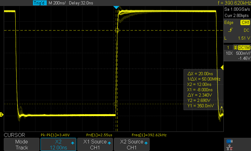

Here is an oscilloscope trace of the PHI2 signal going from the FPGA to the 65816. The frequency is 390625 MHz = 100MHz / 256. Voltage is 3.3V.
The rise and fall times are about 20ns, measured from 20%-80%. Some ringing is visible- could that cause issues?
Basically, I want to reduce the rise and fall time to 5ns, if possible. But I'm not sure if it's possible to achieve this speed on my breadboard. Any guidance is appreciated.
Re: Verilog code to interface an FPGA with a real WDC65C816S
390.625GHz? Er...390.625kHz. :D
A little ringing is nearly unavoidable and may be ok if the amplitude of the ringing is not so much that the input is interpreting it as double clocking at a rate that it can't handle. Increasing the slew rate will increase the ringing. As you know, solderless breadboards are terrible for this kind of construction, and we seem to have ten or twenty percent of solderless-breadboard projects on this forum having problems because of it. The clock line is of course the most important though. Most other lines are ok as long as the ringing dies out before the next relevant clock edge. But if the clock edge itself is the problem? Trouble. To feed the processor's clock input, you could put a Schmitt-trigger gate as close as you can to the processor's clock input pin, with the ground connection between that gate and the processor also as short as possible, or, if not as short as possible, lengthened only enough to twist it with the clock line. Gate output pin to µP clock input pin, and gate's ground pin to µP's ground pin, really short. Power supply decoupling capacitors should be put across these ICs with leads as short as possible too, diagonally across the top of the IC, not out at the power rails a little distance away.

I don't believe that the 816 won't work properly only because the clock edges are "only" 10 or 20 ns steep. If you take a look at some scope shots I took from the 816 SBX board viewtopic.php?f=4&t=4448&hilit=265&p=52362#p51954 you can recognize that they rise/fall somewhere between 5..10 ns.
What sort of probe do you use? It should be qualified for >50MHz and scaling 10:1. If it is 1:1 you will only measure garbage - the capacitive load would be too much a burden.
Garth already said the clock is static and can be stopped at any time. Perhaps you implement a delay (one or more internal clocks) between setup address and data bus and RWB and then clock. Remember that when PHI2 changes from high to low it doesn't take long and the databus may get used to sent the bank address. So you need to turn off any data bus drivers before that. If that appears to be difficult you can try inserting some series resistors (1K should work for a slow overall clock) to prevent excessive currents, which may cause a supply voltage drop and then strange things will follow :)
-- I just noticed Garth had already answered. Try his suggestion - insert a schmitt trigger - use short cables as told. Check the signal again.
edit(1)
:oops: I just noted that the scope shot I referred says rise and fall time of PHI2 is around 3 ns :oops:
Nevertheless I don't believe that clean (= monotonous rising or falling ) but slow(er) edges are critical. :wink:
