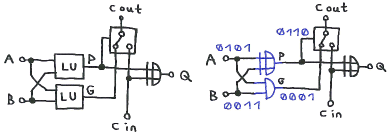

Stumbled over the Onsemi\Fairchild NC7SB3257 2:1 FET bus switch, and to me it looks like a "game changer".
5V capable, 250ps propagation delay through the switch, switch resistance 3 Ohm typ. (Vil) and 6 Ohm typ. (Vih).
Left: 1 Bit ALU slice.
Right: ALU slice configurated as an adder.
So if we would be going to use 74AC153 multiplexers as LUs (Logic Units), NC7SB3257 2:1 switches for the carry chain and 74AC86 (or faster XOR gates)
for building our carry skip adder, what would be the min\typ\max propagation delay for the ALU ?

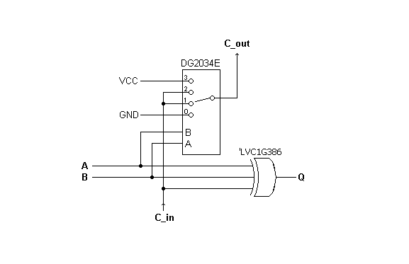

PostPosted: Tue May 07, 2019 5:35 pm
Great work, Dieter -- very exciting! I agree this could be a game changer (because the use of FET switches minimizes delay in the all-important carry chain).
I don't quite understand the "LU" blocks in the left diagram of your post. But here (below) is a variation on your adder (from the right diagram). It's not any faster, but the chip count is reduced (just two SMD's -- one 6-pin and one 10-pin).
cheers,

I think I should elaborate my idea for a different ALU design more detailed.
Drass, what we currently have in the CPU are 74153 4:1 multiplexers,
working as logic units, feeding the inputs of 74283 adders:
What I'm suggesting is related to the _other_ ALU design described here,
except that the SHR MUX is missing this time.
My suggestion is tossing the 74283 out of the design.
One 74153 contains two 4:1 mutiplexers, which are working as LUs (logic units), emitting the P (propagate) and G (generate) signal for one Bit of data.
(Means, that the ALU control signals for the multiplexers have to be different than they are now.)
The P,G outputs of the two multiplexers per data Bit go to a NC7SB3257 FET switch, 4 FET switches required for 4 Bits of data,
and that's the carry chain.
We need one two input XOR gate per data Bit for generating the ALU output from P and carry, and that's all.
//Maybe tossing the 74283 out of the incrementer\decrementer would make sense, too.
For the two input XOR gate, to me two chips look interesting:
NL17SZ86
NC7SZ86
It's a pity, that there seem to be no XOR gates with three_state output.

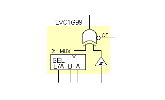

Dieter, you could consider using 74LVC1G99. It is primarily a 1-bit-wide 2:1 Multiplexer, but its three-state output also has a polarity control. :)
PostPosted: Fri May 10, 2019 3:51 pm
I think you win the prize there for best 74 series gate.

Jeff, thanks for the hint.
74LVC1G99 also could do the SHR functionality of the ALU.
The problem when building the carry chain from NC7SB3257 FET switches is,
because of the switch resistance and the capacitances in the design to me it's hard to judge what would be faster:
Trying to build an 8 Bit carry chain, or to stick with the carry skip adder topology (4 Bit chunks) we currently have in the TTL CPU.
Would suggest to build a test SBC containing just an ALU and a register for both approaches,
then to configurate the ALUs for "increment" and to see which approach would offer more speed.
