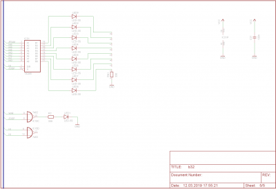

1PA22 and 1PB22 I\O ports already went described somewhere up in this thread.
B32 bus interface.

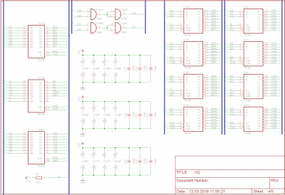

R32 module, 32 Bytes of TTL SRAM, 4 modules required (only one was built).
Top and bottom of _one_ module:
And yes, 44 chips on one PCB.

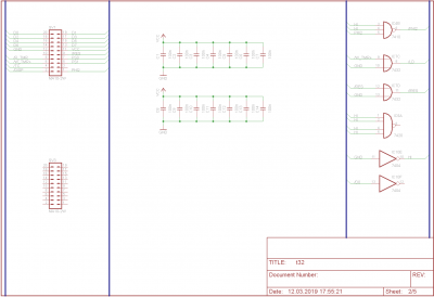

ttlworks
Posts: 1464
Joined: 09 Nov 2012
Re: Experimental TTL implementation of the 6522
Post by ttlworks »

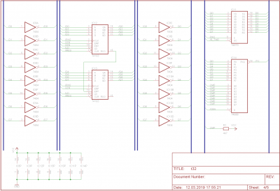

Last part: I32, timer control and interrupt module.

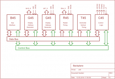

X45, experimental 6545 TTL implementation.
16 Bit video address output (instead of 14 Bit), transparent latches in the address output lines
for compensation of bus hold timing issues, and IIRC it was a three-state output.
Interlaced mode with some conceptual bugs, also sort of a horizontal scrolling mode where
one line of characters is 256 Bytes.
D45 demonstrator PCB (for generating a video signal) was plugged between the computer and the
X45 backplane.
Plugged into the X45 backplane, we have:
1* B45, bus interface
1* C45, the control module
1* T45, horizontal\vertical timing module
1* R45, raster timing module
2* G45, two video address generator modules

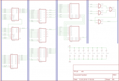

ttlworks
Posts: 1464
Joined: 09 Nov 2012
Post by ttlworks »

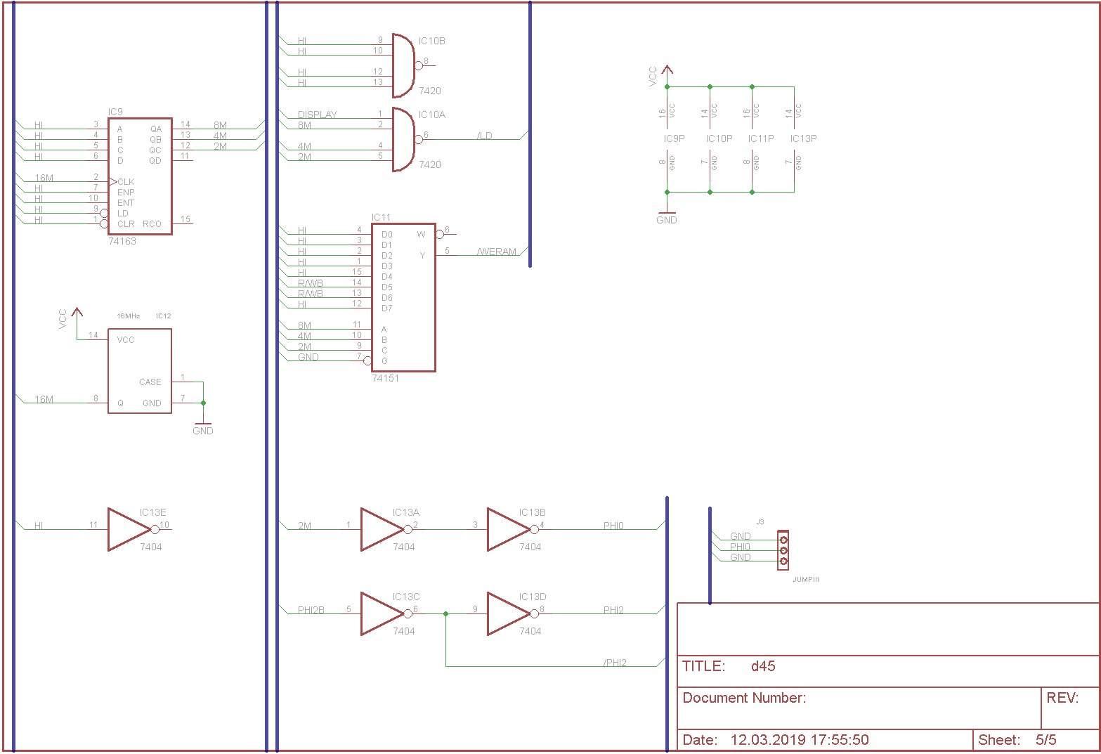

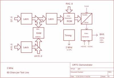

Let's start with D45, the demonstrator PCB containing the display RAM, the character ROM, the shift register etc.
80 characters per line (6502 has to run with a 2MHz clock generated by D45), monochrome analog video signal.

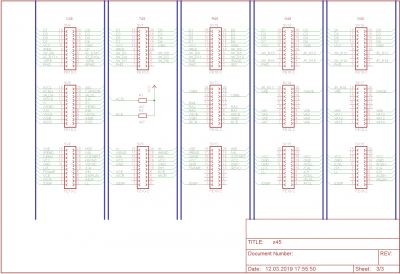

The X45 backplane.
IIRC the little green wire was added for testing the light pen registers.

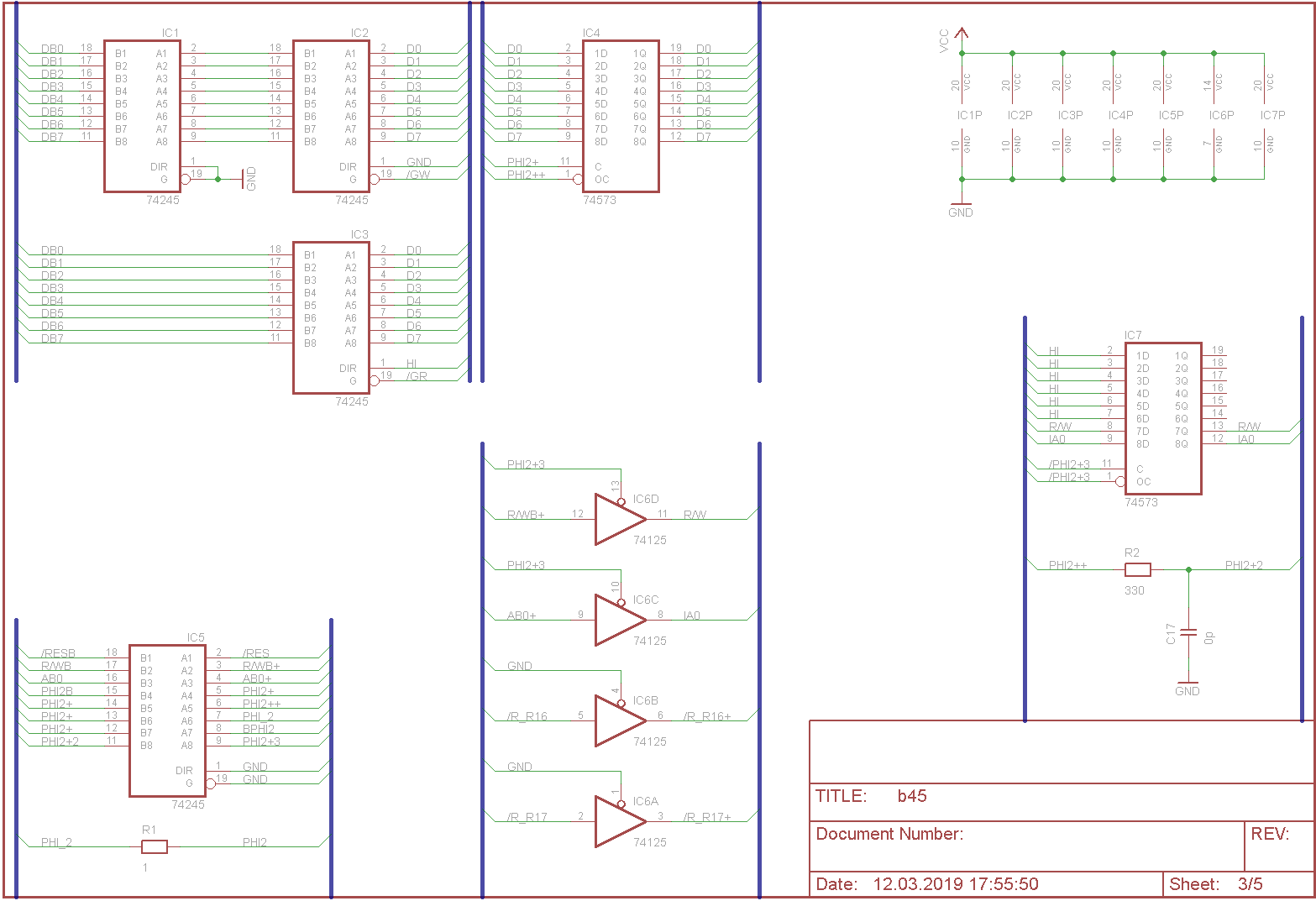

B45, the bus interface to the 6502.

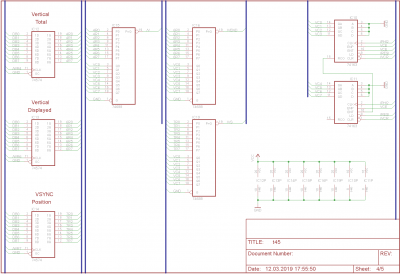

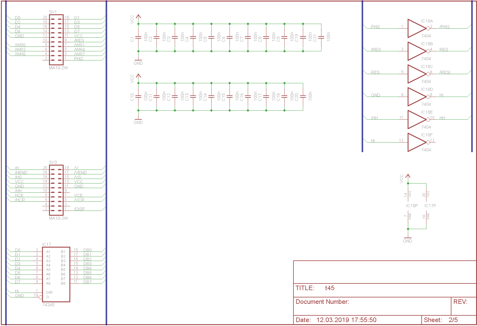

ttlworks
Posts: 1464
Joined: 09 Nov 2012
Post by ttlworks »

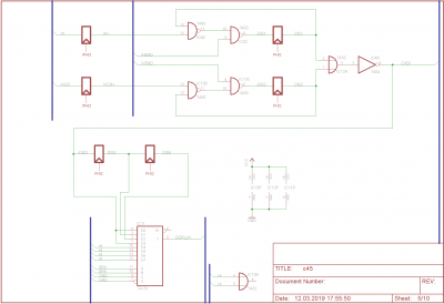

ttlworks
Posts: 1464
Joined: 09 Nov 2012
Post by ttlworks »

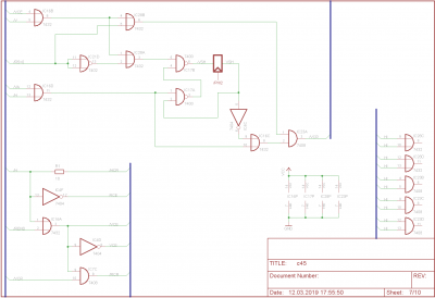

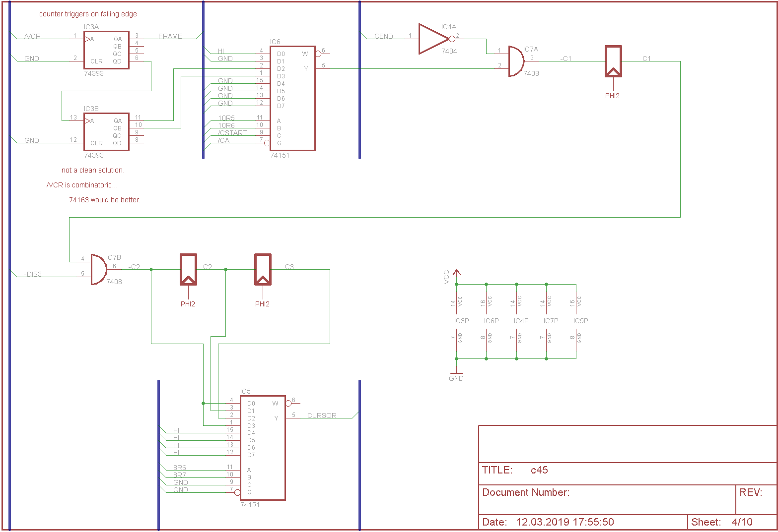

Now the last part:
C45, control module.
Unfinished work, has conceptual bugs, and you better design the whole thing again from scratch. I really mean it.
IIRC the intention was being able to run the video address generation circuitry at a higher frequency than the 6502 CPU,
with the idea in my backhead of porting the design to a CPLD someday, so I had decided to go with synchronous logic.
But this had bloated and complicated the logic design a lot, maybe it would better you go for another concept
like making creative use of RS flipflops at some places in the circuitry if you are trying to build something like that.
