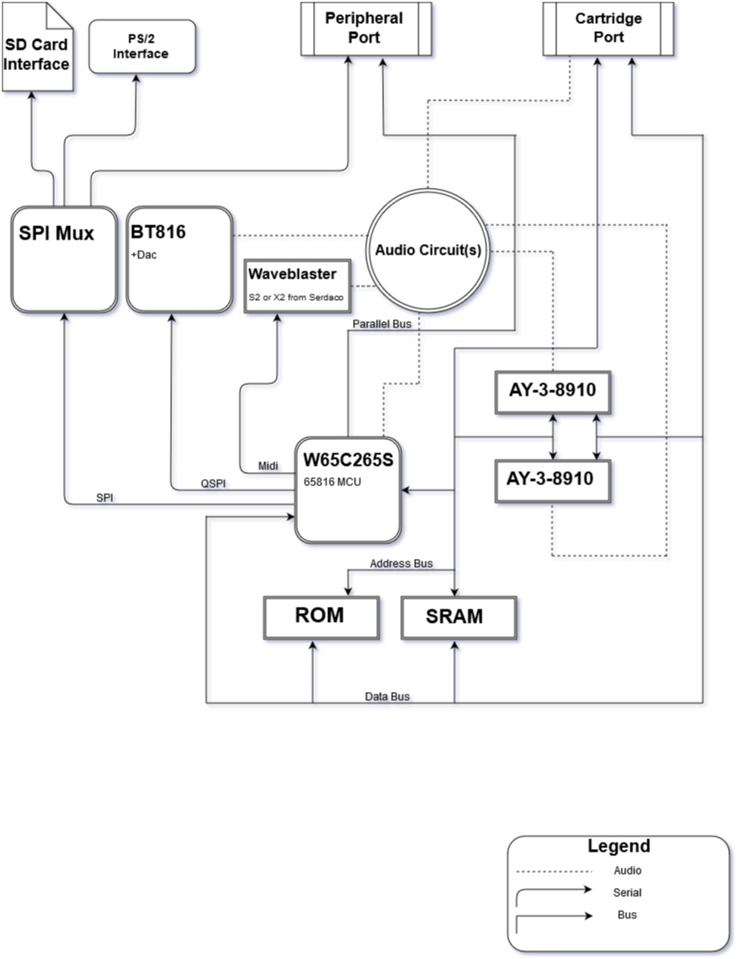

I finally found the time to figuring out more exactly what hardware I want to put into the design.
I put together a block diagram to give a loose idea of what I'm looking to do.
Tell me what y'all think. Keep in mind that the diagram is still a work in progress.

I'm trying to figure out how to use one of the UARTs to send Midi data to the synthesizer chip I'm using. Does anyone know where I can find resources on how to do it on the microcontroller?
