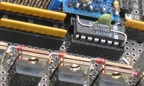

PostPosted: Mon Mar 25, 2019 2:46 am
Solater wrote:
Won't the heat damage [ the IC ]?
No, not unless you take a LONG time to do the soldering. A fine tip on the iron is helpful. And you want it to be fairly hot so the job can be done quickly. If you have any extra/worthless IC's around you can practice soldering on them.
Edit: I found a photo.
Edit 2: And here's a better photo. The leads have less unnecessary length (and this is assisted by the choice of axial-lead rather than radial-lead caps). In addition to the soldered version on the left, on the right we see an alternative arrangement intended specifically for wireless breadboard. It's easier, of course, though not quite as good as direct attachment to the chip.
