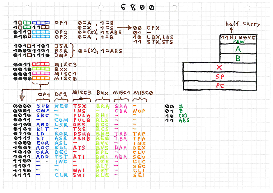

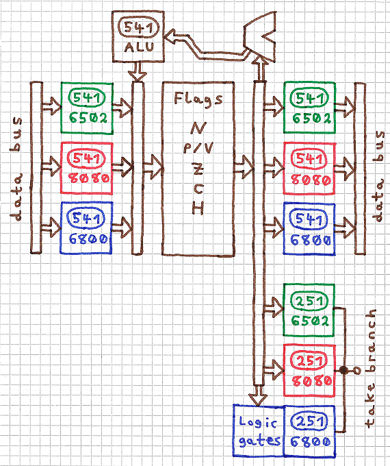

PostPosted: Sat Mar 23, 2019 11:37 am
Posts: 1431
It's not decided yet, if Drass is going to start another CPU project after finishing this one,
of course.
But just in case he goes for it, I would like to put a provoking thought to discussion here.
With K24, we have a mechanism for switching the instruction set (selecting a different microcode)
during run time... but it all is 6502 related.
What, if one would be trying to switch to a non_6502 related instruction set ?
I'm not talking about trying to be cycle or timing compatible to a non_6502 CPU,
it's just about the possibility of being able to run the legal instruction set of a non_6502 CPU.
Let's start with the 6800.
Simply because the design team that did the 6800 later had some 6502 relevance...
Unlike the 6502, 6800 is big endian (high Byte first).
Stack operations seem to be post_decrement and pre_increment, like with the 6502.
What happens during the interrupts still needs to be investigated.
Conditional branches are a little bit more sophisticated than with the 6502,
on the other hand there is no decimal mode: just DAA and a half carry flag.
To me, the rest of the 6800 instruction set looks somewhat trivial:
6800 would open a vector to implementing something like the 6809.

Now for a crude block diagram for the status register area of a hypothetical TTL CPU,
able to run 6502, 6800 and 8080 machine code.
We need an additional flag, the half carry flag.
Regarding the Z80, the V flag we know from the 6502 now also works as a parity flag.
//Parity checking could be done with a tree of XOR gates tied to the ALU output).
Basically, the "data bus connection" for the Bits of the status register just is "formatted"
by using buffers to fit to the CPU instruction set which currently is selected.
A crude (but more detailed) block diagram for handling the conditional branches,
which BTW does not include the 65C02 "test Bit and branch" instructions.
Maybe in a few years from now, maybe somebody picks up the concept and tinkers with it,
but for now I'm happy with having this stuff parked here. :)
